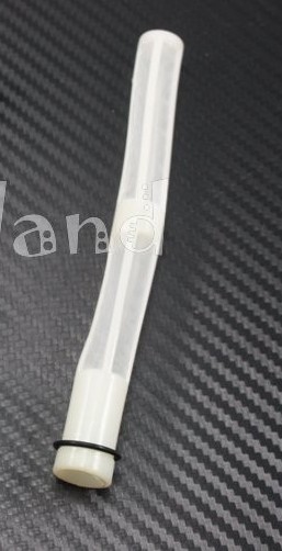

    Quote Originally Posted by dylanisaacs View Post
    ok guys ive pulled it off and took the bottom off but there is only part of the filter
    You mean this right..?? You'll be needing another..
    There is a secondary strainer in the bottom of the petcock..open it with a 10mm socket and clean in there too!
    And as 'tri again' mentioned..hit that tank interior with a pressure washer if you can. Then let it dry out really well..
