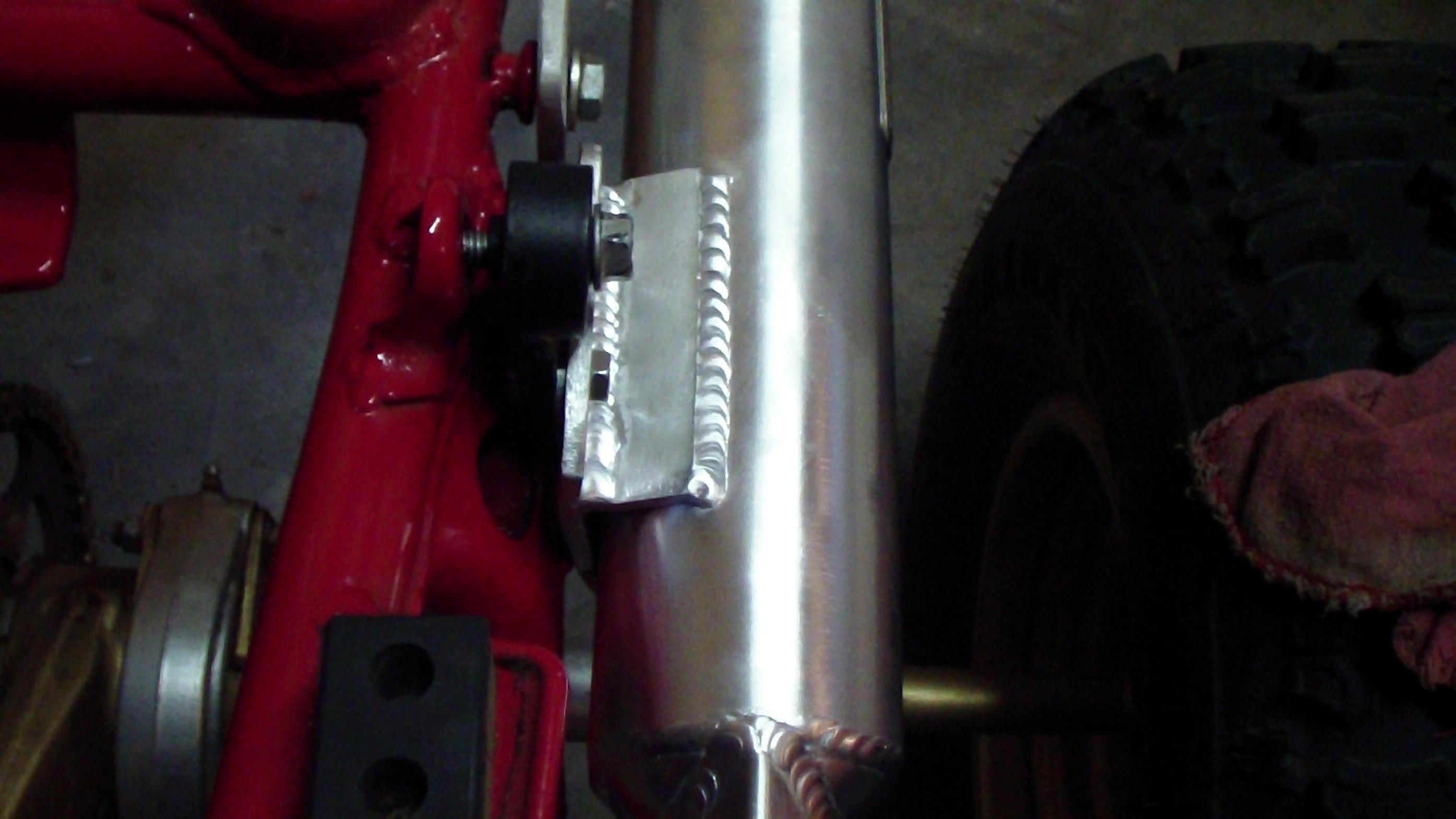

    hey just bought a brand new dg headpipe and silencer.tried putting
    it on last night and have some fitment problems,first the headpipe frame bracket
    hits the front fender,this is a nice bike not crashed or beat with new fenders.
    anyway headpipe springs don't fit too long now,and silencer with use of the
    stock mounts hitting the frame the mount can even be tight to the frame.
    anyone else have this pipe or problem.lmk thanks!
ID:	169749Click image for larger version.
ID:	169750Click image for larger version.
ID:	169747Click image for larger version.
ID:	169748these are the picsClick image for larger version.

    Mine came on my 84 and it had great clearance, pipe didnt touch the frame anywhere and the mounts held it fine. My DG was black though, and it did come close the tank fender but didnt touch. Hopefully someone who has put one of these on new can chime in
    Nice 250r btw
    Carthage NY 250r rules
    2,355
    Iv never installed a new one.But Iv heard of guys putting them on and having fitment issues.You will have to get new springs and trim the front bracket so it clears the fender and shin the silencer for clearance.

    thanks for the imput.ill shim and trim
    it to fit.
    just put a new pj34 on it so hopefully
    that and the pipe will wake it up.
