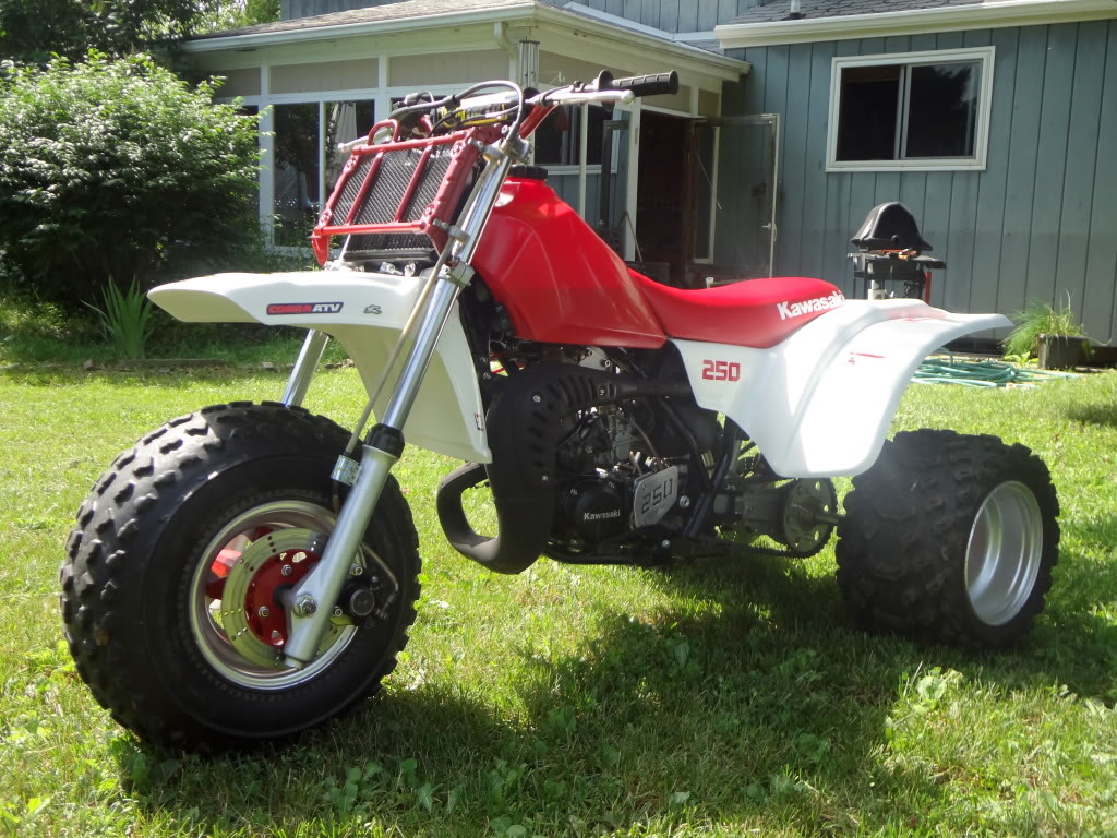

    Here's some pics of mine,,It's ok but it's not my R!!!Click image for larger version.
ID:	169948Click image for larger version.
ID:	169949Click image for larger version.

    Very nice t3, i like the colors!
