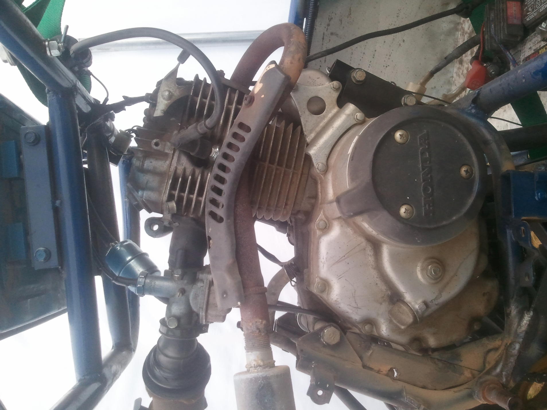

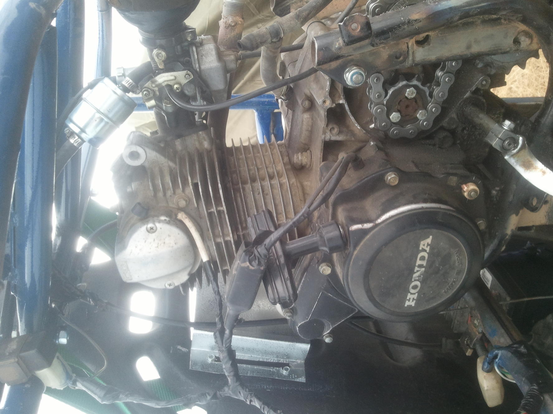

    So here are some picture of the engine and the buggy it self also to shift indicator as you can see it goes all the way up to fifth gear while it is NOT running. Should i go looking for a reason why it wont do it while its running?
