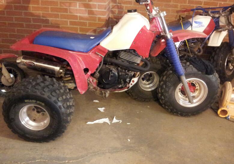

    recently traded a nice 82 110 for a 85 350x that was in boxes.i had a rolling chassis and the motor,brakes and a few other things where in boxes.so i get this thing mostly back together besides rear brakes and take it for a spin.when i got back i noticed the rear bearings where a little loose so i proceed to yank the rear axle when i see that someone as welded the hubs onto the axle on both sides.after burning up two grind wheels i said he heck with it and cut them off.i couldnt find a axle on ebay for a reasonable price so i bought a 250x rolling chassis sight unseen and had it delivered to my house while i was at work.couldnt wait to get home and yank that axle and to my suprise both hubs are welded on both sides.after striping all the rhino lliner off the plastic and forks on the the 350 that the PO thought was cool i thought i was in the clear until i ran across this welded mess of axles i had to work with.finally got me a good used axleand got it back together.please someone respond and tell me im not the only one whos ran across this stupidity.

    Nice 350x I think you got a good deal for it, even after buying a axle. If you go on Craigslist their are so many people that weld their hubs to the axle, it kind of ticks me off because of them are pretty nice but they screwed em up anyway I really like your 350x I always wanted one but their are priced ridiculously aroun here. Post up some more pics of this bad boy

    yeah i guess some people think axle bearings are good forever.it just sucked because i can assure you of one thing.those axles are very very very strong.try tocut one in half even at the smallest point and youll see.i hate destroying good parts knowing that one day i could use it.i have more pics in my album to check out.my auto x is my cleanest bike that i have rightnow.i fix them up when i have the extra cash but i dont have to have the prettiest bike in town. as long as mine run and brakes work im good.
