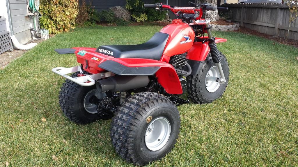

    Very nice build, bro! What boots are those? I'm liking their look!
    Jul 2005
    N/A
    5,818
    sorta look like the ones i sell lol.
    Feb 2013
    Senoia, Ga
    635
    Quote Originally Posted by the great gazoo View Post
    Thanks man! Ebay, here are the ones I bought.
    http://www.ebay.com/itm/Honda-ATC-25...#ht_1216wt_916
    Could be!?

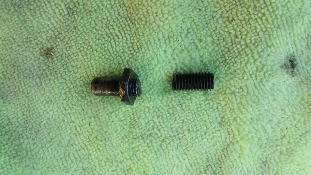

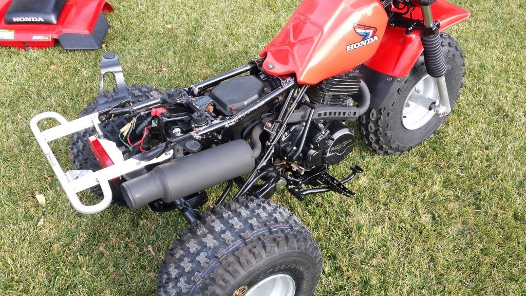

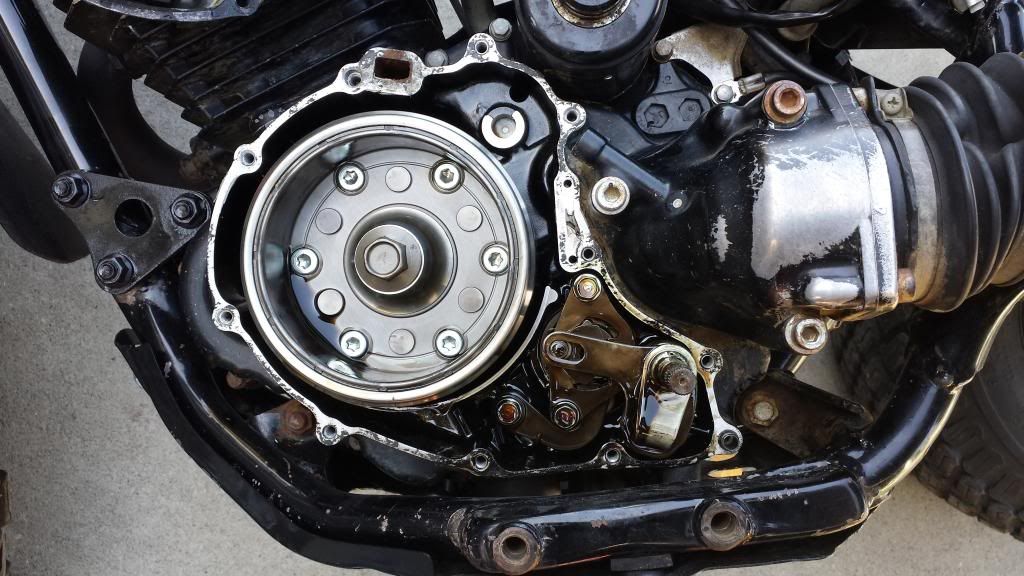

    I still need a few things on my SX before I can declare the build done, but I stole the rear wheels and tires off my other SX so I could take a shake down spin on her up and down the street last week. After a couple of passes, I realized that the shifter would not return, when I downshifted from 3rd to 2nd.
    I had read some posts about the shifter return pin either backing out, or backing out and breaking off.
    I figured that that must be my problem, so I ordered up the new pin and case gasket.
    Here is what I found..
    Luckily, I was able to get the broken piece out of the case, and replace it with the new one.
    After getting everything put back together, I took her for another spin, and she shifts like new.
    I have no idea how long it may have been broken, but am sure glad no other damage was done.

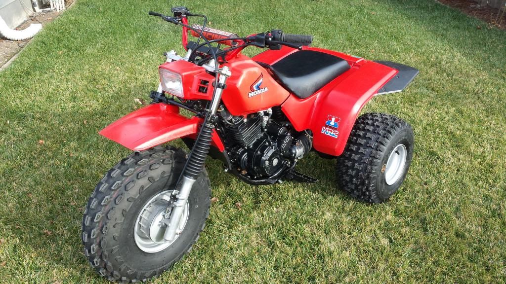

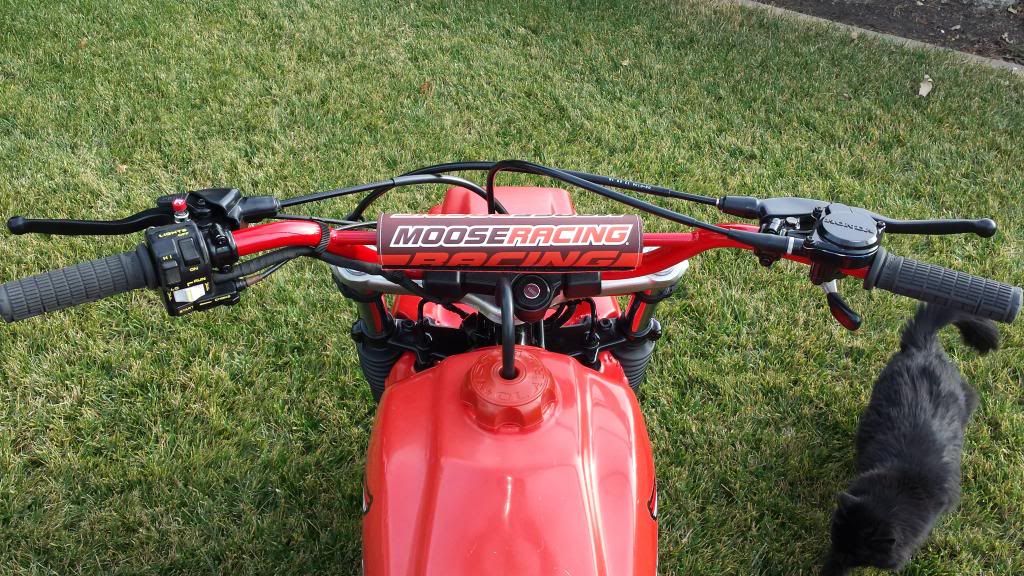

    So, it's been a while, and I though I should post up an update. Here is pretty much the finished product. Now, I did cheat and steal the rear fenders off my other SX for the pics, because I have been looking for some nice rear OE fenders, for months, but can't seem to find any. (I know that they are hard as hell to find, but it was worth a shot.) Anyhoo, I am gunna just have to bite the bullet and order up some Maiers. Here are the pics.....
