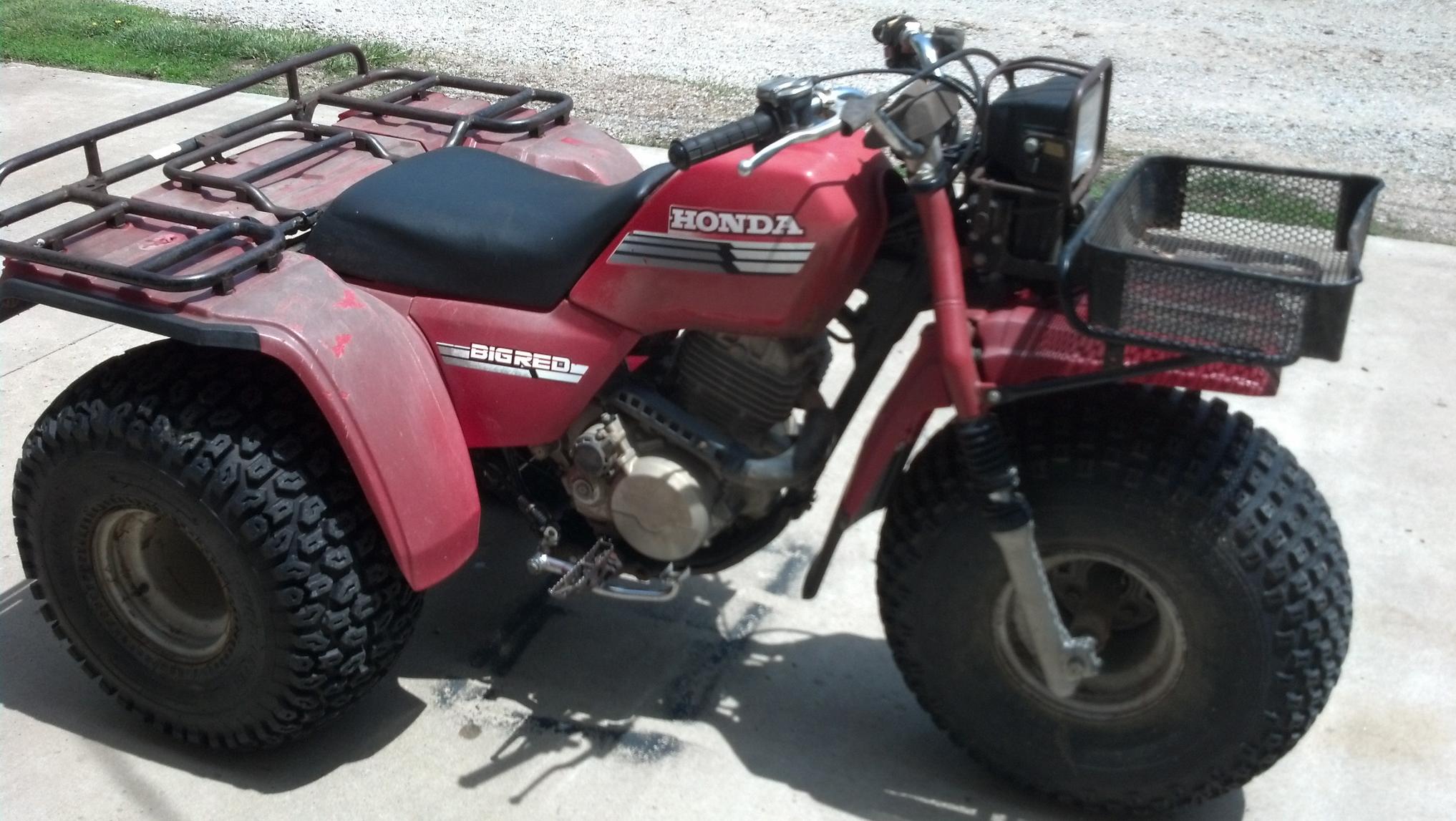

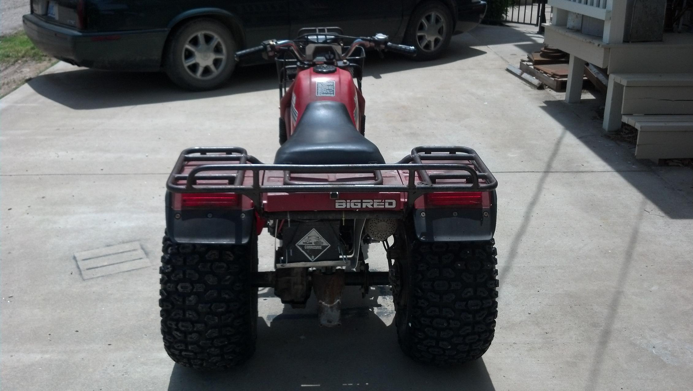

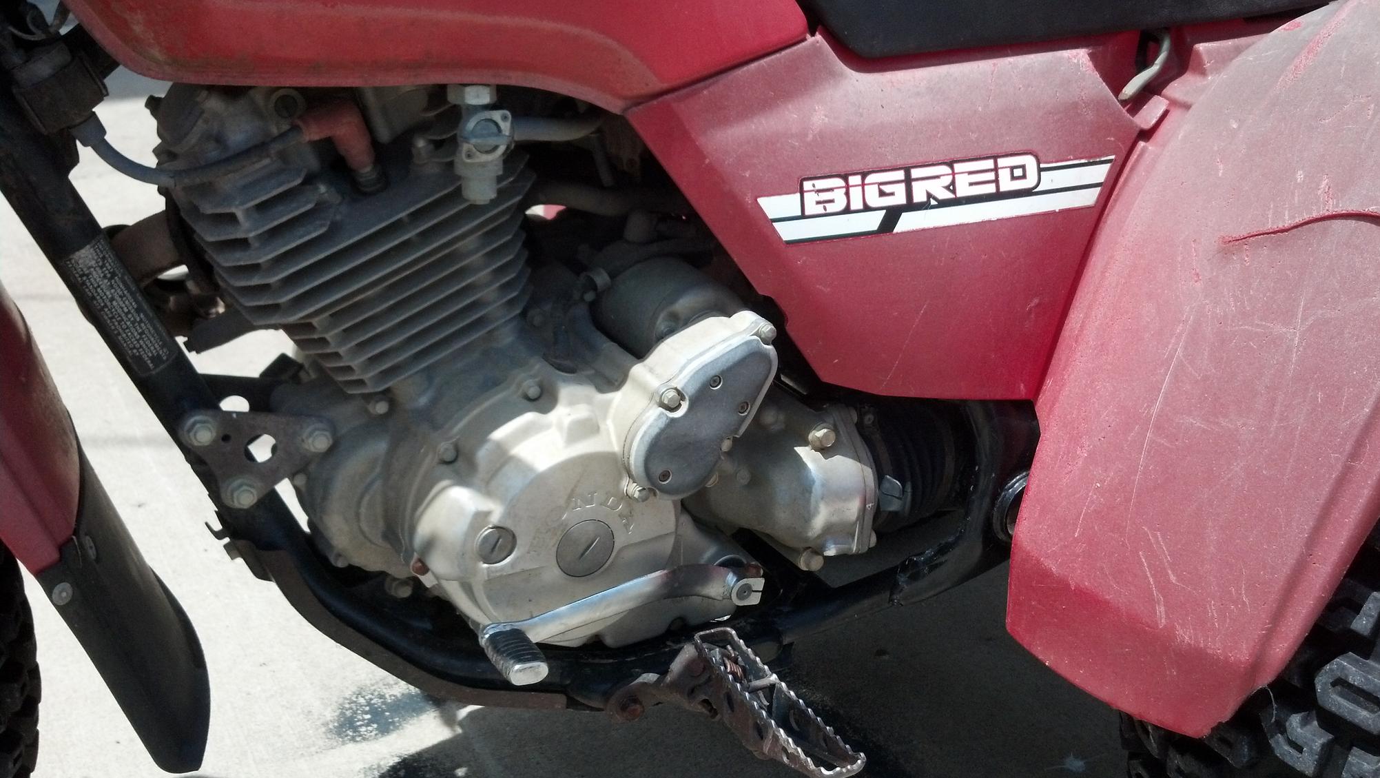

    I pulled the plug that was in it already and it was kinda black at the base of the white insulator under where the spark is made. Everything below the top seemed kinda just black and sooty. It was running about 55 MPH on gravel roads yesterday though. I honestly just want to get this atv running good enough to sell. Click image for larger version.

    Would anyone be willing to review the pictures I uploaded and offer what they think it is worth? I'd really appreciate it.
    Dec 2012
    812
    Too bad she spent so much time in the sun...Did a number to that plastic.

    Yeah, it's faded pretty bad... My grandpa didn't shed her until he was done with her around 20 years ago and he bought her new in 1987

    Someone went all McGyver on the trunk/battery holder and exhaust too..
    Such a shame!!
