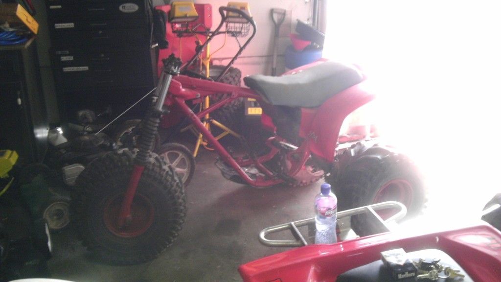

    Well I picked this up the other day, http://grandrapids.craigslist.org/mcy/3804829839.html

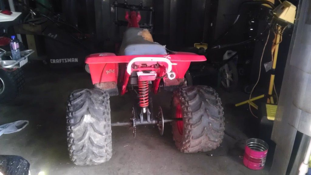

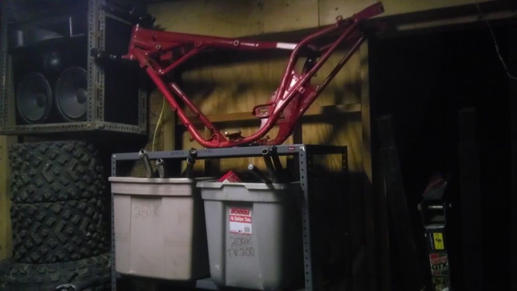

    Flipped the swinger back around and got it sitting right, then tore it apart Gonna go through it fully and clean/powder coat/replate everything. My goal is to have it near mint, but it will never be mint because I have every intention of riding the piss out of it. Well on to pictures
    And how it sits for now, until my schedule stabilizes with having a child. So I will definitely be able to take my time with it and really let my efforts show.
    Going to redo everything the correct colors, 300ex or tusk hubs to run aluminum wheels, and other bits. Not really planned out yet because I know little of what can be done with these. So I have some questions..
