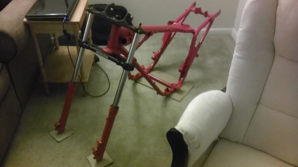

    Well I jumped on it sooner than expected, got the frame and forks back. It was spray painted some nasty brownish red. All fixed now. Still gotta fix the nut on the stem, looks ned also
    My wife is not thrilled about it in the living room Now for little things, I am getting all new hardware for it (not the eBay kits, piecing it together myself), polishing some bits, and finishing the swinger, axle, and rear shock. Unless I get a good deal on an extended swing arm, then stock it will be.
    And now that I look at it, I see I put the forks on the wrong sides and backwards
