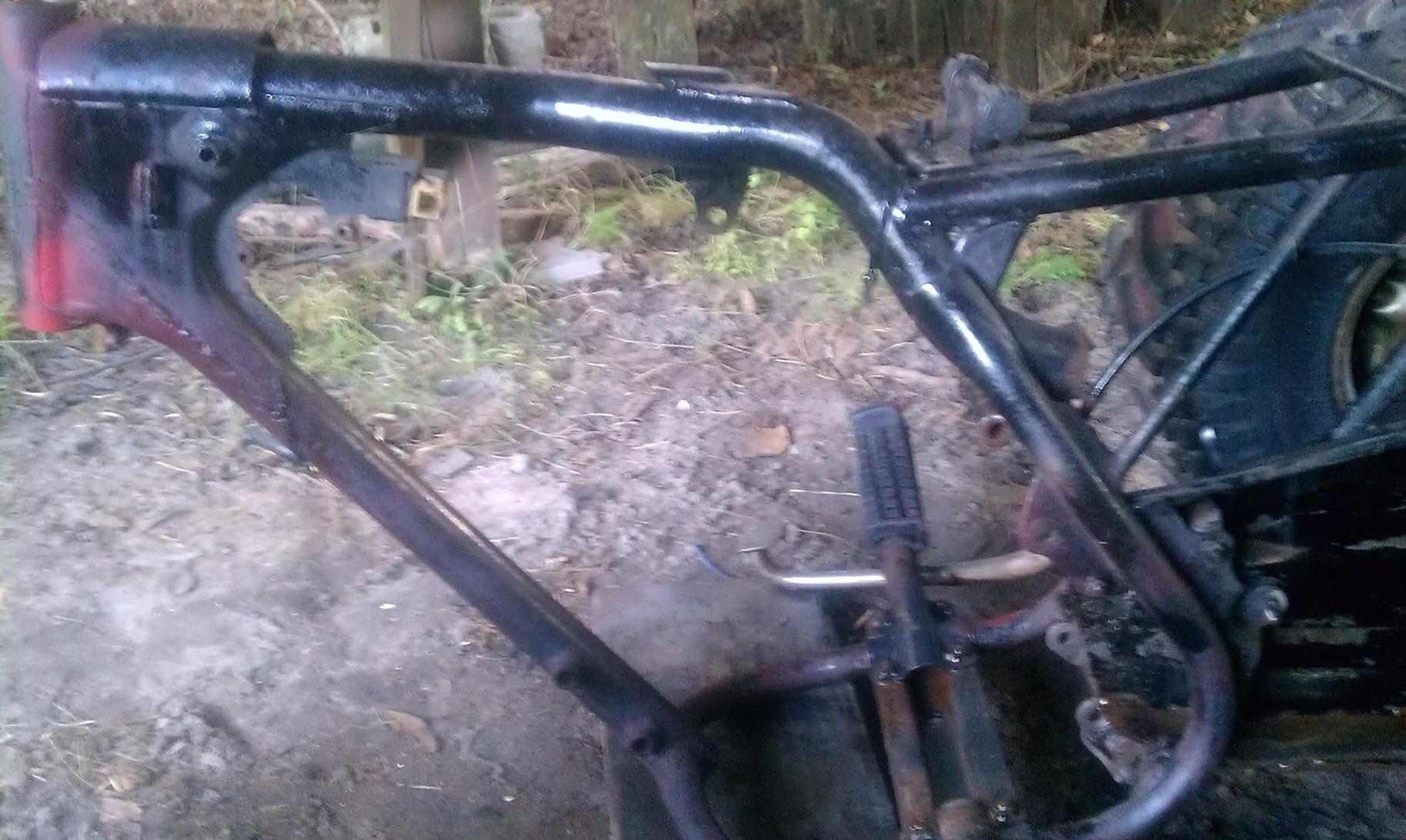

    Frame Stripped

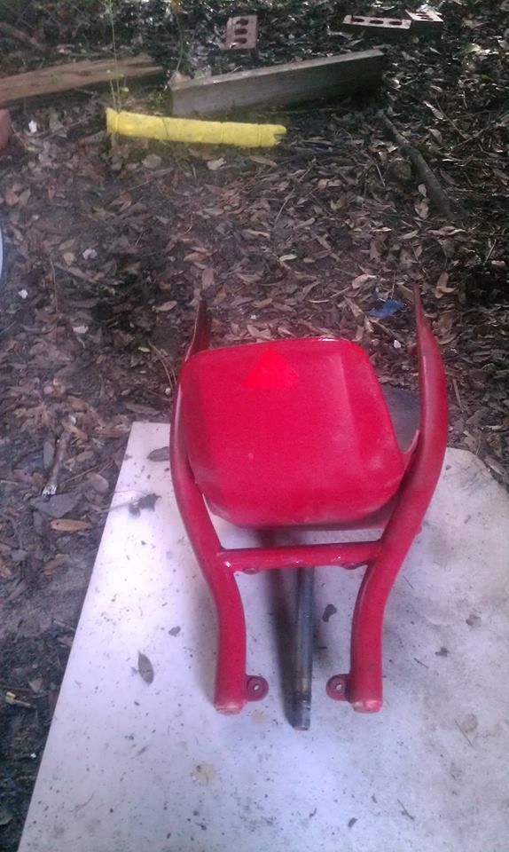

    Rear Plastic / Seat

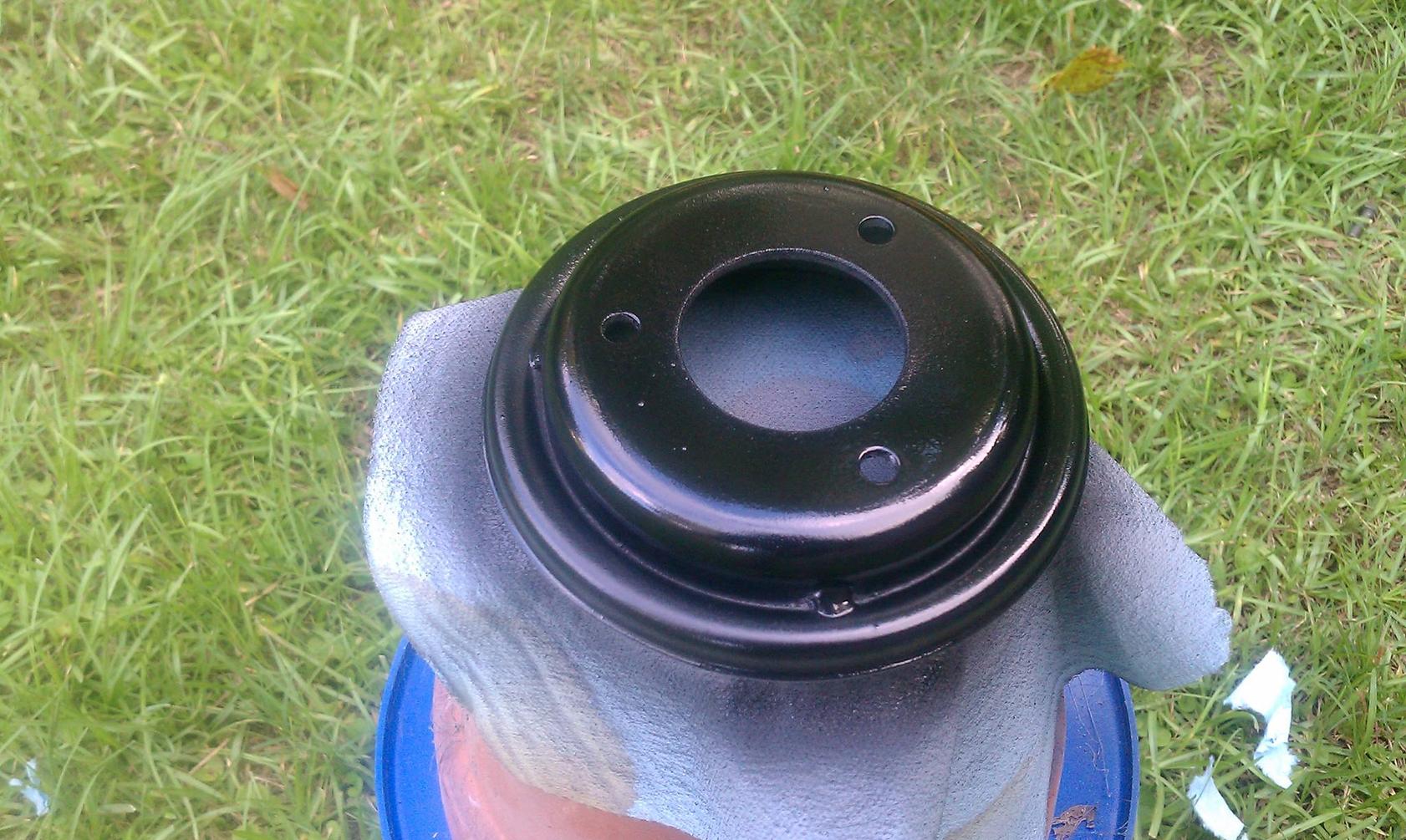

    Front Forks

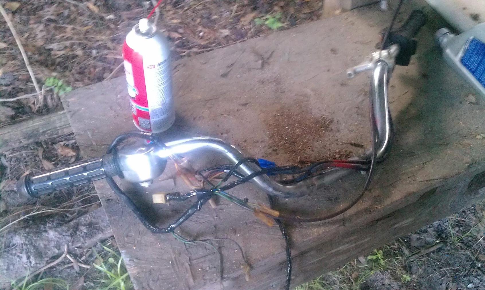

    Handle Bars and Wiring Harness (re-wrapped and leads put on)

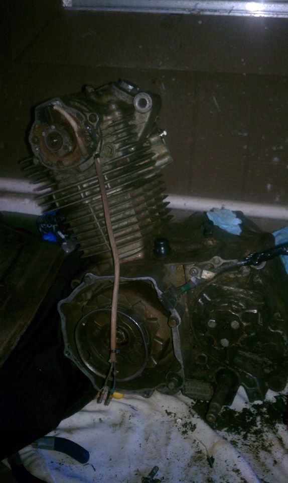

    Engine before/after re-wrapping wiring and putting leads on
ID:	171307 Click image for larger version.

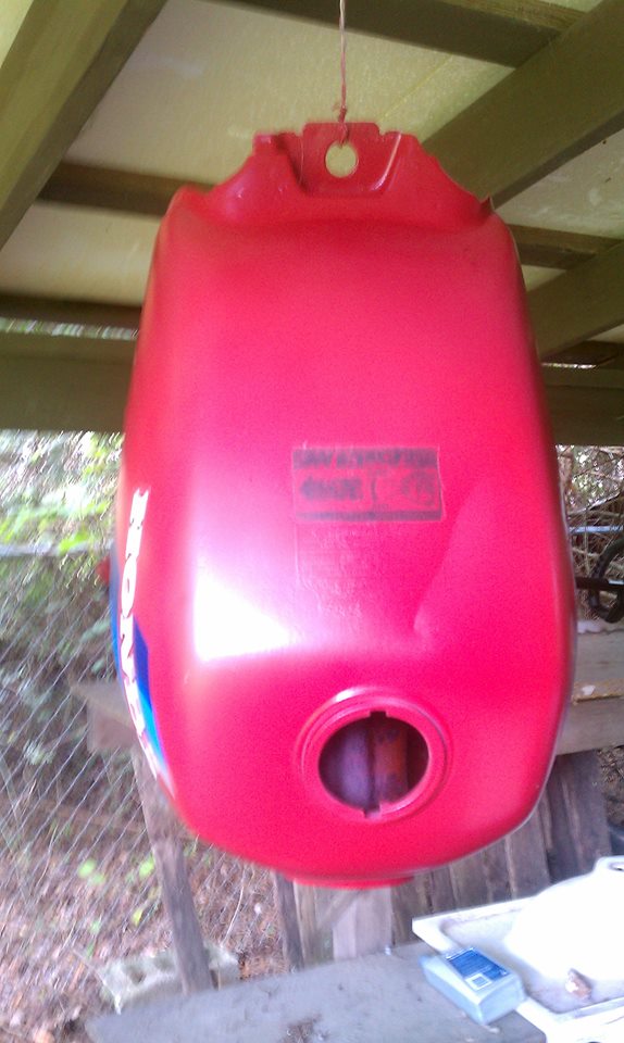

    Tank photos after painting
ID:	171310 Click image for larger version.
ID:	171312 Click image for larger version.
ID:	171314 Click image for larger version.

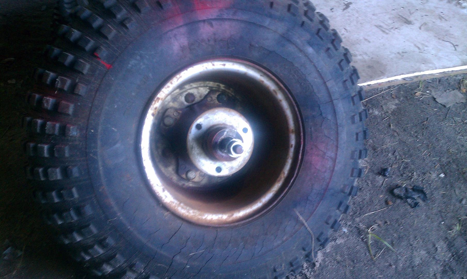

    Front wheel with Brake Hub removed

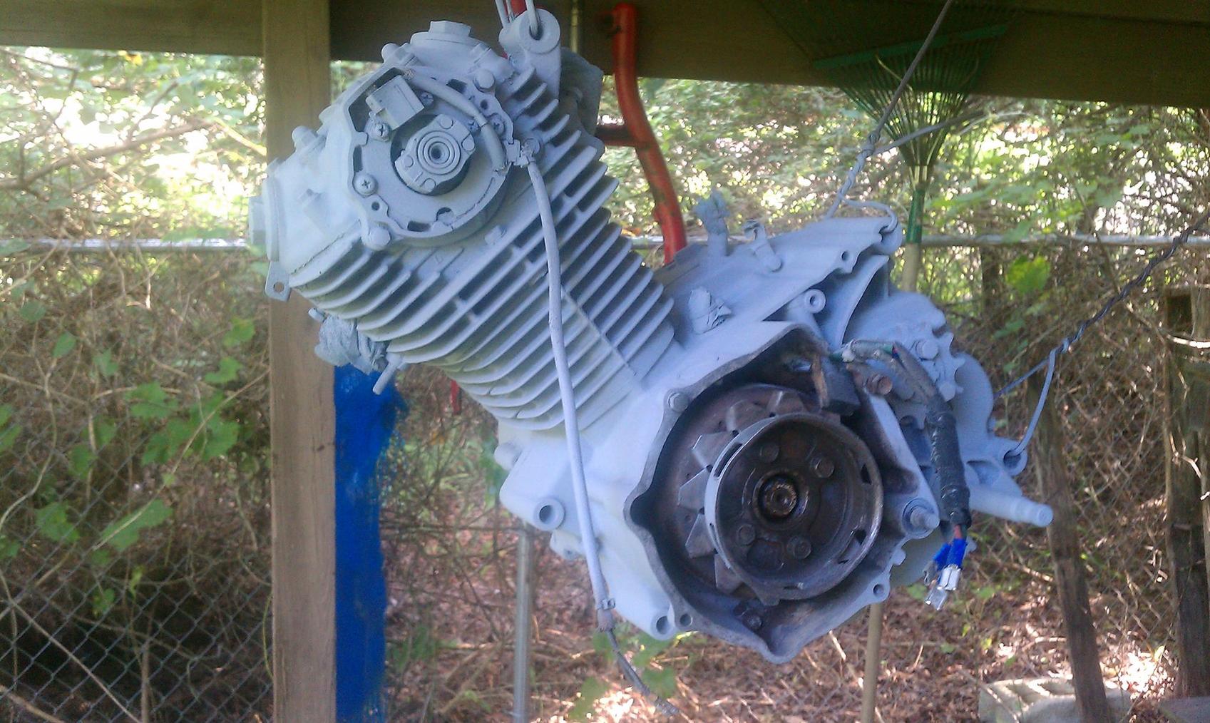

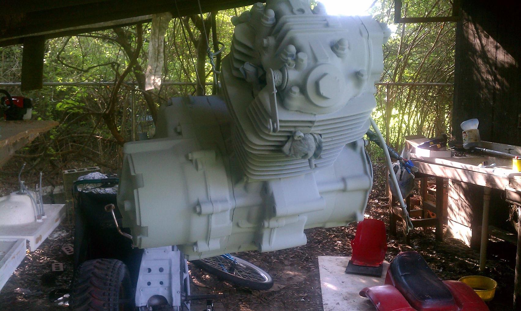

    Engine de-greased and Primed.
ID:	171393 Click image for larger version.
ID:	171395 Click image for larger version.

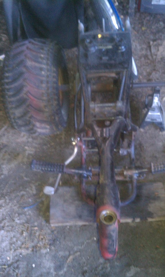

    Started on repainting frame after de-greasing the frame (quite the job)

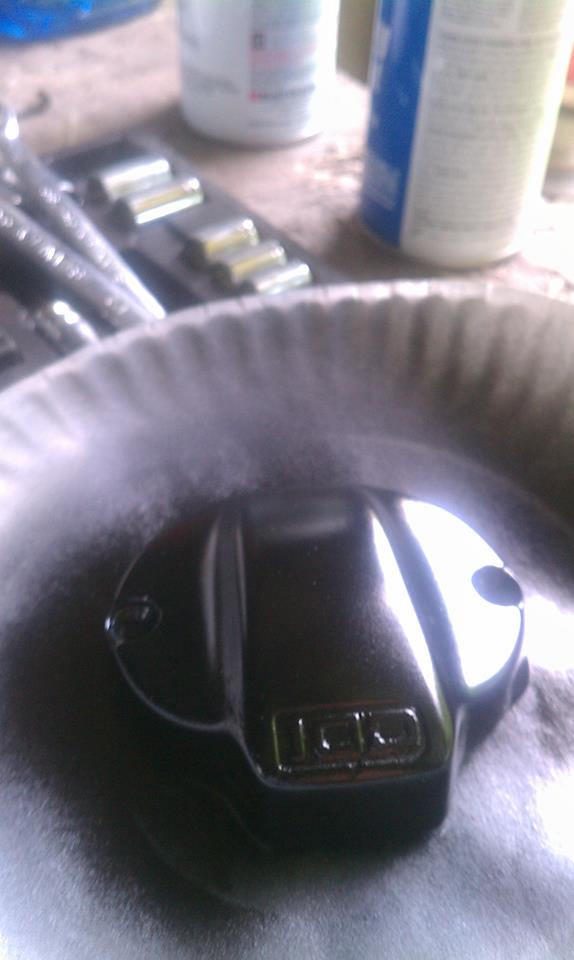

    Painted CDI cover

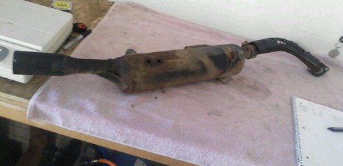

    Also I won the bid on my exhaust, $0.99 + $24.25 shipping = Happy Camper Pic below.
