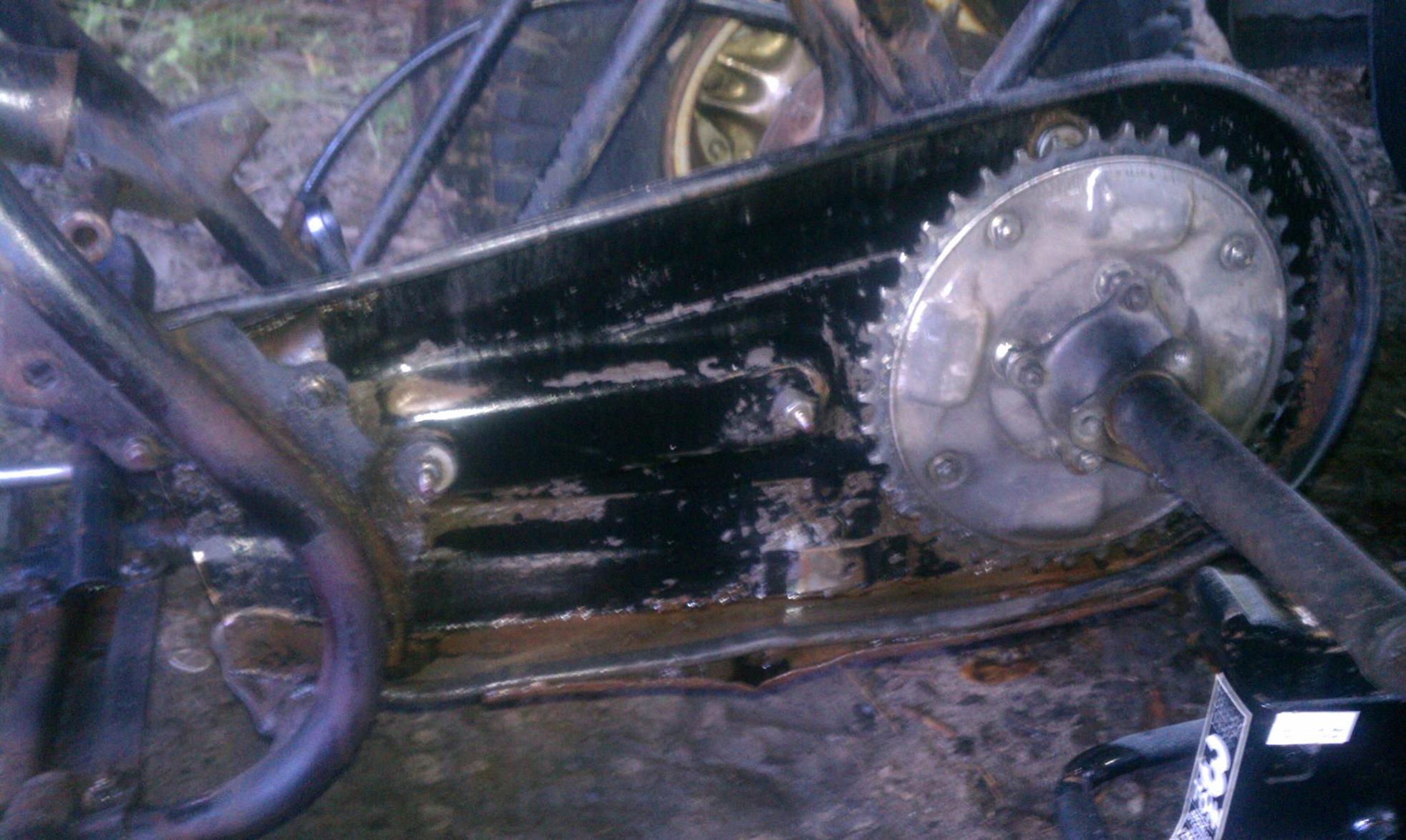

    Frame Stripped

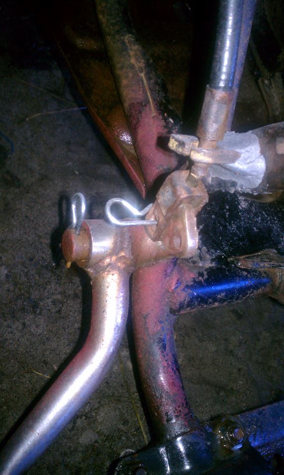

    Brake (missing Spring) had to get some Quicksteel to repair after I bent it back.

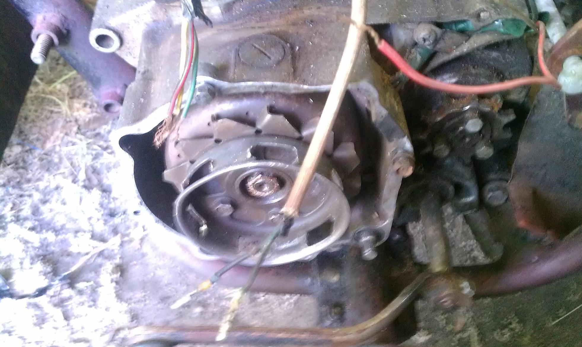

    Engine before/after re-wrapping wiring and putting leads on
ID:	171307 Click image for larger version.

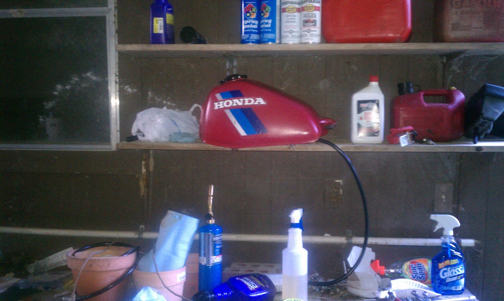

    Work Bench lined up

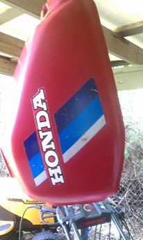

    Tank photos after painting
ID:	171310 Click image for larger version.

    I would replace that oil cap, you mean the dipstick or? A small leak will become a big leak eventually. And you don't want oil leaking all over your freshly painted engine and frame. Speaking of paint, be careful on the spark advancer i see you painted over it and the pickup, if you get paint buildup on the magnet end of the advancer it will hit the pickup coil, small gap between them.

    Any thoughts on my mounting rig lol

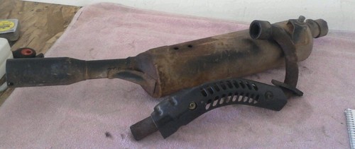

    Also I won the bid on my exhaust, $0.99 + $24.25 shipping = Happy Camper Pic below.
