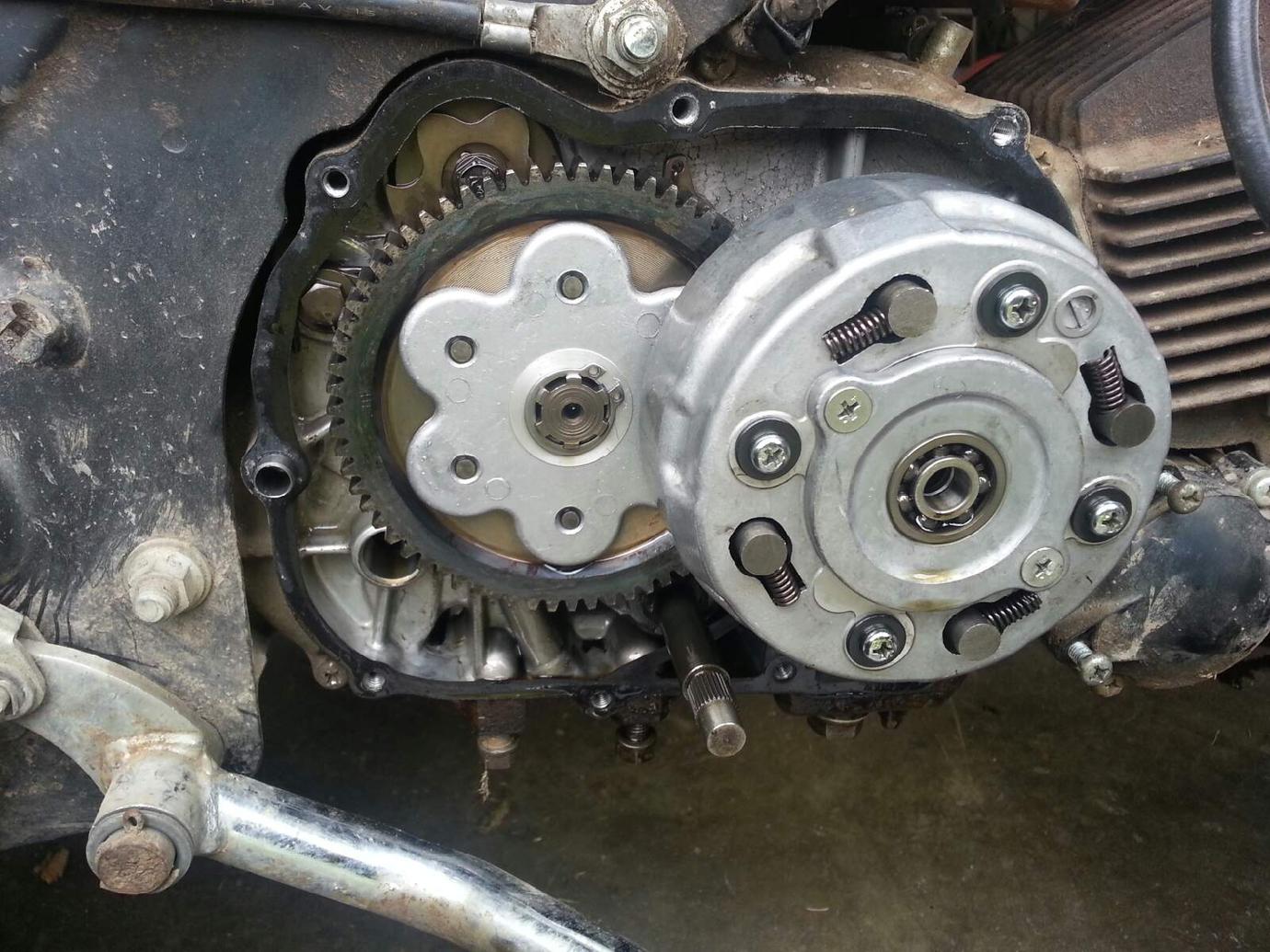

    the part i was thinking of that looked fin to me was infront of the gears i didnt even need to take the gears off to get to it. the part in the picture is behind the gears so ill have to take those gears off some how to get to the stopper
ID:	171723This is the part i thought was the shift drum stopper but it looks fine it is right in front of all the gears

    MN
    3,263
    I can tell you right now your stopper is broke... In your second picture the hook of the spring is on the top of the stopper arm, it should be underneath it providing upward tension, so it broke and the spring came off!
    The part you thought was the stopper is part of the shifter assembly, no pin on that other part.
    As i described in my other reply to you, you need to remove the clutch assembly, see that cover with the bearing in the center and the two philips screws? Remove that, under that there is a nut, you need the special socket to remove it, remove that nut and the entire clutch assembly comes off. Then the left gear thats over the stopper you just need to remove the snap ring holding it on the shaft, then pull the gear off.
