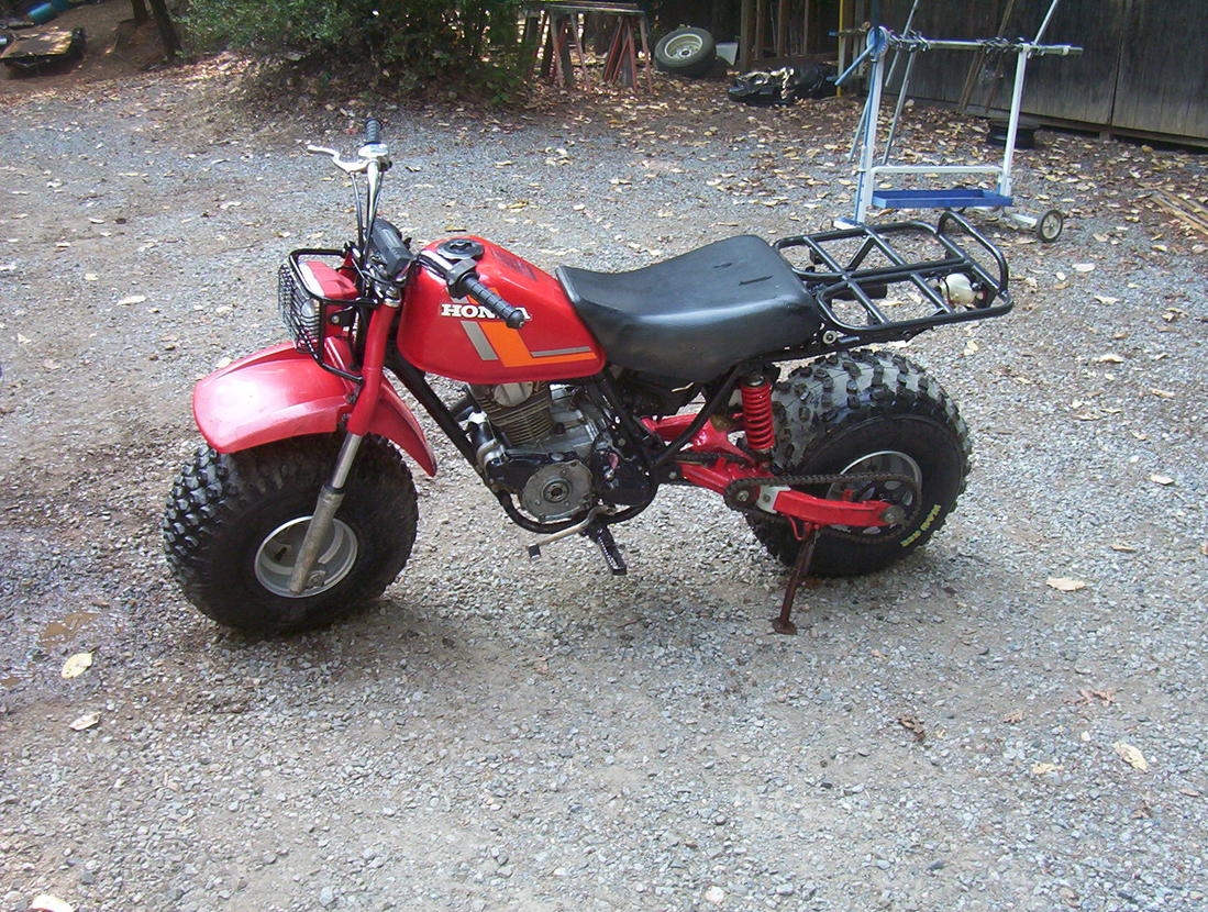

    A few more pics.....it's a roller now!
    I finally got some more parts and some time to work on the 2 wheeler again, new kenda rear tire, new sprocket and chain, front brake shoes and wheel bearings. I had it running today for a couple minutes, just with a gas squirt bottle, it sounding pretty good! Just have to coat the tank and get a battery and some fenders, paint the rear rack, and some other misc. odds and ends. I'm excited to give it a test ride...I'll post more pics as it progresses.

    And a couple more pics..
    Well I'm getting close to done now, just waiting on a rear fender, I actually took it for a spin today, borrowed the seat and battery from my 200es, I love it! The gearing is a bit taller than the original big red, but actually a perfect ratio for the 2 wheeler. Steering is not bad, I put a little extra air in the front tire and that seems to help. This thing will climb hills like crazy, feels real stable, with the wheel way out behind, as it is nearly 6 inches longer than the original 3 wheeler. Overall a real blast to ride! Thanks kb0nly for the vinegar trick, it did the job!

    If you decide you want a little better handling/ narrower stiffer, front tire, more front travel, and more front height a 200x front end will help.
    Here is a thread with how someone else did it.
    Cut the stock pin and welded it onto the 200x triples.
    http://www.3wheeler.org/vb/showthrea...ree-on-the-110

    Very nice build! any updates to report on. I have a Big wheel swing arm in the garage and when I layed it under my 200M I didn't think it would line up on the drive sprocket and still keep the wheel centered. I see now the wheel sits offset in the swing arm, so it looks like everything lined up for you. Nice job, how is the front chain working out?
