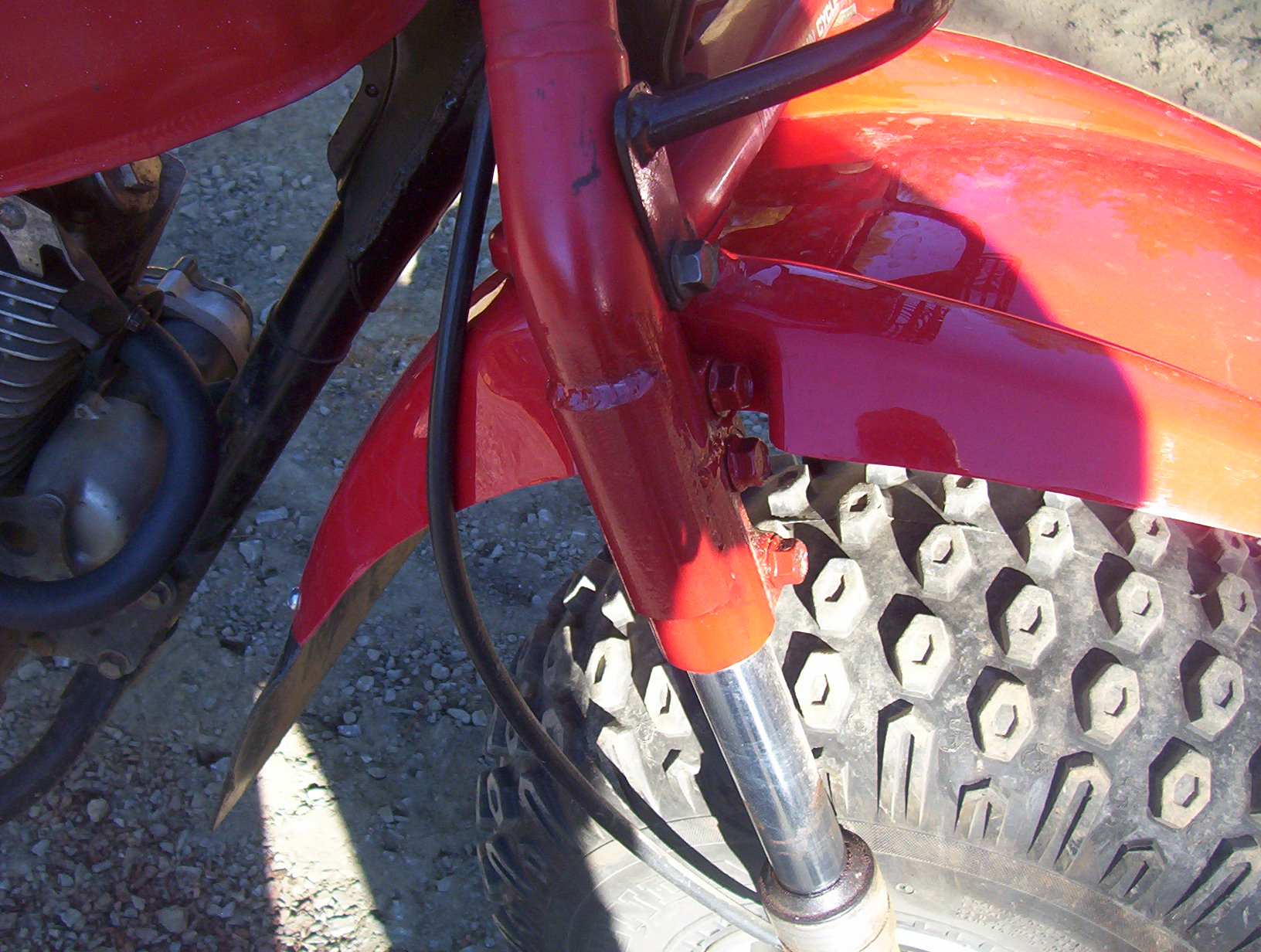

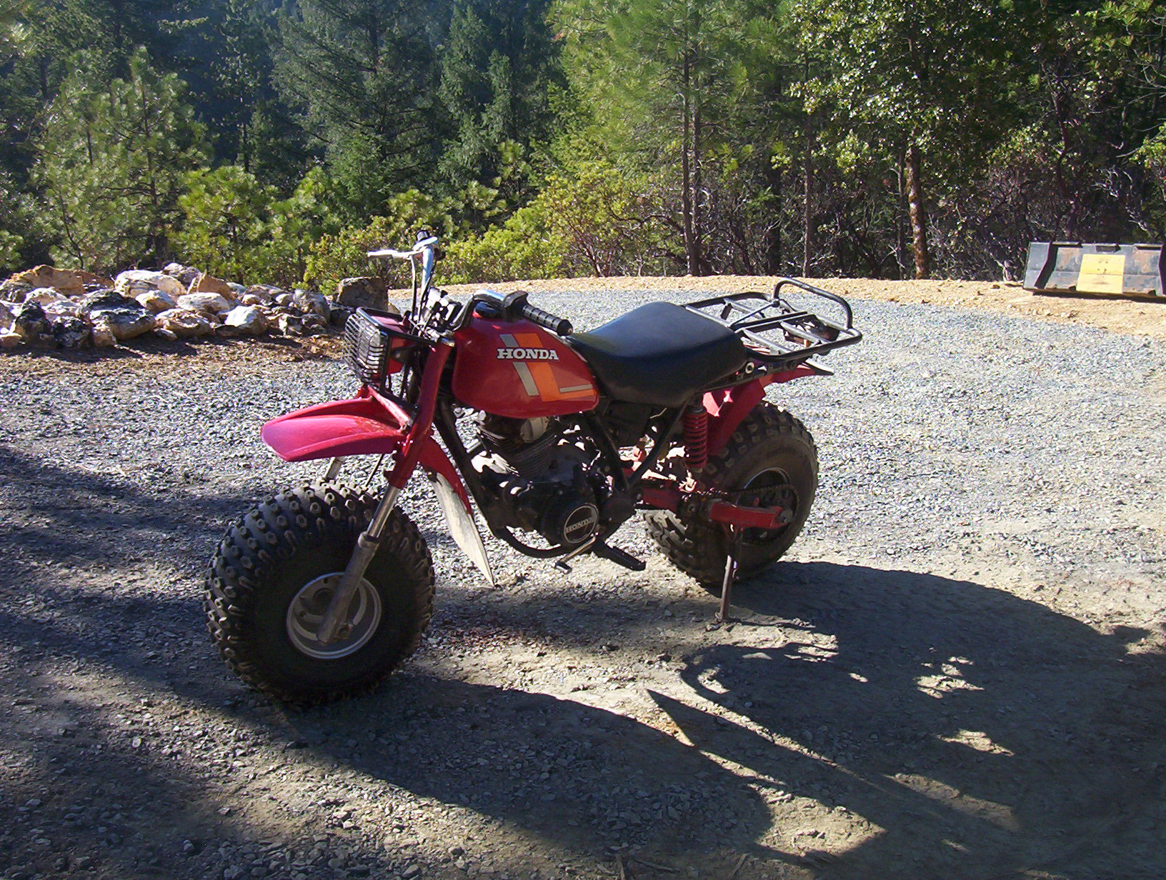

    Hey wow, thanks for all the comments, I haven't been on here in a while, here's a couple pics of the finished product except for fork boots and side panels...if any one has a really crappy pair of 200e es or m rear fenders that I can cut the side panel part out of let me know. I need basically the triangle and the plastic along the underside of the seat only. I'd never cut up a nice fender! I ended up lengthening the front forks about 3 inches to get the front up, handles way better now. If you check out the pics, I just added the bottom clamp part from a bent pair of forks that I had sitting around the shop. The 2 wheeler has plenty of power in high range, I barely have used low at all. One other mod I think I may do is to narrow the footpegs down a bit, because this thing is way wide, and if you have to put a foot down in a hurry, you'd be likely to get it sucked under!

    Frontend extension looks great! Dang man I love that bike!
    It looks really functional, most conversions do not.

    The front chain is working fine so far, the trick was starting it out initially with almost too much tension so it would stretch to the right length, also I tried to use a good quality chain so the stretching is minimal.
