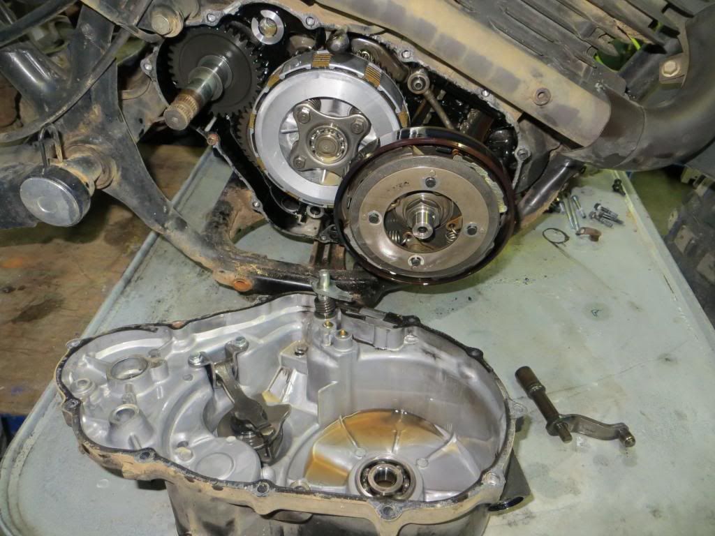

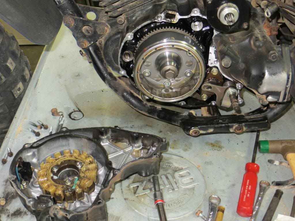

    Thanks for the advice NB, I appreciate it. Last night I popped the cases off to have a look and it wasn't that bad. Just the oil filter cavity and the starter gear cavity were filled with the sh*t so I assumed the rest of the engine was likely in the same shape. It could have been, I'll never know for sure but suspect my repeated engine flushes had some effect.
