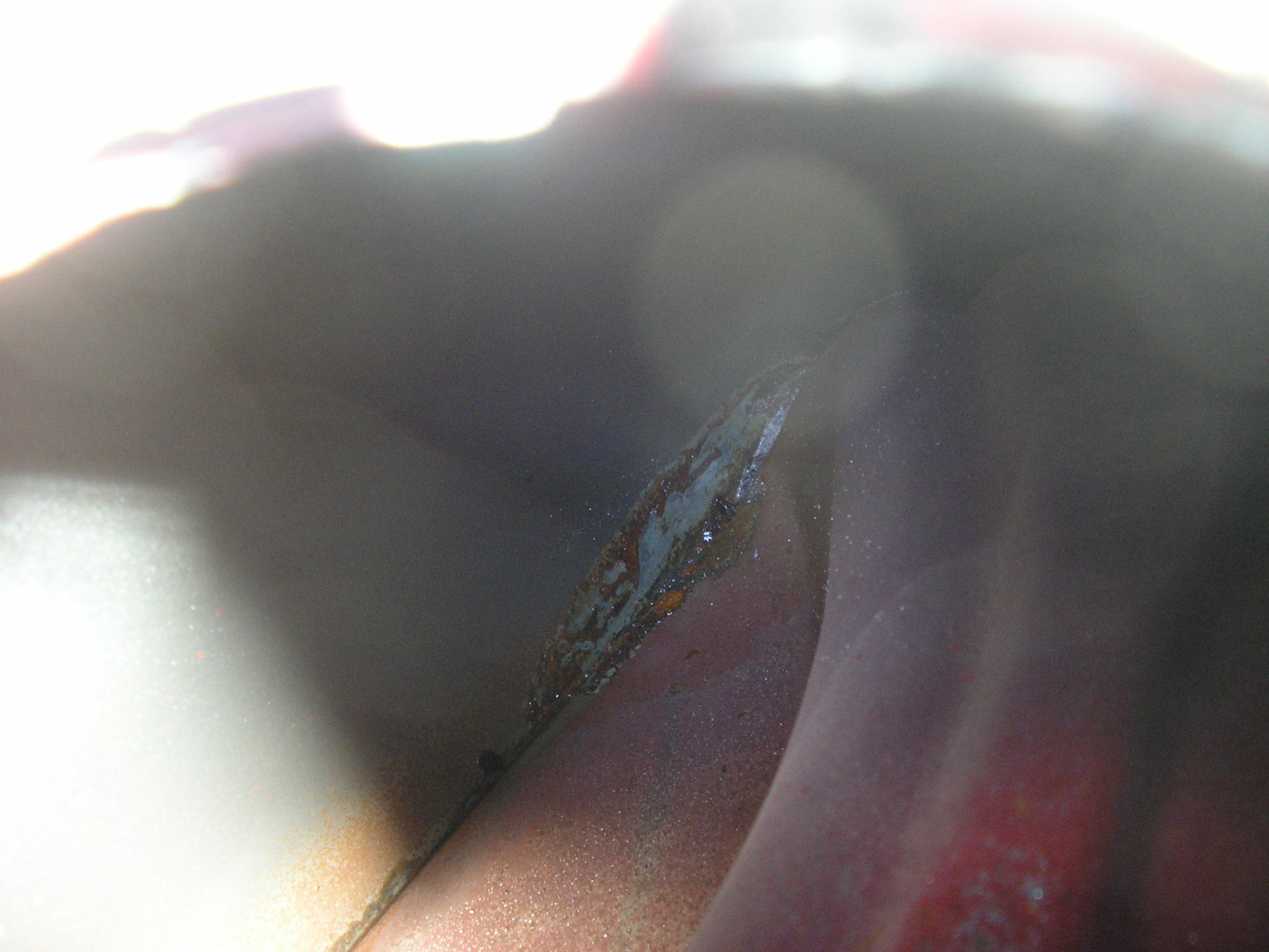

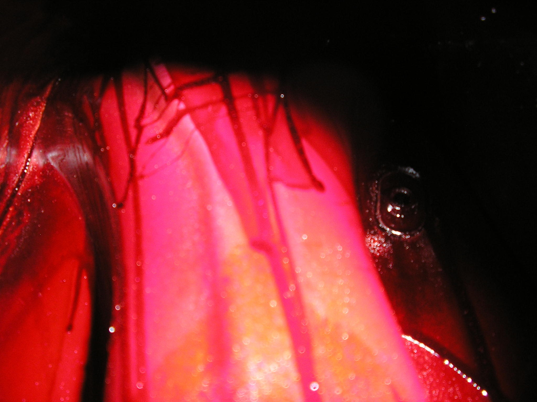

    hey guys, i have been looking at some of the older threads on gas tank resto and its got me wondering if my original tank is salvageable. i put fuel in it to see if it did hold and it did. so i decided to paint it. but as time went on it kept popping pin holes in it and i kept patching it up with JB weld... (face palm) well any way, i hope u guys can help me. here are my questions. is the tank still usable or is time to condemn it and get plastic. if it can be repaired what can do to clean it? and what can i do to reseal it. thanks in advance for all the help guys.
    here are some pics of the tank in the condition it is in now.

    I prefer metal tanks to plastic.
    Pretty rough shape!
    I would sand blast it.
    Seal the big holes.
    Do an epoxy sealer inside.
    Many have had bad luck with them, but if you clean it as the directions say, and follow directions you can get a very good seal.
    Paint it with linex bed liner.
    Linex will not bubble if you do get a hole.
    Extra exterior seal.
    Paint over that to desired color and enjoy for 20 Years.

    I had a atc70 tank that had ton of pin holes in it. I sent the tank to a local radiator shop. For 50 bucks they sand blasted the inside and sealed the tank with something called red coat. I got it back and it was done to perfection. Hasn't leaked in 10 years.

    I had a bad tank, (Johnson motorsports). Got me some stuff called, Kreem fuel tank liner, its worked for two years now. I used Muriatic Acid to clean it, then sealed it
    Jun 2012
    Arizona
    71
    To clean the inside vinegar and muratic acid work great.
    Both eat aluminum.
    Make sure to remove the petcock and seal the hole with a cork ect.
    I put drywall screws in the tank and shake to knock all the grime off.
    Count them prior to make sure you get them all back.
    Tool mag pickups can pull them out.
    Marbles maybe hard to get out.
    The muratic takes only an hour or less.
    Put it in, shake and keep rolling it about.
    Wear a mask and stay upwind. Fumes are awful.
    Make sure to flush it many times after to get all the acid off.
    The vinegar takes time. 1-2 days. That is how I found out about the petcock.
    Let my tank sit for 2 days. Came back and it was empty and my concrete had a dark stain.
    Ate my valve into 2 pieces.
    The radiator shop has dip tanks that will take the tank to bare metal and remove the rust.
    They can also braze up the holes and reinforce the seams.
    As far as the coating, there are at least 8 brands you can use.
    If you do it read the directions several times and follow them.
    If you have it done let the shop do whatever they recommend if they have used it before.
    Takes some practice with some of the products.
    Tank needs to be clean and the directions strictly followed.
    Have seen many with botched redkote.
    Usually from not letting them dry properly or using opened kit that sat around for several years between kits.

    thanks everyone again for the fast replies. =) i think i will go to the shop and get a price check. i think its time to leave it to the pros if i can. cause by the way my pics look, my methods just are not working for it.

    update, =) hay guys. i finally got some dollars scrape together and found a radiator shop who still does gas tanks. and the end results are great so far. not a single leak they even sordered the outside too. here are the after pics. what do u think?
