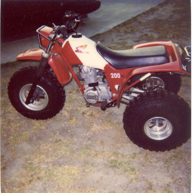

    Built one for my first wife, 185s engine, worked will....
