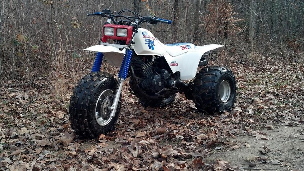

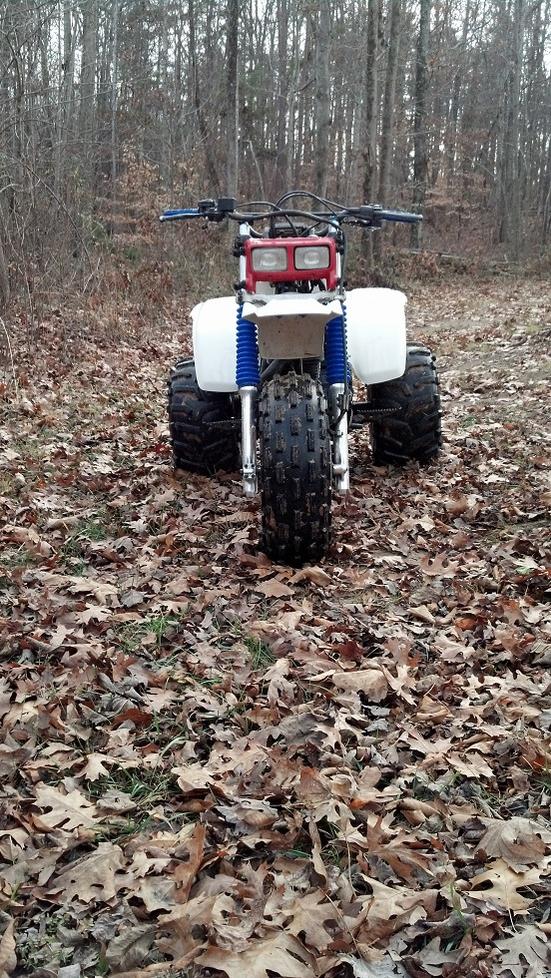

    My opinion, the #1 best improvement to this already near perfect machine is the selection of tires and rims that are available now that didn't exist 25 years ago..
    Besides a more complex and expensive front end swap as FlyingW has suggest, not that isn't a cool change up, but simpler enhance is a rim/tire change up..particularly on the front.
    I have done this with all me ES/SX machines and the change in handling is great.
    Here's a pic of my latest..The details for this improvement are available for the asking. No mechanical alterations required..just a bolt on replacement rim/tire and Shazam! A great new look and tremendous handling improvement..

    I have an 86 sx with completely stock motor & stock airbox w/ no holes.. the only thing I did was to put a 350x front end on it & she's a beast... 3rd place in the mid-size mx at trikefest this year then crossed the river & back again without missing a beat!!!! she'll pull a nice wheelie in 3rd (2nd according to Honda)... IMO its the best 3 wheeler I've ever owned....

    Quote Originally Posted by neverdone View Post
    So what all is involved in the front tire swap? I would really like to do that. I did order new shock boots for the front, order some decals, and I built a new grab bar a Monday. Going give the old girl a good cleaning when I get back from my trip then will post up some pics of it.
    The front wheel change up is a breeze..
    Got this from Rocky Mountain ATV online for less than $120 shipped..
    Kenda Bear Claw ATV Tire 23x7-10
    Part # 1054490005
    4/110 ITP Steel Wheel 10x5 2.0 + 3.0 - 1990 Honda TRX 200/D (Front)
    Part # 1087260024
    Mount the tire on the rim as a right side tire to get the tread direction right..then install.
    No mods required..direct fit with proper offset to centre between the forks.
