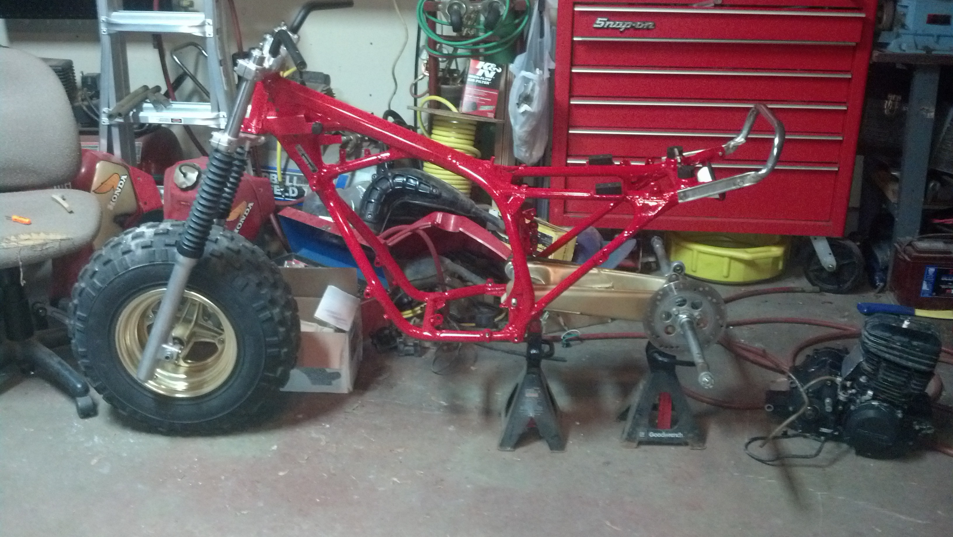

    UPDATE! Took the jug in to have checked-needs to be bored out to 71.5mm. Also having the gold head checked for straightness. Installed new front and rear wheel bearings. Got the swingarm and shock cleaned up and reassembled. Cleaned the front forks and installed leak proof pro-moly seals. Cleaned/degreased the donor frame, primed and painted it this afternoon. Planning on reassembling the front end tomorrow. Might throw the spare jug and head on to clean the engine up too. Should be ordering my piston and reed spacer mid-month.

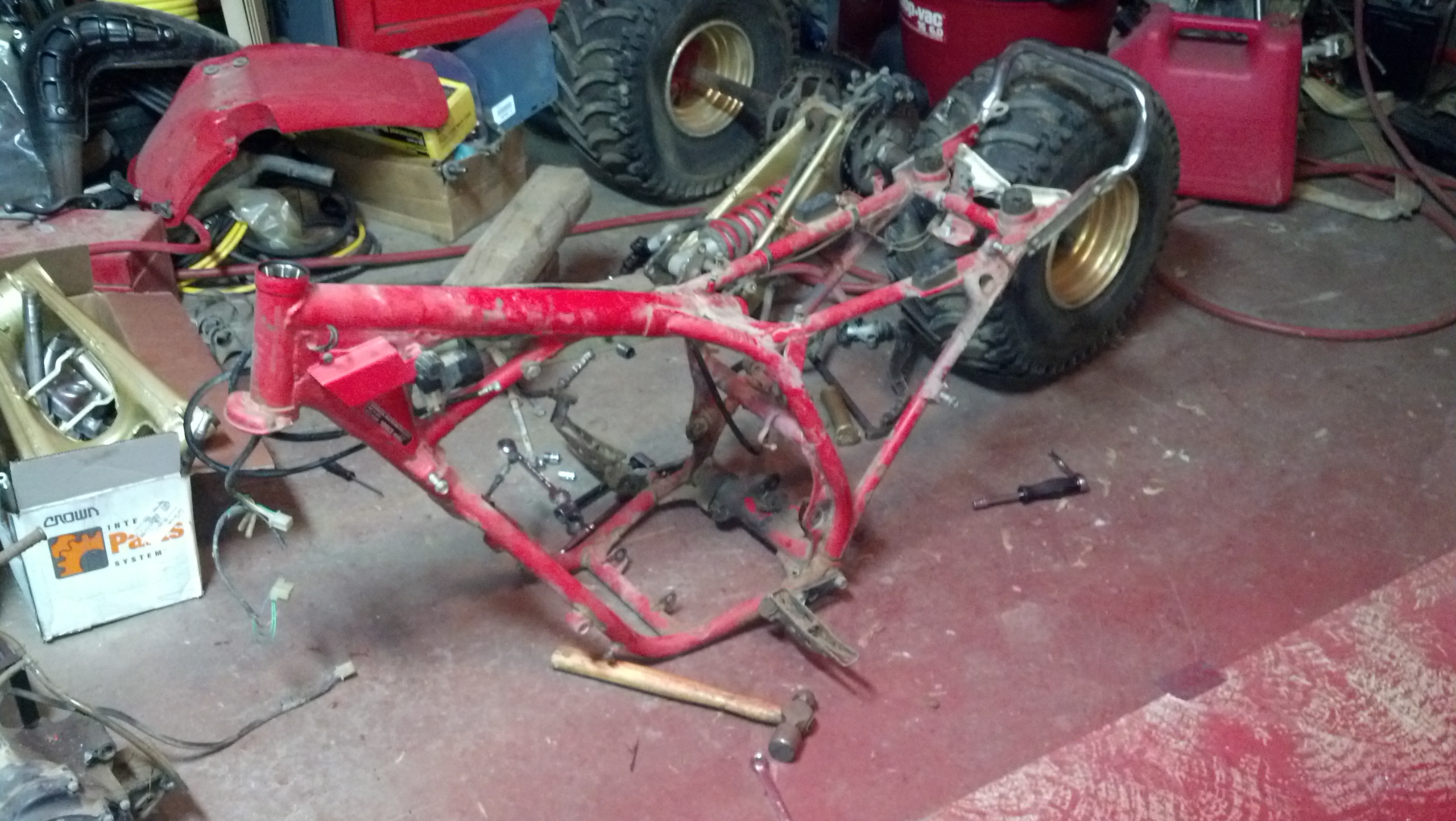

ID:	175561Click image for larger version.
ID:	175562Click image for larger version.
ID:	175563Click image for larger version.
ID:	175564Click image for larger version.

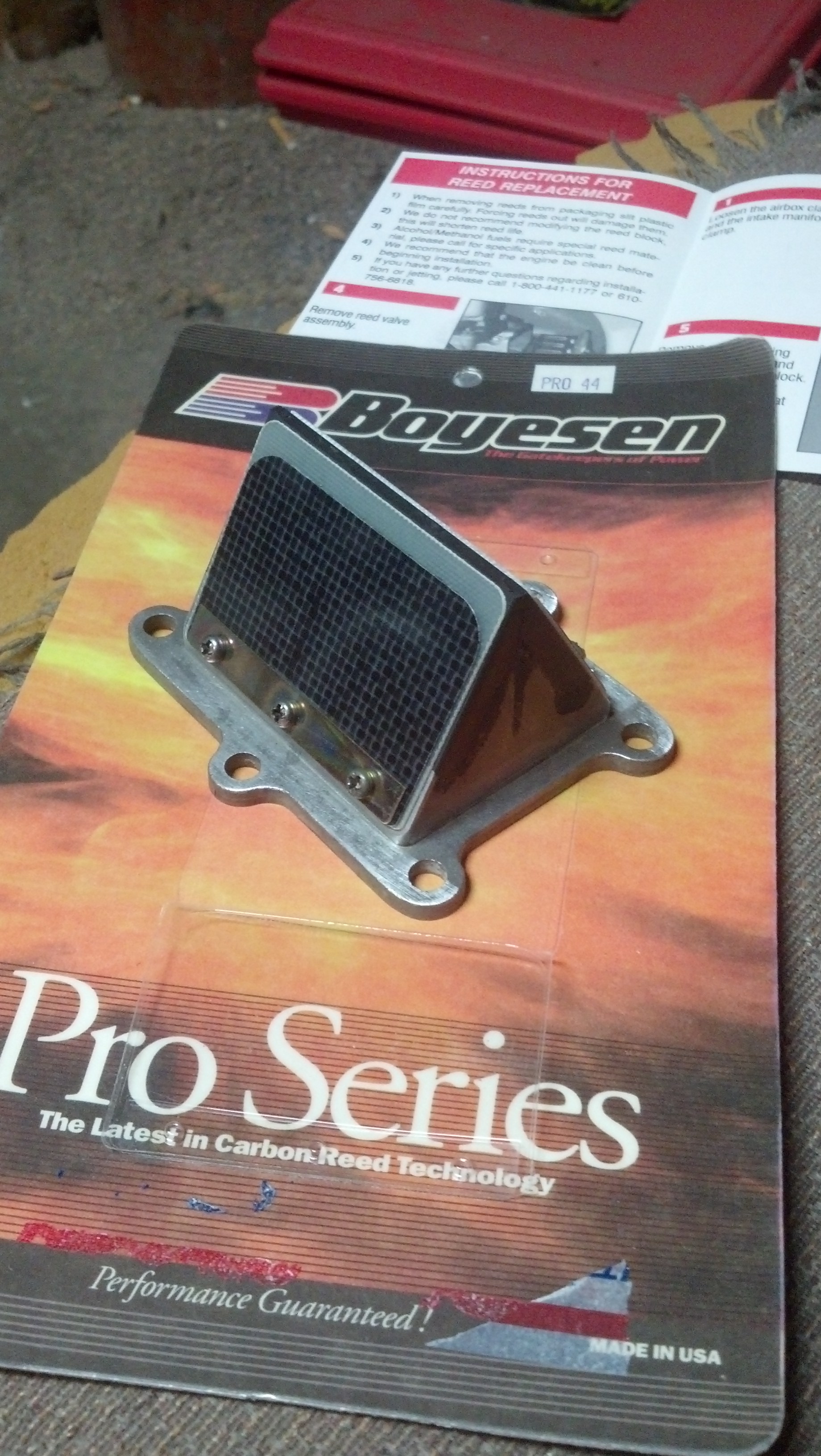

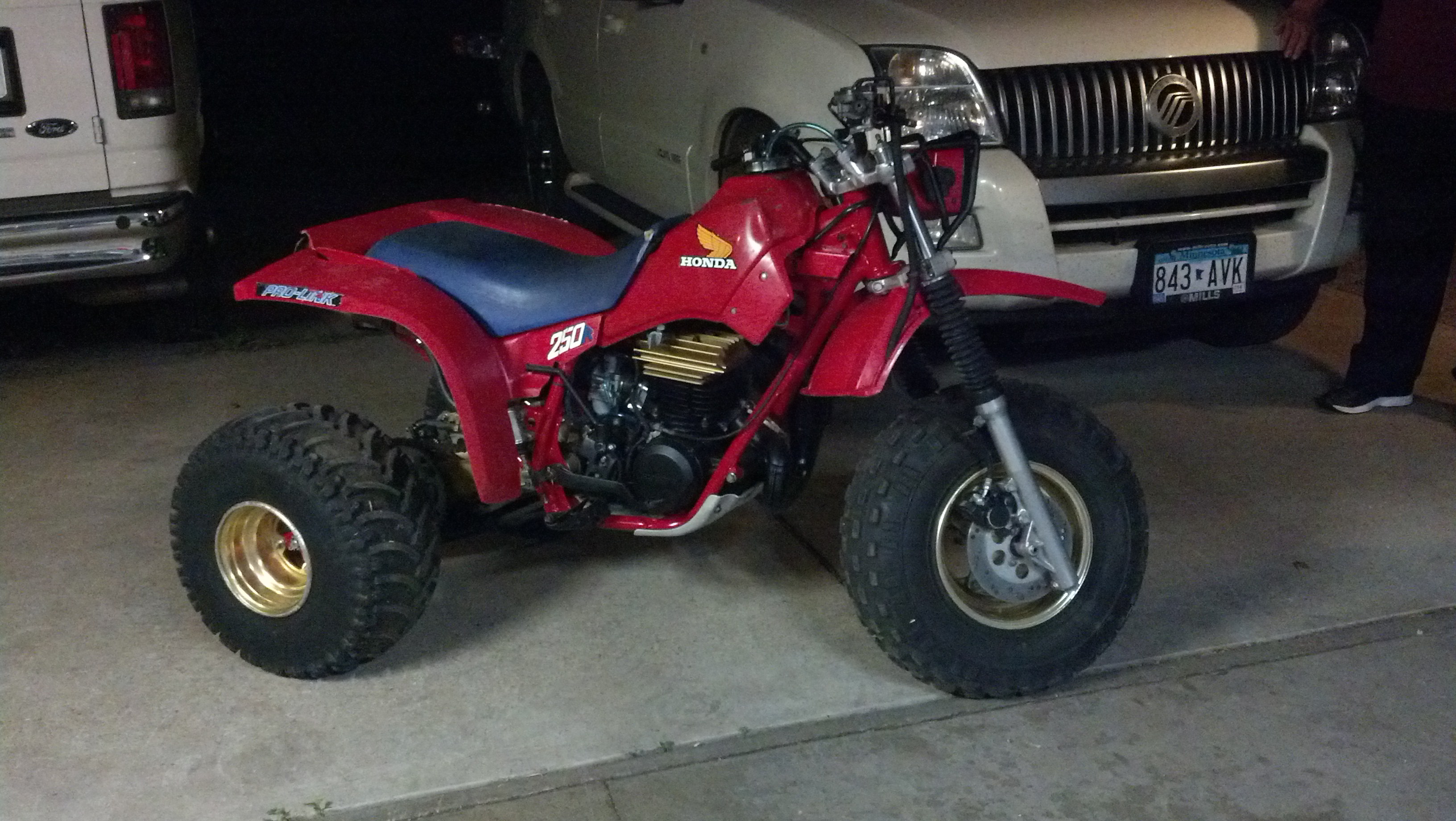

    UPDATE!! The "Franken-Wheeler" lives!!!Click image for larger version.
ID:	176737Click image for larger version.
ID:	176738Click image for larger version.
ID:	176739Click image for larger version.
