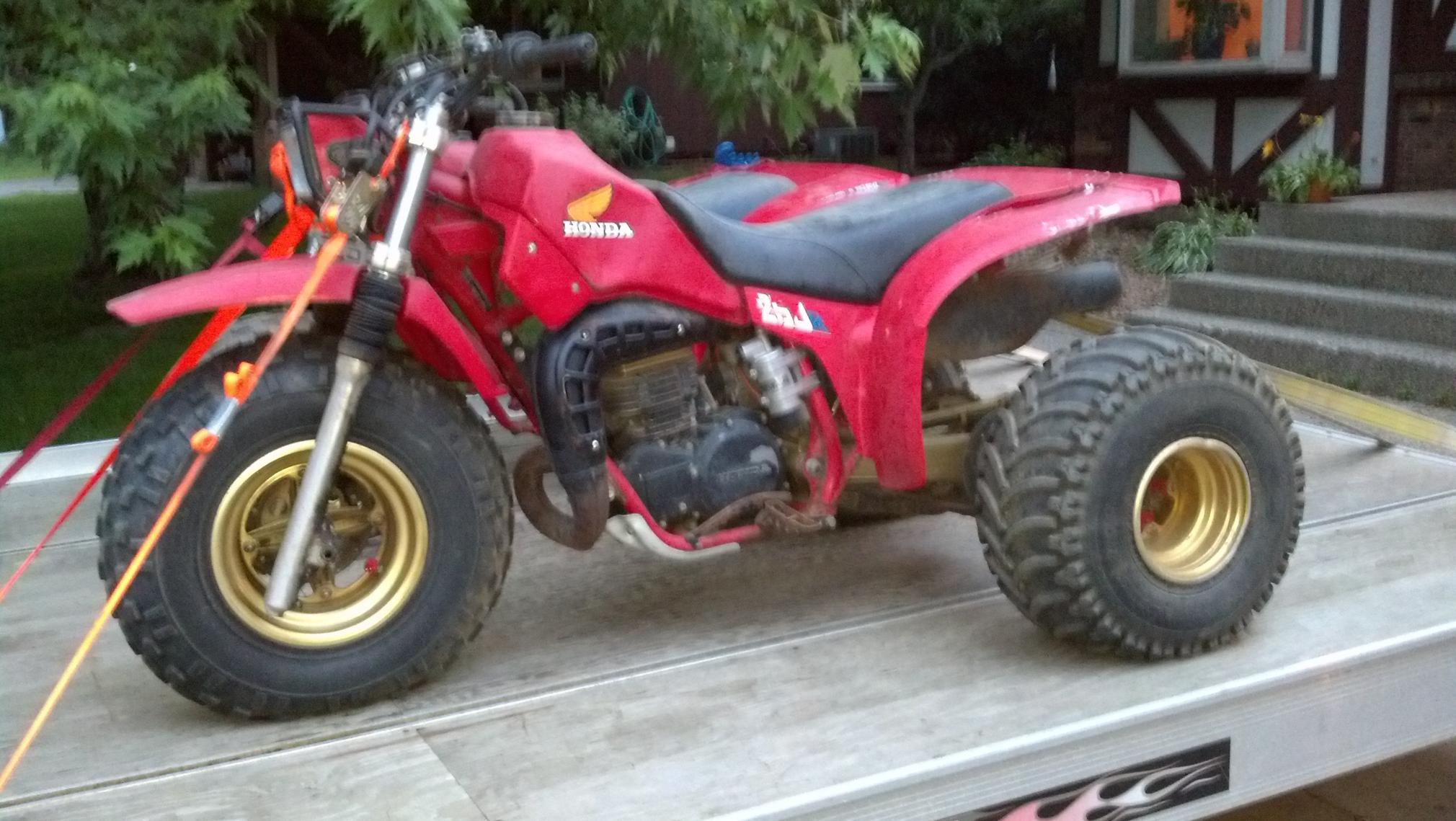

    I just recently inherited my brothers 1983 HONDA ATC 250R. It hasn't ran since about '98 but ran good when it was parked. It also came with another '83 parts donor (minus the engine). I would like to make it a screamer but keep it within budget guidelines (the wife is making me save all of my receipts). Everything is stock on this thing (that I'm aware of) except for the GOLD head and wide rear axle. As I recall, my brother bought it from a dealer back in the day that acquired it from someone who use to race it. So I'm not sure what has been done to the engine. It has one bent front fork, broken rear plastic and some rust on the frame. I'd like to clean up the donor frame and repaint it before using that as my building ground. I was going to start by replacing the leaky front fork seals, rebuilding the carb, installing a UNI air filter and installing a set of Boyesen Pro Series reeds. Anyone have any comments/tips/mods for where I'd like to go with this thing? I'm unsure about any tuning with installing the reeds also (ie:jetting,etc). Any help would be greatly appreciated.
    Thanks!

    there may be some porting done inside that motor. check the condition of the boost ports. if theyve been wallowed out, chances are that the exhaust port has also been raised.
    looks like you wont need much to have a complete runner! good score!

    Sweet bike, one of my favorites! Don't keep those forks compressed like that though.

    OK. I will have to check when I get home in a few days. I'm not too knowledgeable on the 250 so what am I looking for as far as the boost ports? and the pictures I took were from when I just got home so the twins are unloaded now.
