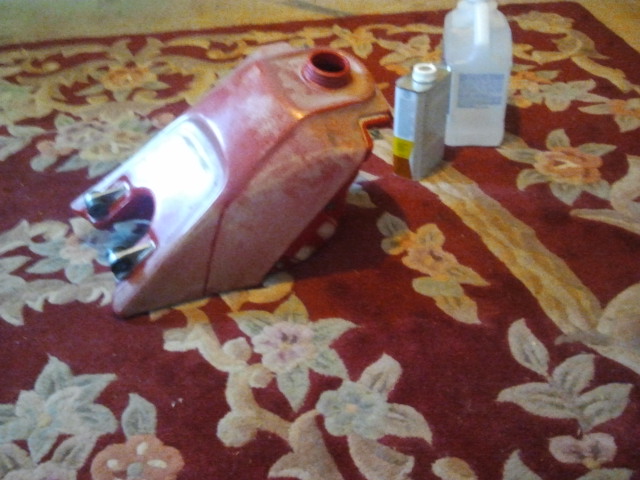

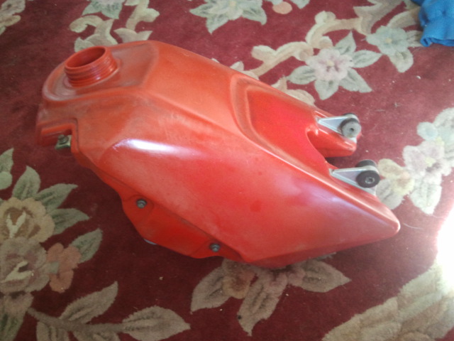

So I tried the linseed oil/paint thinner. Not sure on the ratio.. i just kinda threw the concoction together. I must say it did work to a point, it brought the red out and made the whites less noticeable. I do still see where the white was though. I'm on like my 3rd coat.. I'll probably need 10 or so sense the guy on the video used 6 and his plastics were not nearly as bad as this tank. I used 400 grit wet/dry paper on 2 white spots and it took them off within 10 seconds so i'll probably have to sand the rest out now. My tank also has some black residue that's hard to remove so its kinda hard to tell how well the stuff worked. (thats what that streak is on the right side)
All in all, i say give it a try, if your plastics are not nearly as bad as mine then yea go for it!

Yea after I did this I had a small piece of white left that the mix didn't fix.. lol.. so I took 400 grit to it and it came off it maybe 10 seconds and it looked brand new. Its definitely worth the try!
