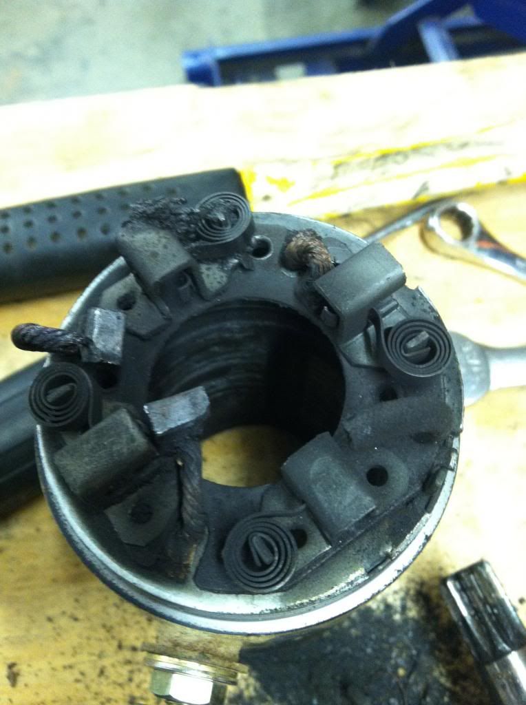

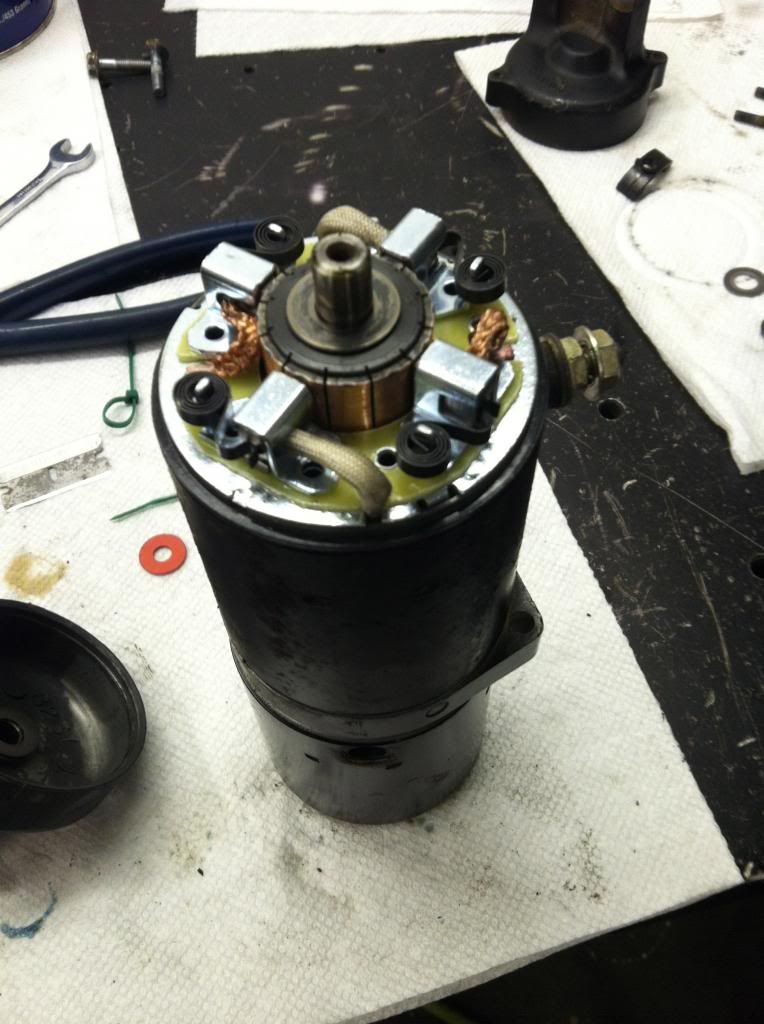

    I've had this same exact problem happen to me recently on an '85 I built. I'm surprised you guys haven't suggested this but here is where the constant short was for me:
    Yup, inside the starter due to so much crap and general deterioration of the brushes. Pull it out and pop the end frame off and see what it looks like. They are easy to rebuild, you can chuck the rotor in a cordless drill if you have to and use a file like I did to level and smooth the armature but a lathe is the way to go. The source of most of that crap was the hard-baked plastic stuff covering the copper windings between the armature and the rotor field- you should not be able to see the wires in that area, they should be buried. It gets hot and breaks down, accumulates and progressively causes a short, which in turn, generates more heat the starter has to deal with. For this rebuild, I ended up using another rotor.
    Kits are $20 something on Ebay and are pretty good. Save the original phenolic washers if they are in good shape, I don't like the ones that came in the Ebay kit I got. Also- very important, don't bother using the new needle cage bearing (brush side) that is supplied with the kit, they do not fit over the shaft. I've had no problems using the original, long as it's decent just clean and regrease.
