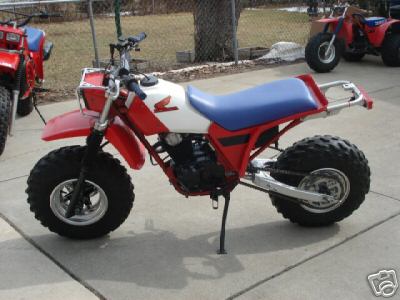

    Probably, here are two examples
ID:	174086   Click image for larger version.
ID:	174085   Click image for larger version.
ID:	174084   Click image for larger version.

    Quote Originally Posted by RapidRick View Post
    What kind of swing arm is used on these two?
    Nov 2013
    Oxford CT, New Haven County
    984
    Quote Originally Posted by sharky55 View Post
    looks home / shop made to me. what a great job on this one. it looks really good.

    Those are cool, RapidRick.
    I like the way using a front tire on the rear eliminates the need for a jackshaft setup.
