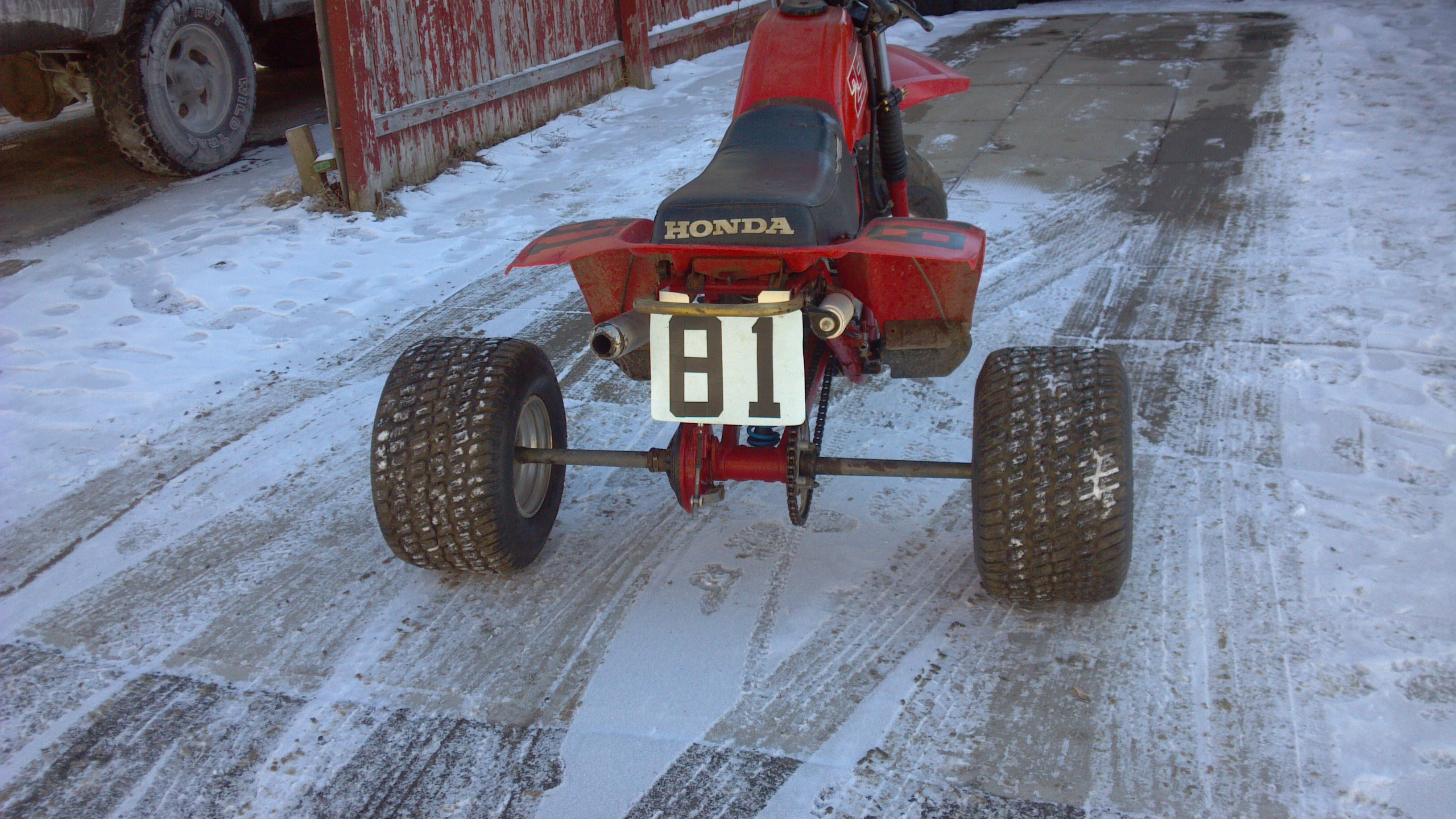

    Im running the 18x9.50x8 on my 81 250r racer. I was at Wal-Mart few days ago and they had some 16x8 tires. Im thinking of getting a set but I dont have a set of 8 inch rims narrow enough for them.My 18s hookup well they get good bite actually to much at times.I highside with a plus five axle and four inches of hub extension.Click image for larger version.

    Yes a 18 X 9.50 X 8 can be too much tire on a tacky track. I used to race with some Goodyear Softtracs in that size and when they started getting hot I started tipping. On those the outer edge was real square so I took a grinder and rounded the edges. Made a lot of smoke doing that
    If you could get the 16 X 7.5 X 8 I bet you could pop that onto the normal 8" wide wheel but I know the 16 X 6.5 X 8 is too narrow and stiff to pop out on that wide of wheel. I had a set of those on my Nicholson 110 and used ATC 70 6" wide Douglas wheels that were the 3 bolt pattern. For your 81 racer you could used the ATC 70/90/110 3 bolt hubs and get some of those narrower wheels then the shorter & narrower tires.
    I went by Tractor Supply (TSC) on the way to work today and they had the 16 X 6.5 X 8 on the shelve for about $34 each.
