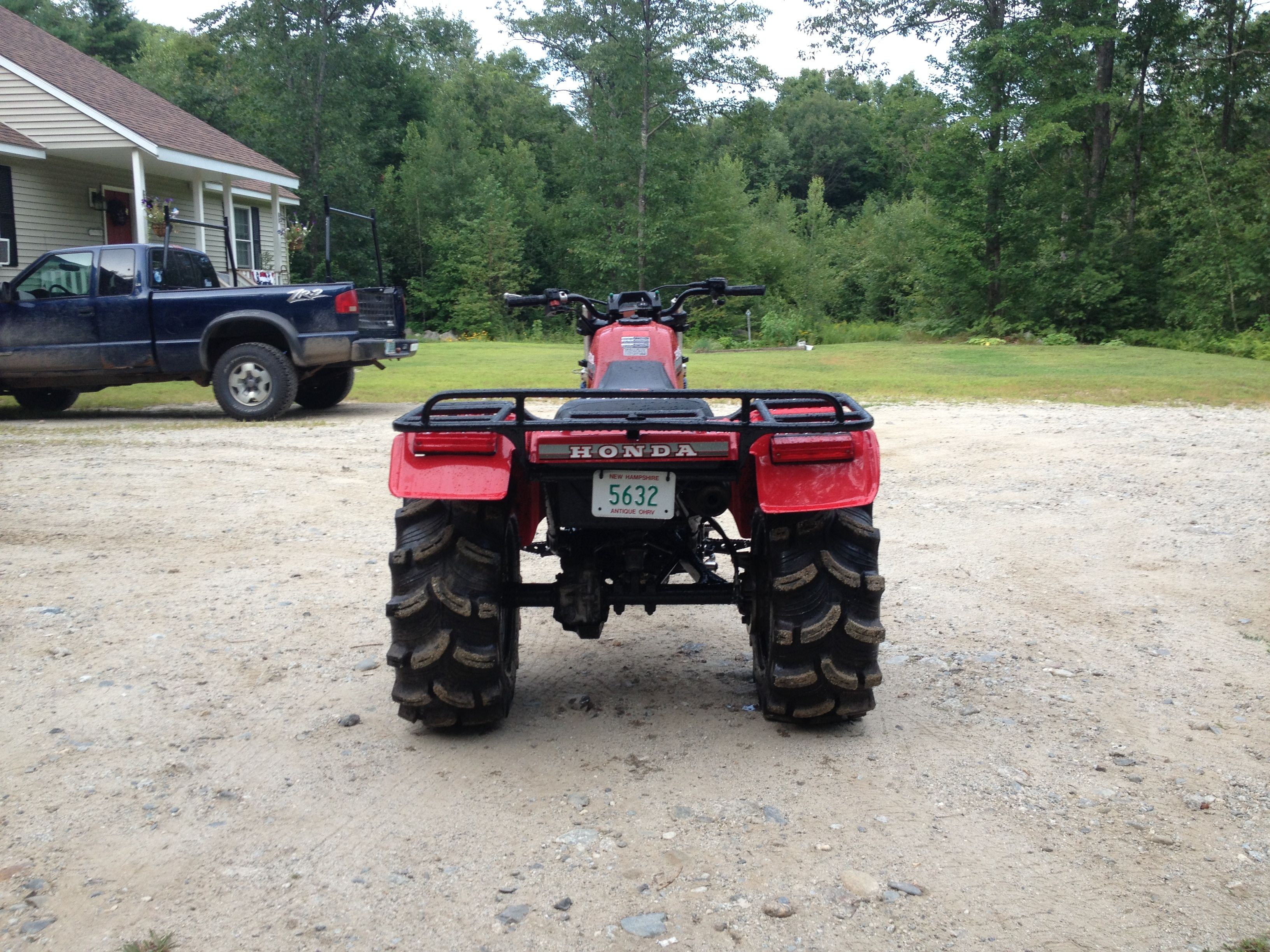

    I agree with doug on the executioners. To much tire!!! But now I know... Except I'm stuck with $200+ tires that will take an eternity to wear out. They do go anywhere though. I got the 26x10-12's because I wanted a little taller and skinnyer of a tire...
ID:	175000Click image for larger version.
