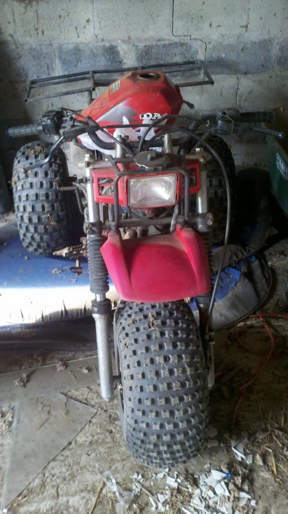

    Back about a year and a half ago I stumbled on this 250 SX sitting in the back of the barn at my buddies place. After some prodding I got him to come off it (didn't hurt that he was out of a job and needed some money), he let me have it for $150 (he named the price)!! This is how it sat in the barn when I found it..................
    Yes that is black pipe (plumbing pipe) welded to the grab bar to make a utility rack.
    After some digging around the barn I managed to find all of it, rear plastics, carb, everything missing but the petcock off the gas tank. Through it up in the back of the truck and took off before he could change his mind. After a little sawzall massage on the grab bar, a fresh spark plug, soaked the carb for about a week and clean it all out and scrubbed, threw on a plastic tank and she fired up with little effort on the kick start. Then I through in a battery did a little wire work and had it starting from the button! So within a couple weeks of me having it I went for a little ride and got her a little dirty and was having a blast!
