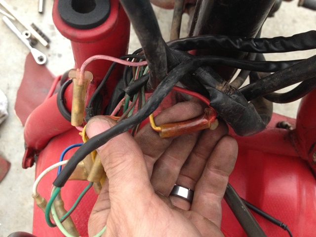

    Free '84 200es received from neighbor, no CDI. Was scavenged for another trike I was told. Everything else is there. It is hotwired at the light because of lost keys.
    -First problem related to CDI or not, not sure. Before and after the CDI swap, the only way to get the starter solenoid to work is to jump it with a screw driver. I thought the CDI would fix this but it didn't, still had to jump the terminals after the swap too. Related or not?I'm going to get the diagram printed and start going over it to see whats going on. Thinking bad solenoid? There is nothing when its in neutral and i hit the start button.
    Here is how it is hot wired

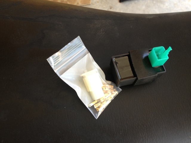

    I ordered the 6 pin connector as suggested in and chinese CDI from e-bay. All seems well, I have spark but didn't fire it up because I'm waiting on some parts.....new carb and air filter.

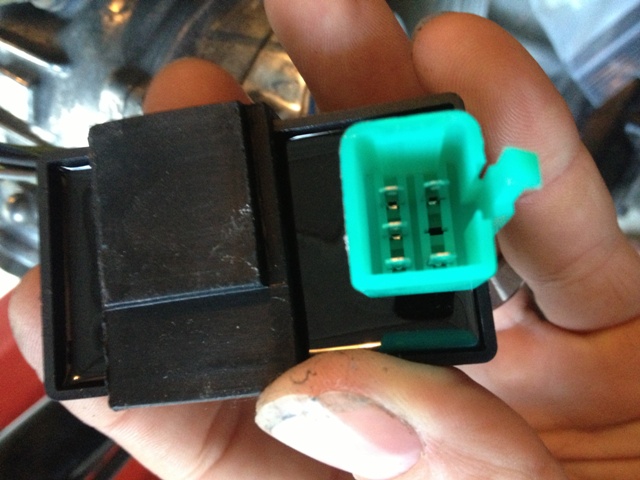

    I swapped out the CDI last night with the new plug and took a few pictures. I'll probably make a better diagram than what was in that sticky as well. It did the job though. I did not use the new brass pieces, I just release the existing and went on my way. Worked just fine. CDI and connector as received. Super quick shipping too!

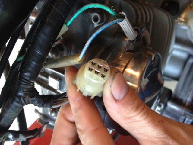

    Factory connector

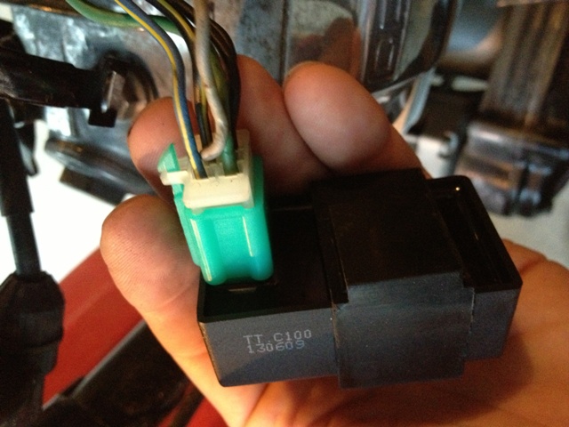

    Shot of the CDI itself

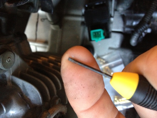

    Small tweaker screw driver I had in a set that was perfect for releasing the pins.

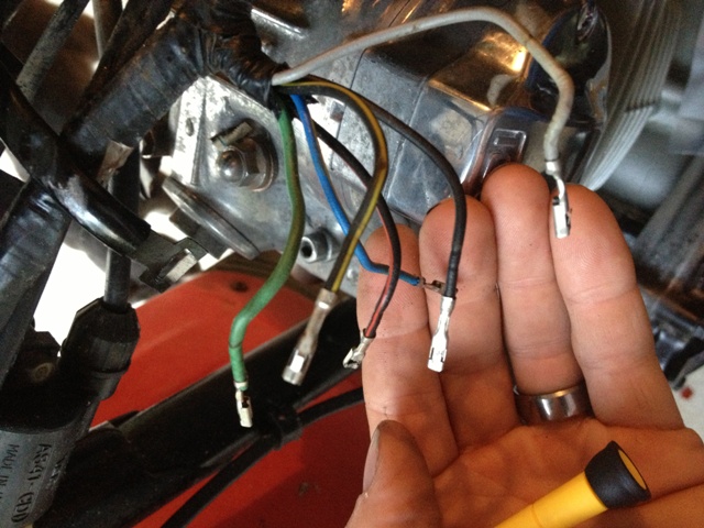

    How you release the wires from the connector, too a whole 2-3 minutes.

    Old wires in new connector

    Attached to the new CDI

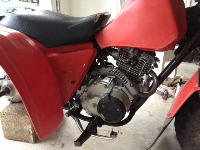

    EDIT!!......forgot....some progress pictures of the trike
ID:	175390Click image for larger version.
ID:	175391Click image for larger version.
