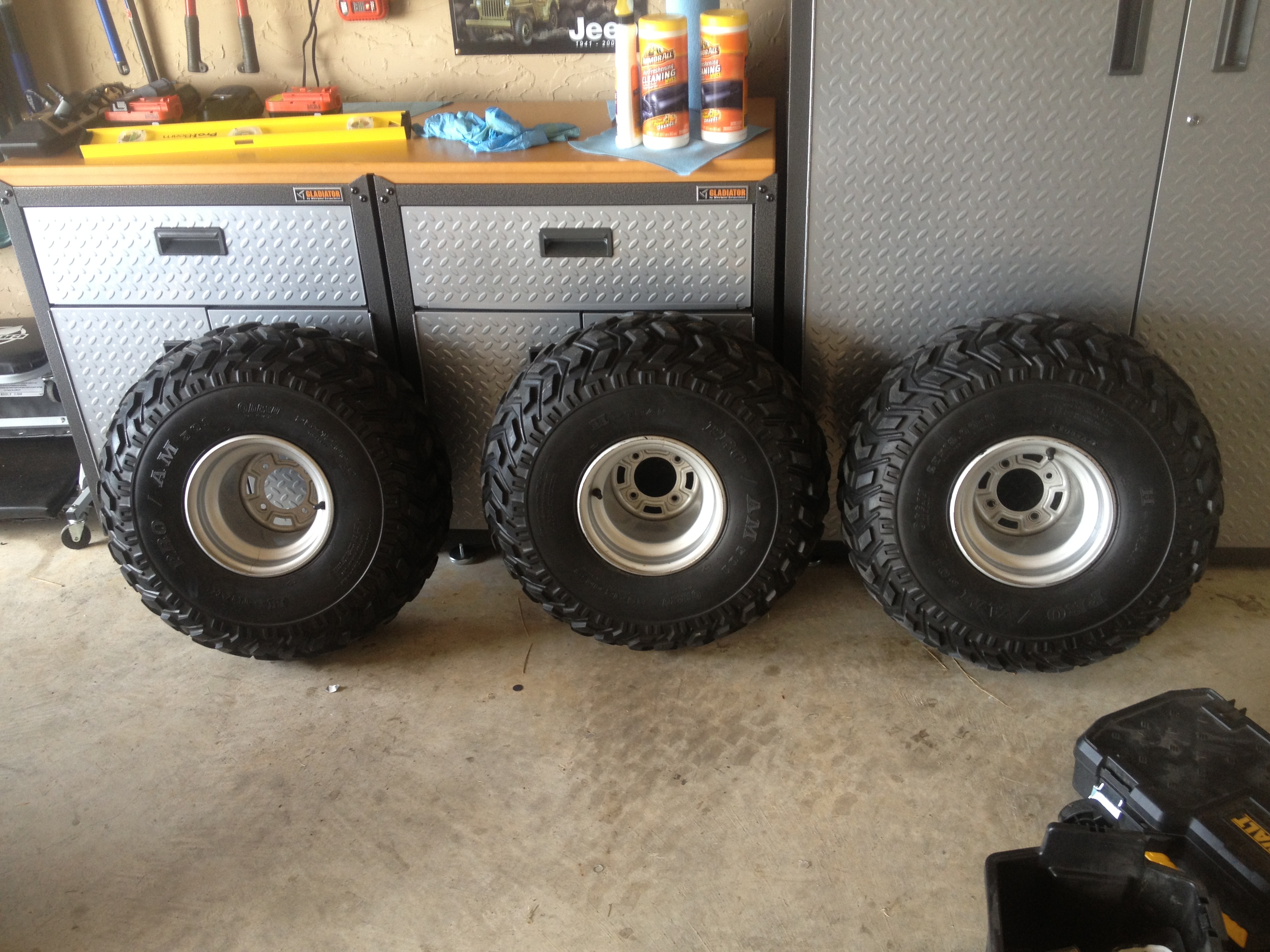

    Here are some of the latest pics of my BR, I have attached the speedo and it works well. I should have clicked some better pics of it, but my point with these pics was to show some of the things I have done recently. The pic with what appears to be a paint run on the fork was me covering up a huge scratch with some paint. I am just testing the color, it was Rustoleum Sunrise red and it did pretty good to match. The other is the rustoleum silver touch up paint I had spoke about in another thread (don't have it in front of me right now), but its a decent match for the forks as you can see. Cleaned those up decent. The pic of the key switch is where I used JB weld, brush on primer, Wipe New, and black paint mixed with Wipe New lol. It actually filled in the gouge and it doesn't show in person like it did in this photo. Plus, its not as shiny now and looks a little more OEM. The las few pic are where I bought some old Carlisle Tires and and original wheels to mount on so I can ride and not destroy my original Ohtus. The Ohtsu's lined up on original rims are going to be packed away in light oil so they don't rust or rot. I will use them for special occasions...or until they start making them again BTW, the Travelrite speedo gear box and cable worked just fine with the NOS OEM Hondaline speedo. I got up to 35 with the BR screaming lol...I didn't want to push the ol motor much more than that I know, my tank stickers are crooked...It was sold to me like that. I don't know why they are so crooked. I guess someone replaced them before. I have a new set, just haven't done it yet. And if you can see my speedo mount, I made it so don't laugh lol...It was made from the Travelrite speedo bracket I got and perhaps a 250R bracket bolted together. Not sure what the other mount is that I have. Works though...
