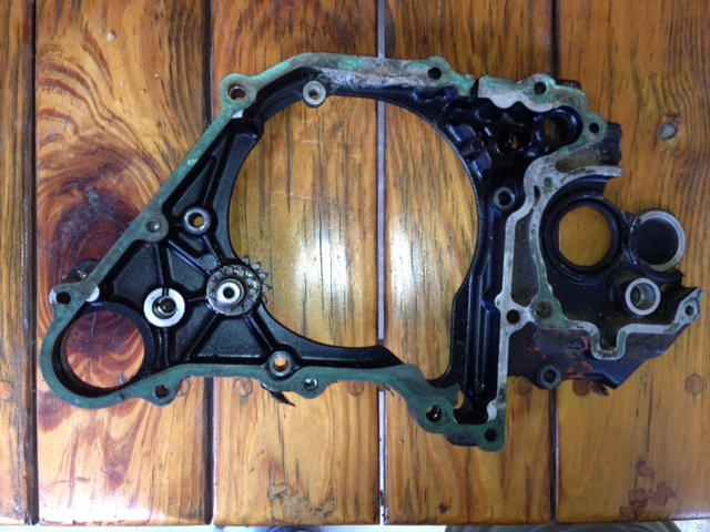

    Kb, the cover was in place on the motor but broken around the sprocket, so you might be right on the chain slap....I'll post a pic tomorrow so you can see the broken part. The outer cover was intact but I needed another for my other 125 which has a cracked one (which potentially allows water in) so I wanted to replace it.

    The sub trans was missing in action. In as purchased condition, someone had made an attempt at fixing, the bolts were loose on the left engine cover and spacer. The recoil was missing and the sub trans was missing. When I bought the trike, my original intent was to use it for parts for my running one. I had no experience working on them either and didn't even know the trans was missing, lol. If I had it to do over again, I would look harder to find one in running or close to running condition to work on. I only paid 50.00 in the first place, and as i got to looking closer at it realized its in better shape in some ways than my running 84',,,so i decided it would be a shame to just tear it all down in to parts if i can help it. now I'm sorta into the challenge and fun of rescuing a 'goner'.
    Here is the broken left engine cover spacer (in the sprocket housing area). Another little bit of tidbit of info, the chain has a bad kink where the link bound up, so I bet you are totally correct about the chain jumping the sprocket causing the failure...

    Heck if you only got $50 into buying it putting a couple hundred into it is well worth it if you ask me. You still come out ahead and have the satisfaction of bringing it back yourself!
    Wow that is the worst left side damage i have seen on a 125, a whole piece is gone!!! That must have been brutal when it happened. Definitely get a new chain and unless the sprockets are still nice i would replace them too. Generally what happens is you get too much chain slack and eventually end up with a broken chain that gets wadded up around the front sprocket when your moving along at a good clip and bammmmm...
