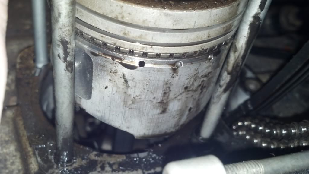

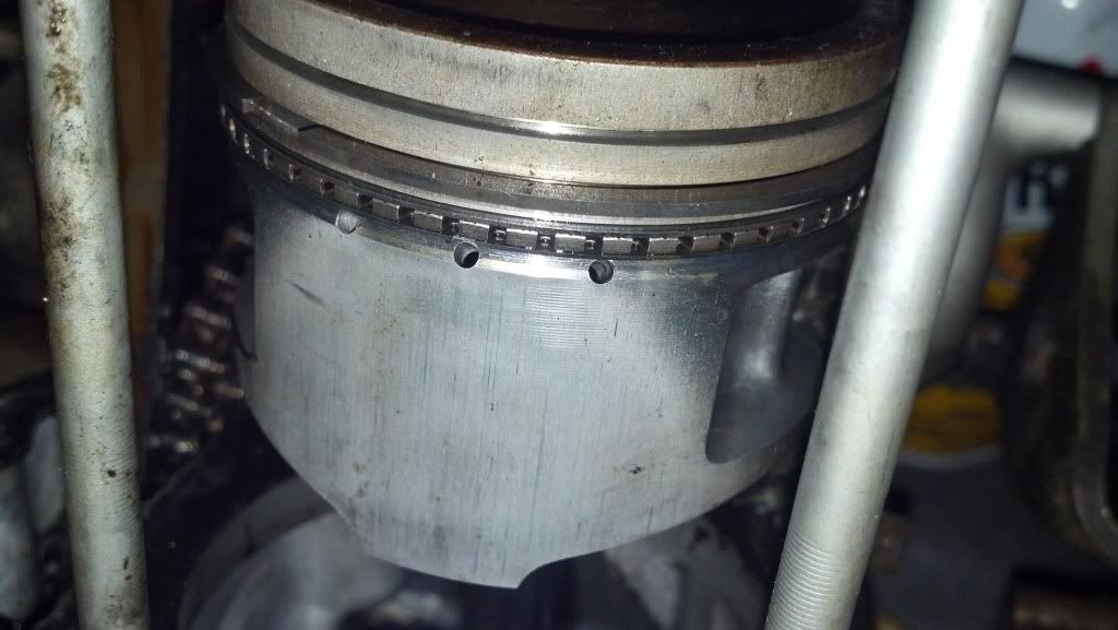

    unfortunately i didnt have it running. :/ i bought it as a project. any other way to tell if the chain is bad? i assume not
    took it to the local atv shop and they thought it looked to be in decent shape. had them cross hatch the cylinder and looks like it sat too long at one point said it would run but will prob smoke.
    he said he will look in their storage when its not so cold out and maybe ill be lucky and they will have a cylinder with original bore

    Since they re-honed the bore i would put in a new set of rings then. They will take some time to break in. Also even if its no longer letting oil past the rings after a hone and new rings chances are she will smoke a while... There will be oil built up in the exhaust. I have had that happen, rebuild the motor and the exhaust still burns off oil in it for a month of riding... LOL
