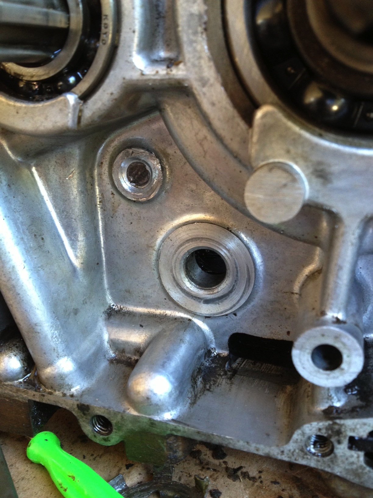

    So I got to looking a little closer and figured out that this little part had broken off in the crankcase at the threaded end. My service manual pictures were not very clear and didn't show this even as a separate part in the parts breakdown diagram (that seemed a little odd). Here is a couple pictures of the case:
    and close up:
    The pin side of this little broken part notches into the shift spindle assembly into the "shift return spring" assembly area. Not sure exactly what the function is but I'm assuming this spring action returns the foot shifter back to 'zero' after shifting. If that's the case then my other problem of the shift drum only going through two gears won't be solved by fixing this part. And that brings up the next question....is this part even fixable (getting that broken bit of bolt off from the case does not look easy, and if was able to I sure havn't seen that little part for sale)? Or am I left now with getting a new right side crankcase. What are my options to tackle this problem?

    Wow, first time i have seen that part get broken in one! Its purpose is to limit the travel of the arm when the shift lever, the foot lever, is pushed upward.
    Your going to have to use a left hand drill bit and easy out to remove it. Get an extractor kit from your local hardware store. The bits drill in reverse so you don't risk forcing a broken bolt farther in. I have had a few items snapped off like that come out with the drill bit force alone, but most of the time you have to drill it a bit then you use the left hand threaded extractor to spin it out.
    Its not in the parts diagram, your correct on that. You probably going to have to remove it and repair it, unless you can find one.

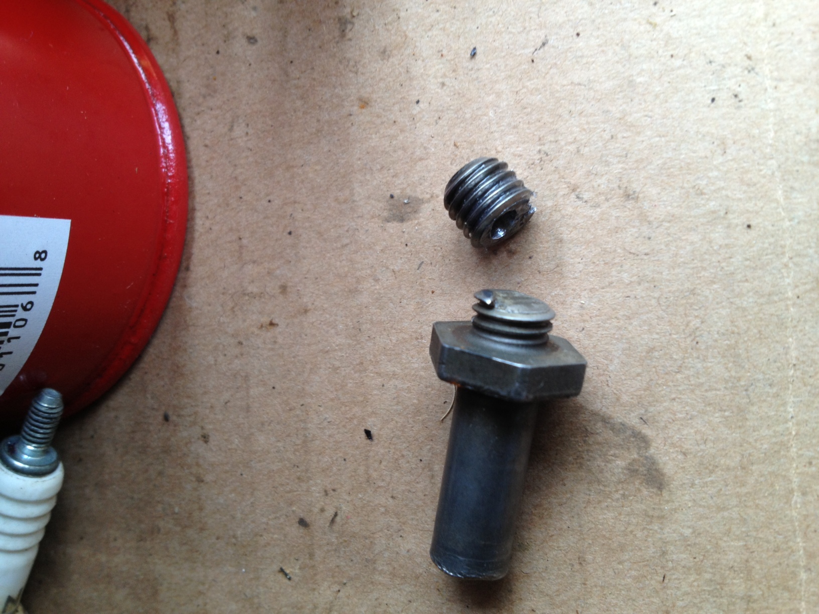

    WOOOOOOOOOHOOOOoooooooooooo!!!! Got the piece out tonight! Went to Northern Tool got some left hand bits and extractor set, used the 1/8 bit and let me tell you...had to be patient. Took at least 15 minutes of patient drilling progress was slow. Kinda started varying the revolutions of the drill, sort of like gentlly revving it. That seemed to help find the sweet spot as far as drill speed and cutting....and then I was shocked when the bit just seemed to bite and the broken bolt just backed right on out, never had to use the extractor!
    Here's how it looked on the drill bit:
    the broken bolt/pin:
Name:	photo copy 4.JPG

    And the hole ready for replacement, a little wallowed out but should be okay...
