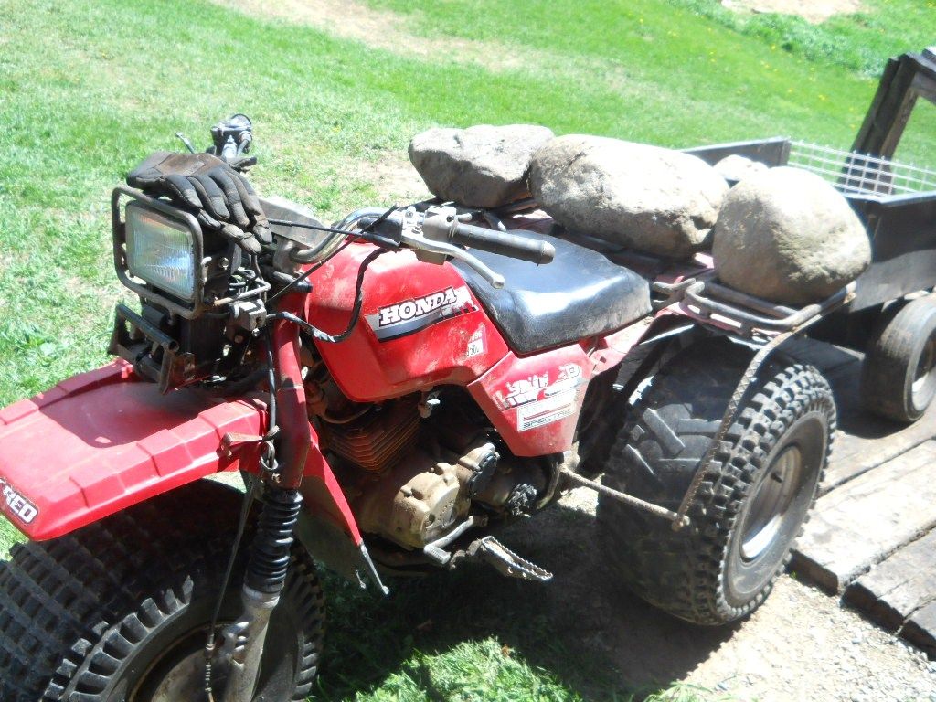

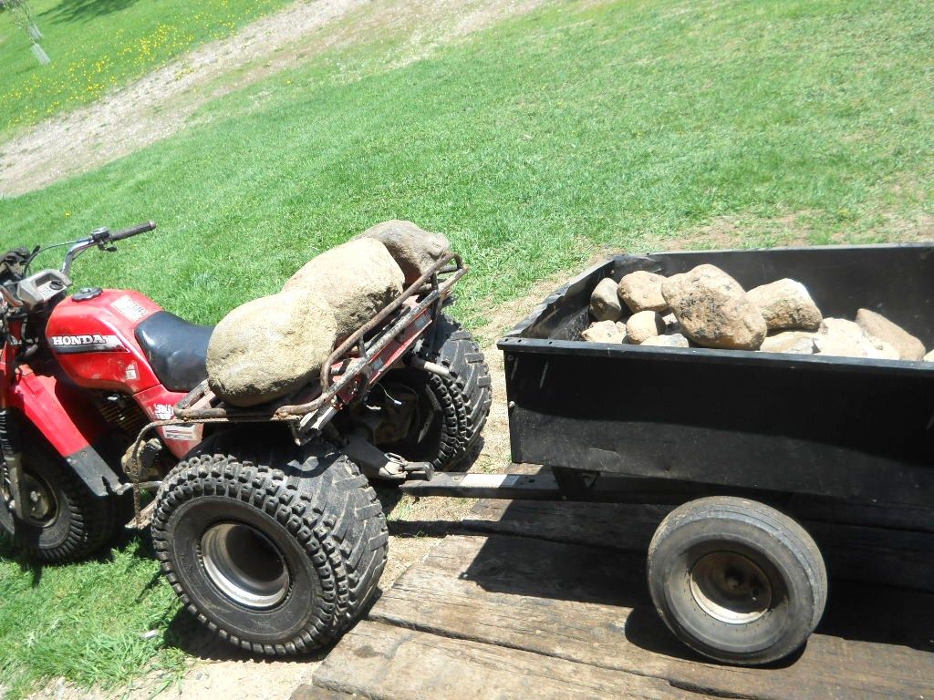

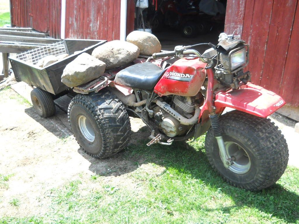

    This is the 86.

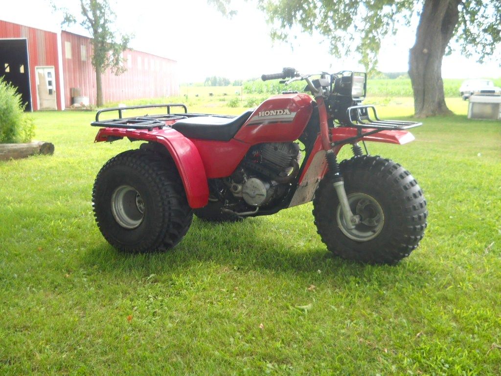

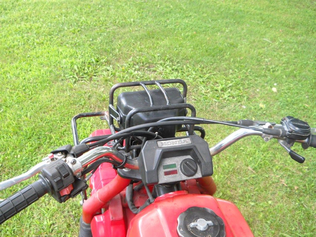

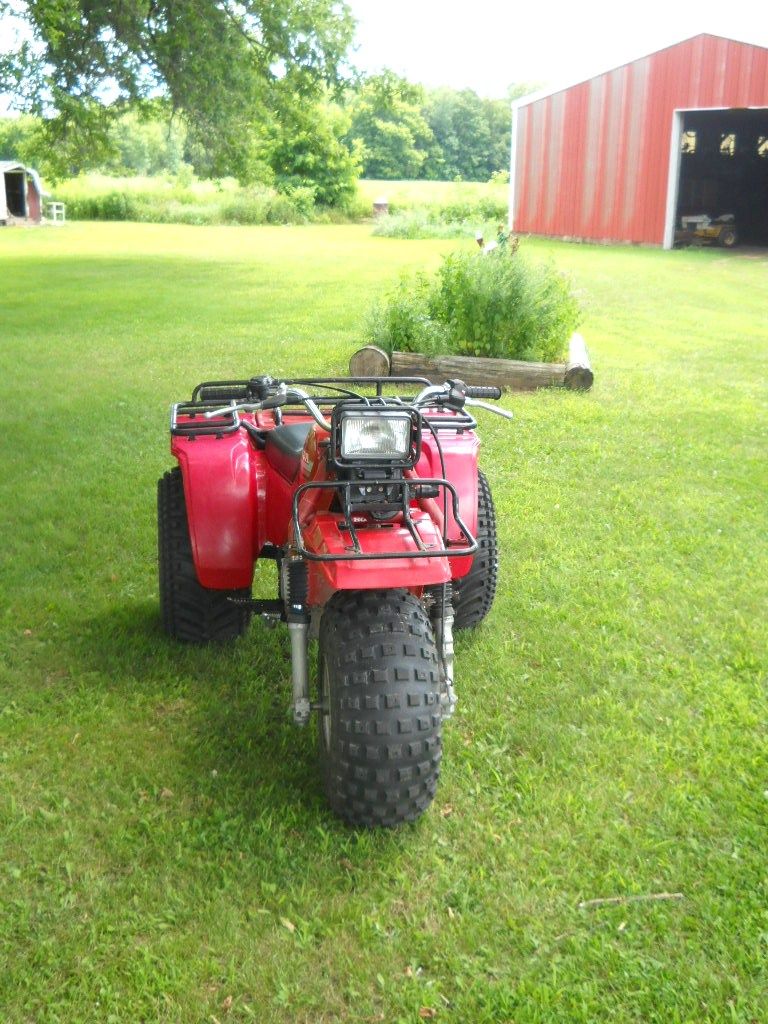

    This is the 85

    you will have no issues using the 86 engine in your 85 its a direct bolt in and hook up
