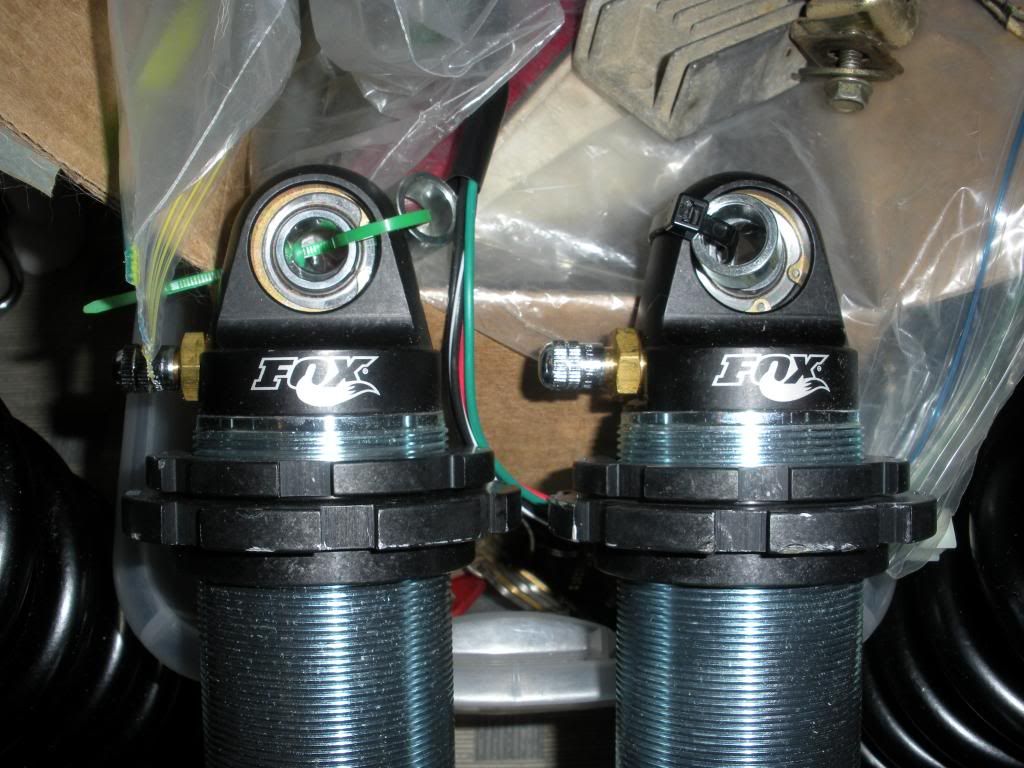

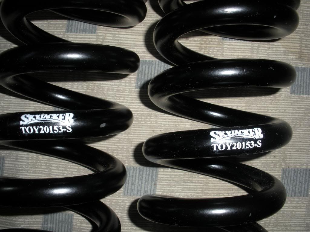

    Finally got the Fox struts, Skyjacker coilovers and new complete leaf springs. Truck is an 03 Tacoma V6SR5 and it needed a lift bad.
    Should have it all done tomorrow with before and after pics.
    No spacers, shackles, using old parts etc etc. Springs are in the shop and I'm tired.......

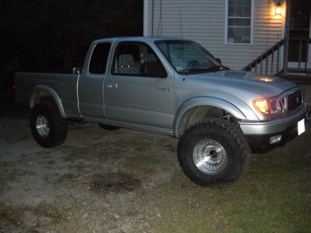

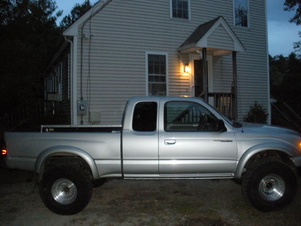

    All done, about 2 days. The new rear leafs lowest one was thinner than my OEM. I had forgot I have a tow package so I swapped the lower fat leaf and still got 3"s. Although the frame was replace a year oer so back, everything was seized. Oxy/Acet, grinder, drill, pry bars, ratchet straps etc were all needed.
    I'll get a pic in the light for ya; Minor dremel work needs to be on the 2 front fender flares, they rub a bit......
    ABS has an issue so I have to start another thread.
    Got a bit dark when I was done. This is the 3rd Toyota 4x4 I have ran these American Outlaw 1 wheels and a BFG Radial All Terrain. Much more fun to drive!!

    Nice stance, looks well done! Is the ABS mounted internally to the front bearings like a Chev or is it just an external sensor pointing to a ring? Maybe the clearance got disturbed with all the banging around?
