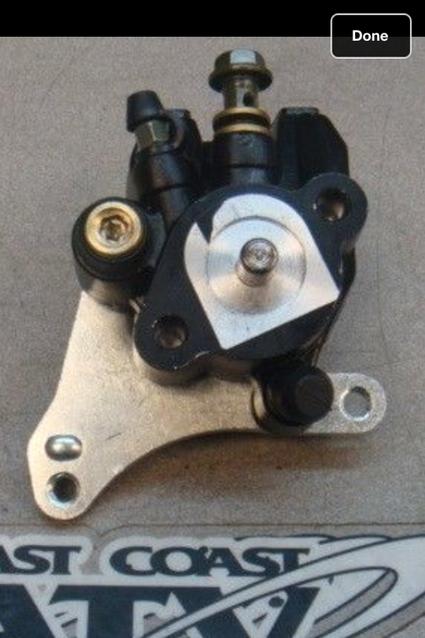

    You have an 86 rear swinger there, which is why the stay fits...now all you need is the 86 bracket.... you also have the correct rear axle and sprocket set-up for the 86...so unless that parts bike is complete or an 86, i'd be careful swapping rear end parts.
    Oct 2013
    Tampa
    16
    So I need the 1986 bracket that the caliper bolts on to? basically the bracket is smaller since it does not need to have a torsion bar attachment hole on the end? would the bracket in the 2 following pics solve my problem??Click image for larger version.
