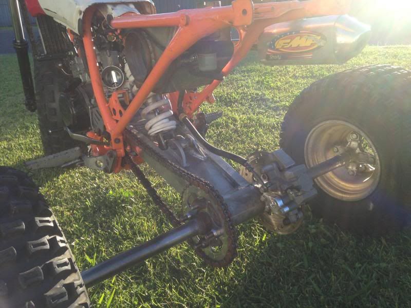

    Nice job on the trike. I'm especially diggin' on that swingarm. It sounded absolutely wicked coming around the flat track. You're like the Ricky Carmichael of three wheelers.

    Red rider I was waitin for someone to comment on the swing arm it was my favorite part lol especially the yfz 450 caliper that bad boy pulls it up I'll tell ya lol

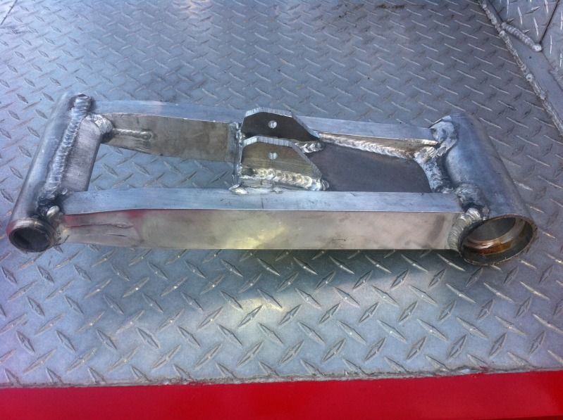

    Here's a few shots of the swinger it is ssssssssoooooo much lighter than the stock one best part is I have a jig to make more

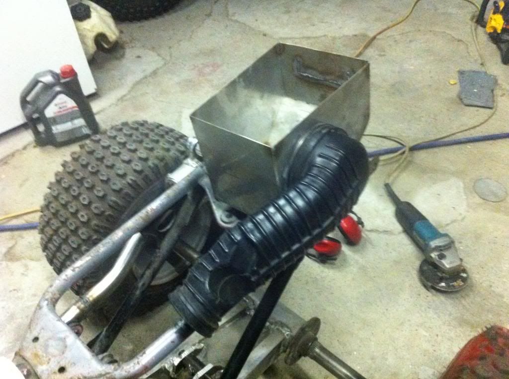

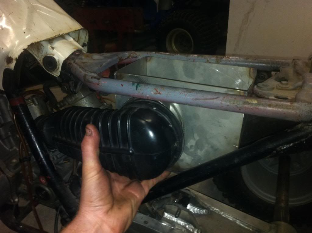

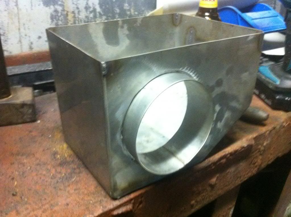

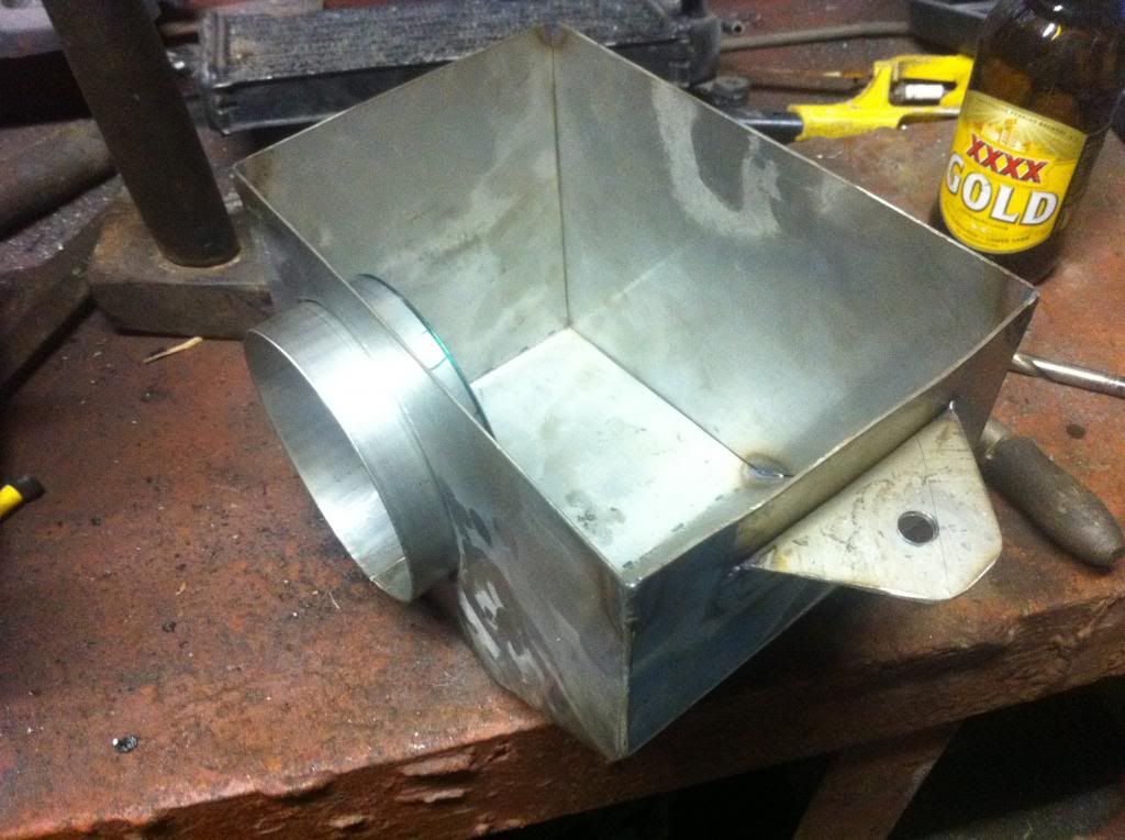

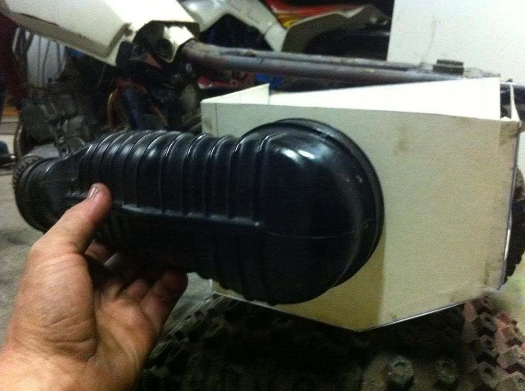

    I thought I'd also throw in some of my air box it had a watercooled 250r carb snorkel so I made use of the fits like a glove the trike runs a 250r air filter
    Made it from cardboard first lol

    What material did you use to make the new airbox? I want to do something like that for my YTM-225.

    I read this over on af.com and I reread it here .Awsom,awsome,awsome. I liked the swingarm build as much as the rest. Are you still doing the 480 topend on the liquid r bottom end .

    Yamada the air box is made from 1mm 316 stainless steel it's all I had in plate I should've made it out of alloy or better yet plastic vaccum form one as it's very heavy lol.
