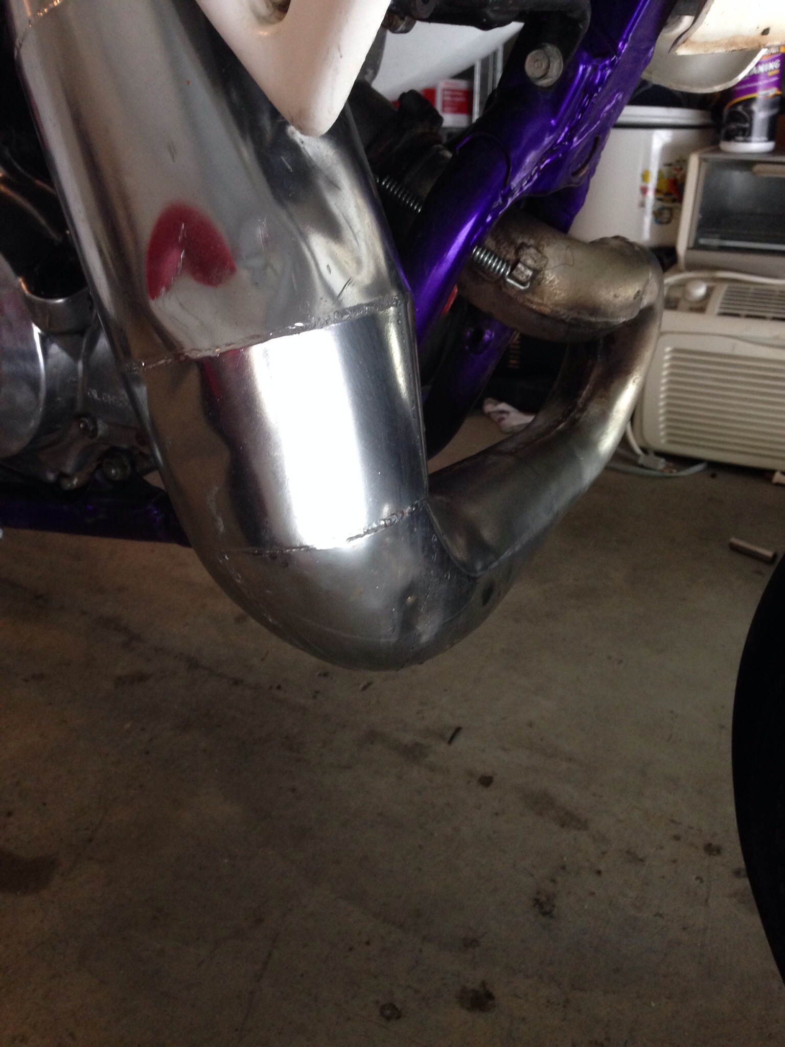

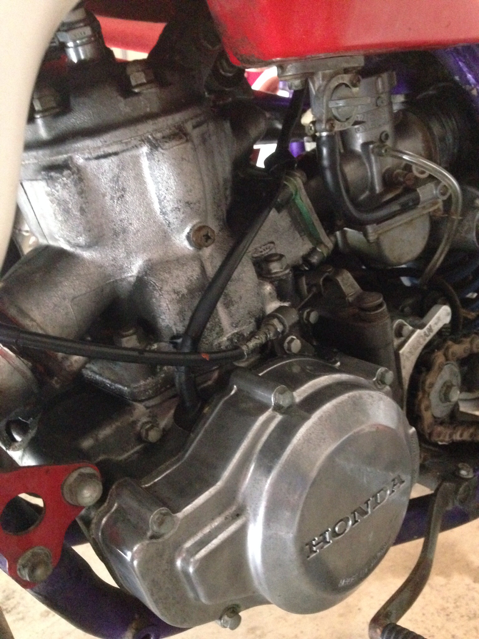

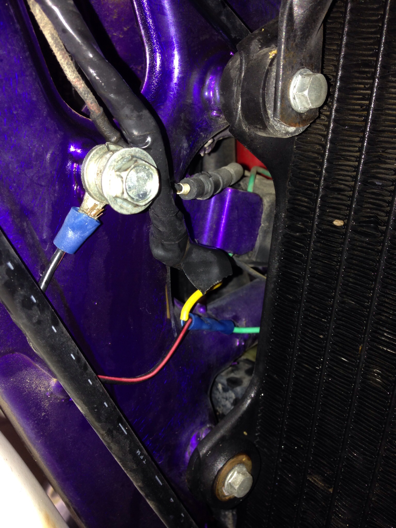

    New to the forum. Glad I joined. I have a few questions about my trike. It's an 85 250R looks to me that it has a custom pipe. Now the trike is set up for drag it has an 8" extended swing arm (from what I was told its 8") previous owner had taken all the lights off I believe the wiring is all there I eventually want to get all lights put back on so I hope that they are the correct wires.I paid $800 for the 250R it runs but has some minor wear and tear issues shock seals and such. It fires right up first or second kick. Now here are my questions.
    What ratio should I mix the gas and pre mix oil ?
    How hard would it be to get the bike back to where It will be a nice duner with some good power.

    I am not sure who makes that pipe. I can identify a few of the ATC pipes but not all. And yours I do not know what it is, but it looks like it might be a nice one beside the dent.
    I would at least run a quick compression test to give you a rough idea of the condition of the top end. A stock engine should be around 190psi if it is fresh. Also, a compression test can be helpful in determining what type of fuel to run, whether it requires race fuel or pump fuel.

    Great buy. looks like a Dynoport pipe. There are companies that can fix the dents if your concerned.

    Quote Originally Posted by NeverLift View Post
    Will the dents mess with the performance any ?
    Nov 2013
    brawley, CA, imperial county
    125
    Not really but if your looking to get every ounce of performance out of it with no flaws then you should get it fixed but it will have to be re-chromed. Any metal shop can take care of that for you
