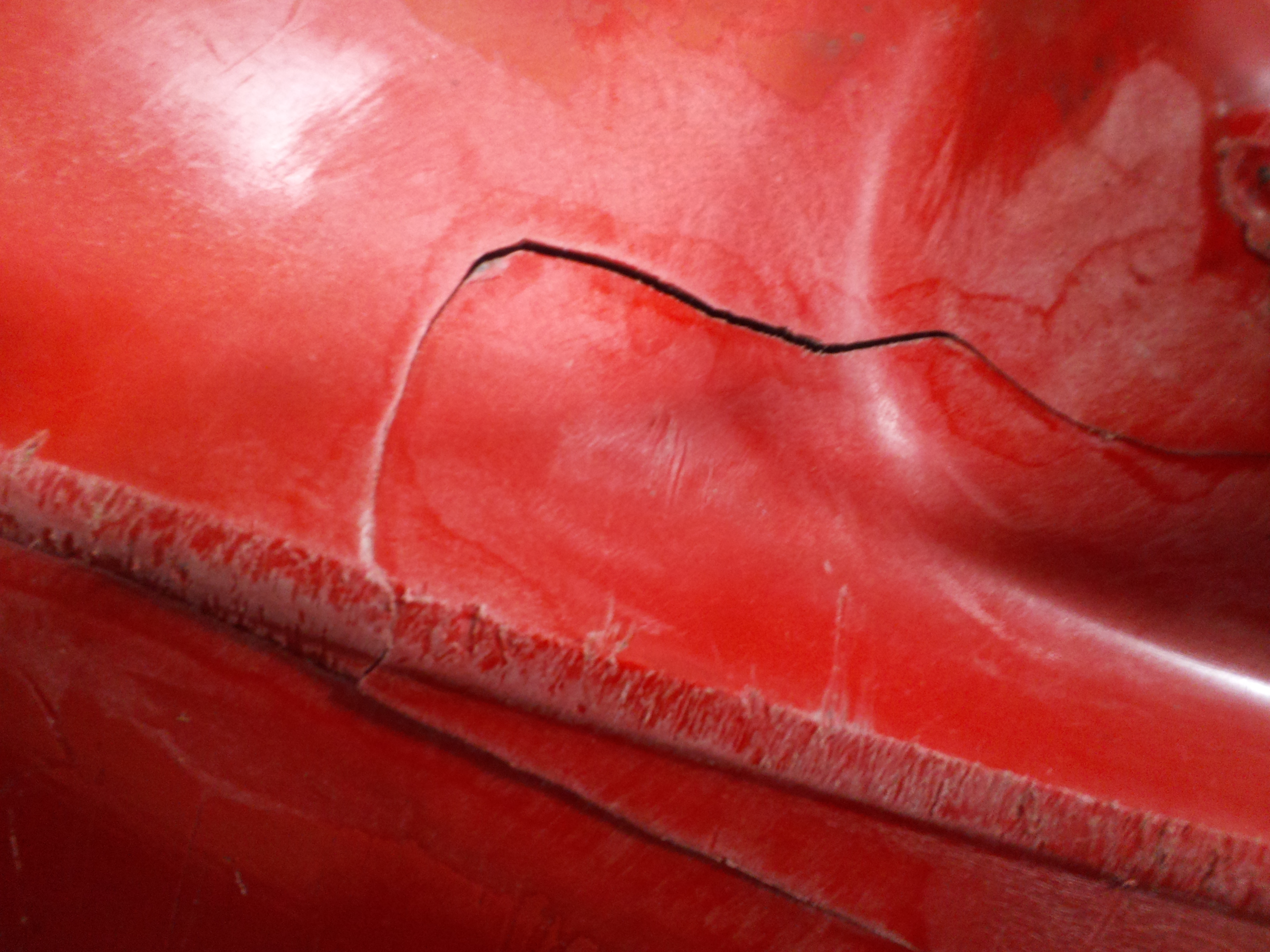

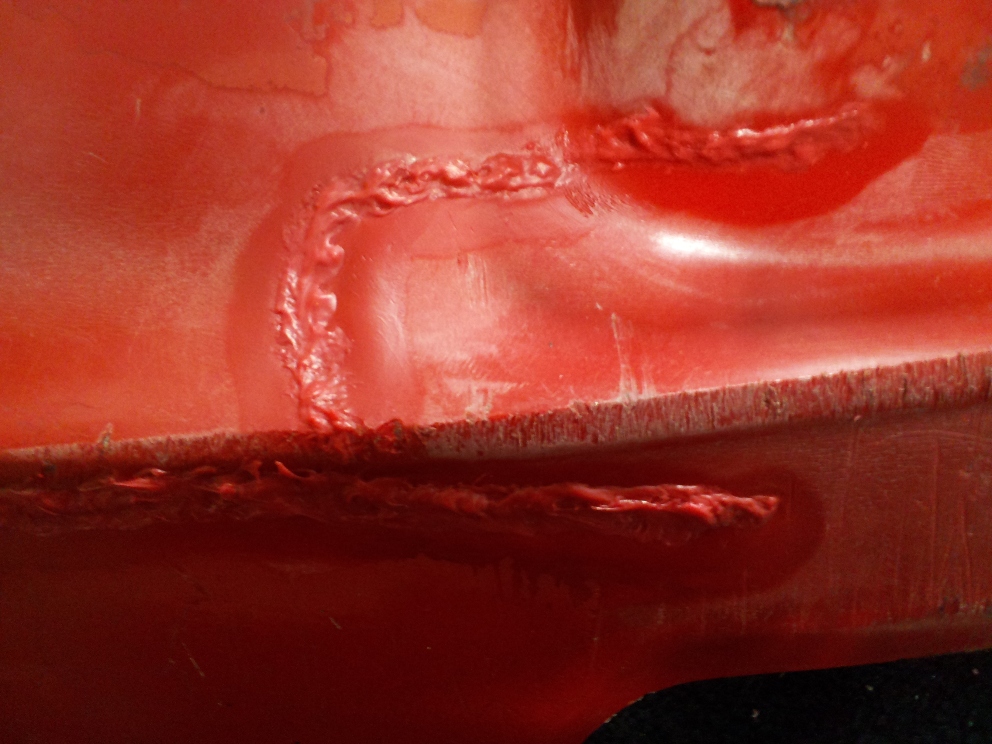

    I just did some welding on my ATC70 fenders thought I would share the before and after pics. I'm not going to sand and buff these they are in pretty rough shape lots of scratches. I just wanted to stop cracks from spreading. I will say cleaning and prepping the plastic is a must. I didn't clean them as much as I should have there was still some paint real close to the crack causing me to over heat them and it distorted a bit.

    Awesome job!
    I have a similar hot air rework station, i did a few plastic repairs with it as well before i bought a dedicated hot air welder, nothing wrong with it i just wanted something that i could take outside and not worry about beating it around.
    Its not hard to repair this plastic just time consuming.
    tri again - they all seem to be the same plastic from what i have done, they all bond good to the PE rods, i think the later models though they used a slightly different formula. It seems to dry out and get that crust on it faster from UV then others. I don't honestly know for sure. I had one shop tell me that with 84 and up they started seeing a lot more sun fading issues on trikes and quads, i'm guessing a formulation change but doubt we can ever prove that.

    Interesting it is a 85. I welded the top and bottom side. The bottom welded very nice and easy but the sun faded top was a lot different I needed more heat before the rods would melt into the fender.
