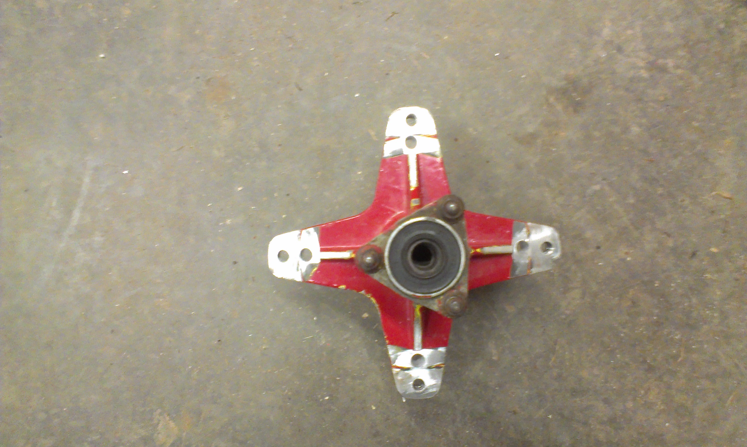

    Looking great! If you don't mind me asking, what is the rim you used on the front? I'd like to swap to a 10" front on my 200X.

    Quote Originally Posted by YTZ drew View Post
    Its a 10 inch rim with 2+3 offset with a 4x156 bolt pattern, ktm, polaris and yamaha sports quad have that bolt pattern. I had to modifie my front hub though, as you can see in the picture, I cut off the orginal holes, cant find a picture of the finished product lol but it ended up dead center!

    Sweet. I was thinking of doing the same thing, those wheels (4x156 2+3) can be had for $25 free shipping all over eBay, and I have an extra front hub.

    Very nice, Been wanting to do that for awhile. A side note though, to help others when doing this, I'm pretty sure you can just use the 200x intake & carb on the 230 head! That way you don't have to notch the frame.
