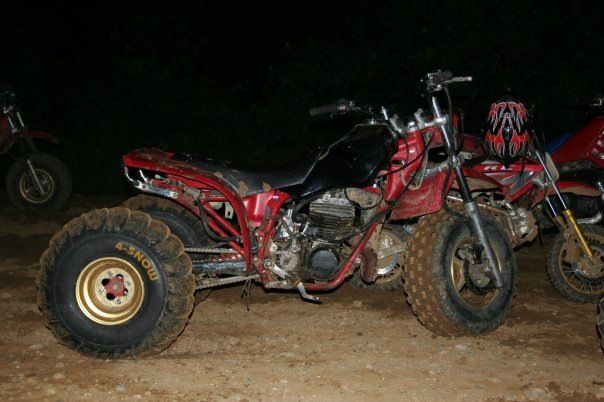

    Here's a shot of my 300r with Hartleys 4snows on it at tf2008 since we are posting 300's in here lol Hartley was awesome enough to let me borrow his mid drag race so I could race!
