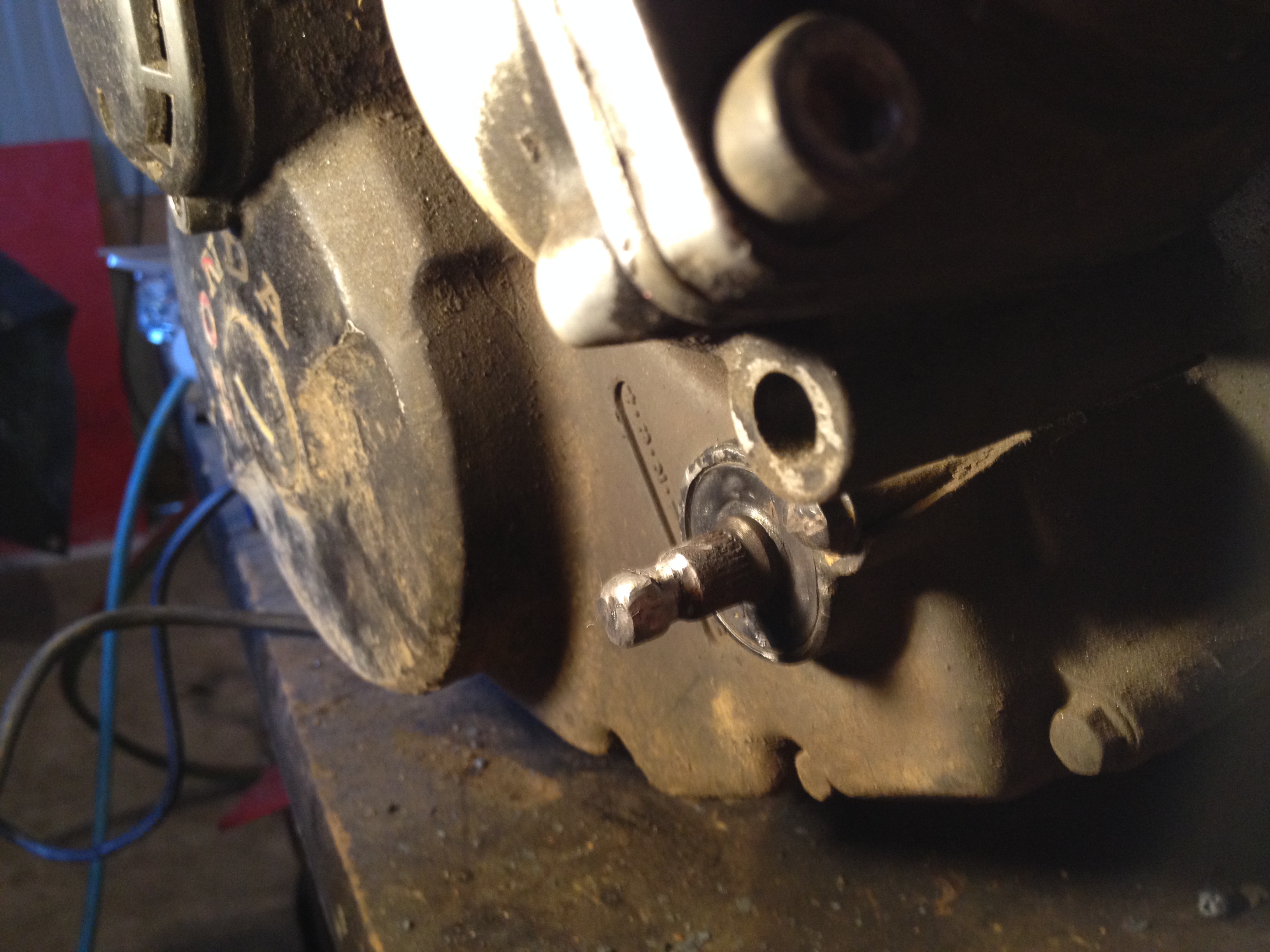

    I was looking over the engine and realized that the shifter was welded on, so after some careful cutting and some heat I managed to get it off. Hopefully I will be able to find a new shifter and be able to bolt it on. Any suggestions for shifters?
