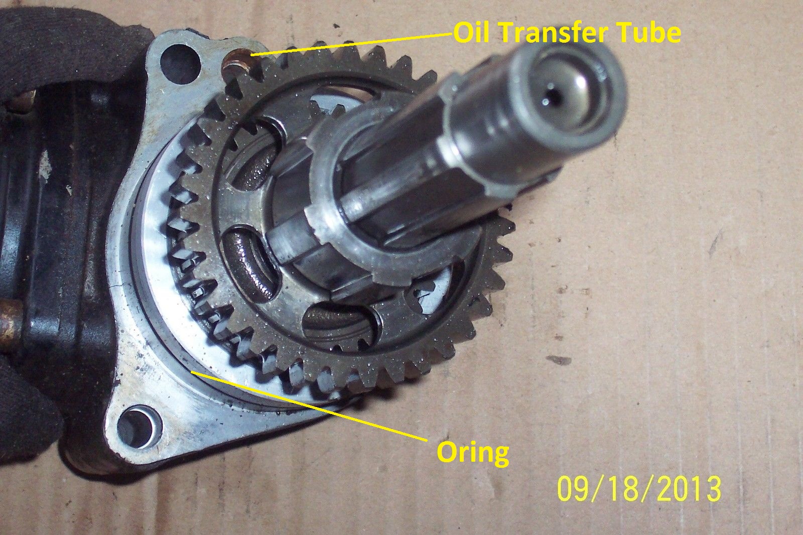

    On another note I cant get the 90* final gear drive to stop leaking oil. The 3 bolts were out when I got it, I read on here that those bolts shouldn't be removed?
  7. #37
    Jan 2011
    Choctaw, OK
    2,755
    Well you can take the bolts out but don't remove the side case gear assembly unless you are going to disassemble the tranny because the secondary shaft assembly is part of the tranny. The seal for the side case gear assembly is an oring. There is also a transfer boss tube with an oring on that. One of those two items is either defective or missing. It sounds like the entire engine needs to come apart.

    Thanks Jim for all your help, so it sounds like the engine has to come out to replace these o-rings? Other than these two problems (the oil leak, and the kick starter) its running great, It starts and runs good and all the gears are there.
    This is where the oil was leaking out of the worst.
Name:	Side Gear Case.jpg

    Ya, the tranny has to come apart to investigate the leak. No way around it.
