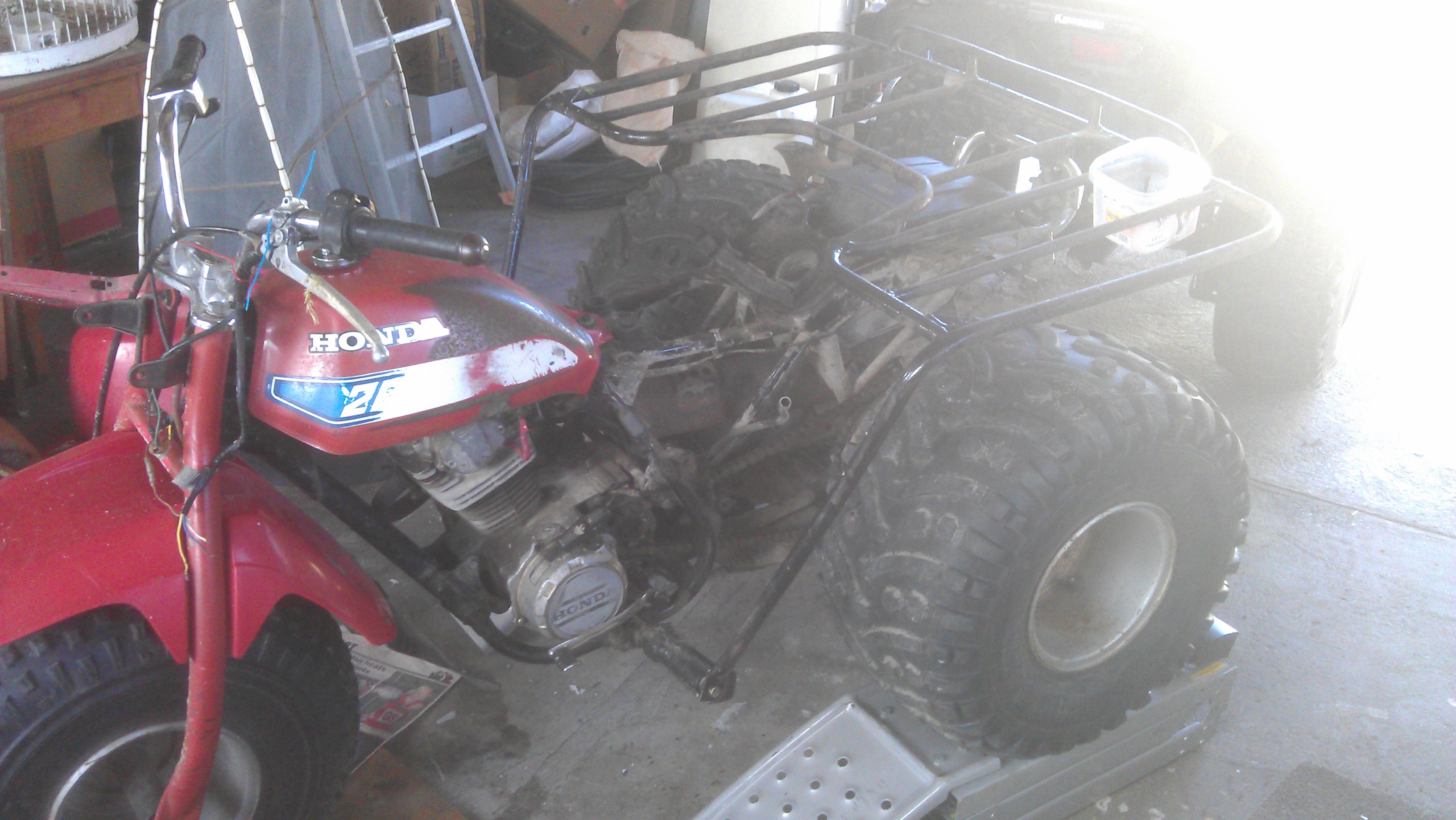

    bought a bike cheep and need a hand getting a few things sorted, its an old bike but the date has gone of the plate,

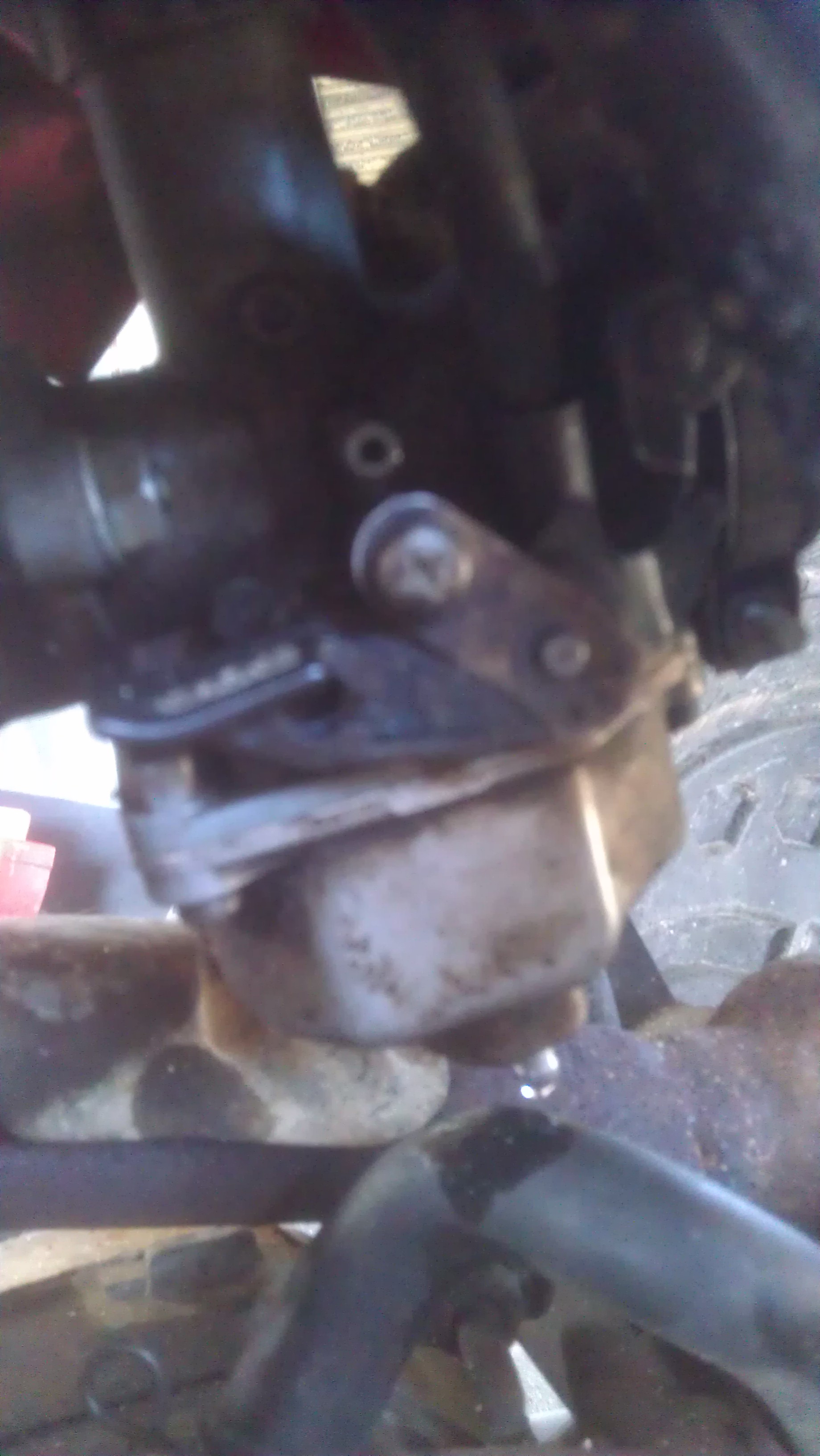

    it has sprung a couple of fuel hose leaks and i have taken some pics, pic 1 is of the choke and 2 points that leak fuel the bottom one had a hose off it which had perished but it didn't connect to any where? should it connect to the one above the choke?
    pic 2 is of the fuel/air filter box which has broken the hose connection point off the bottom the hose off the bottom also went to know where? is it a breather?
    pic3 is the bike
    i also need to work out the wire colours for front and rear lights as they had been disconected
    thanks heaps for any advice in advance

    Can anyone identify what year model this is?
    South Florida
    6,811
    1982 regular atc200 .
    If leaking out the bottom of the over flow / drain the float valve has issues , its either dirty , worn out or the float is out of adjustment .
