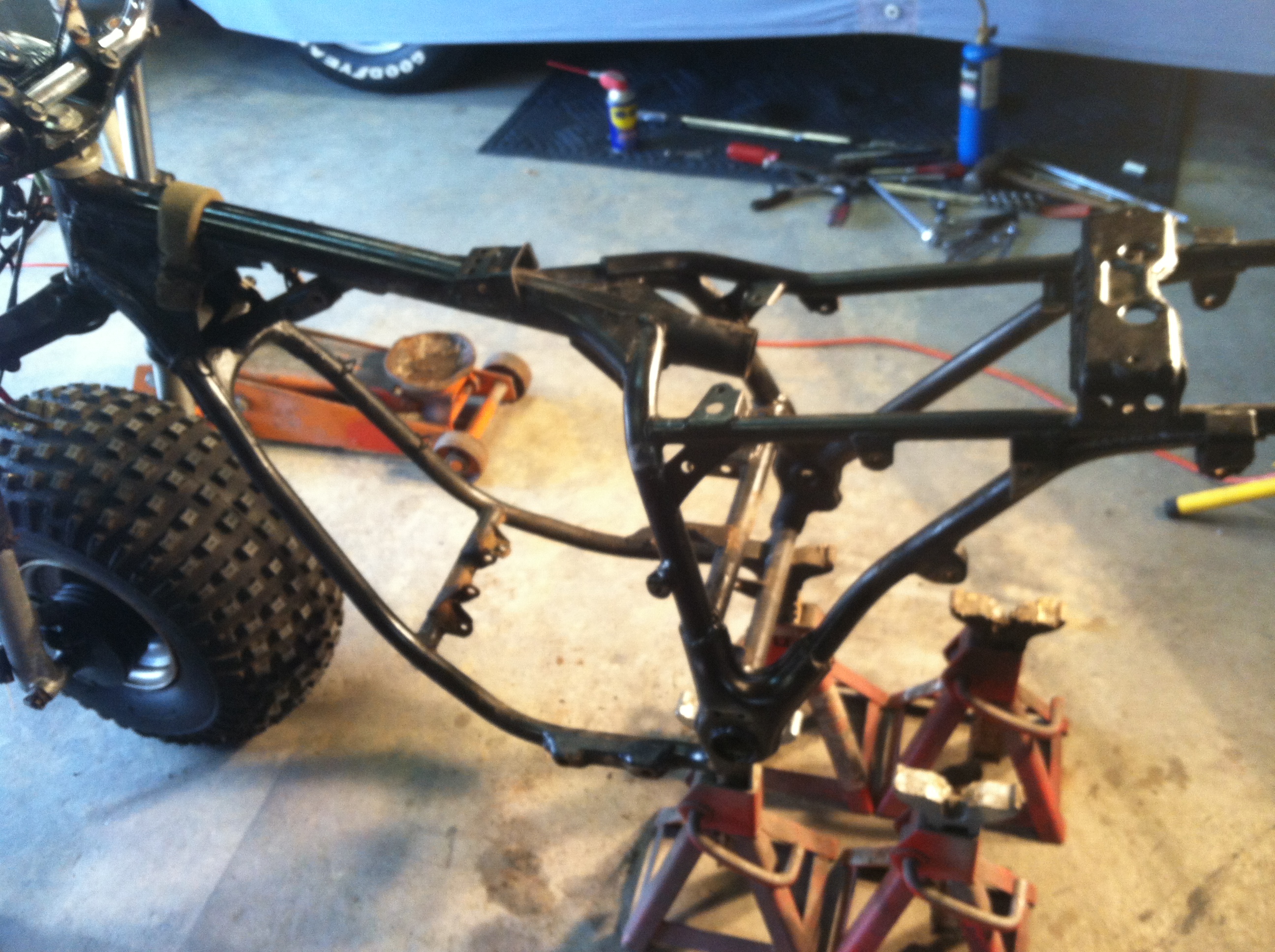

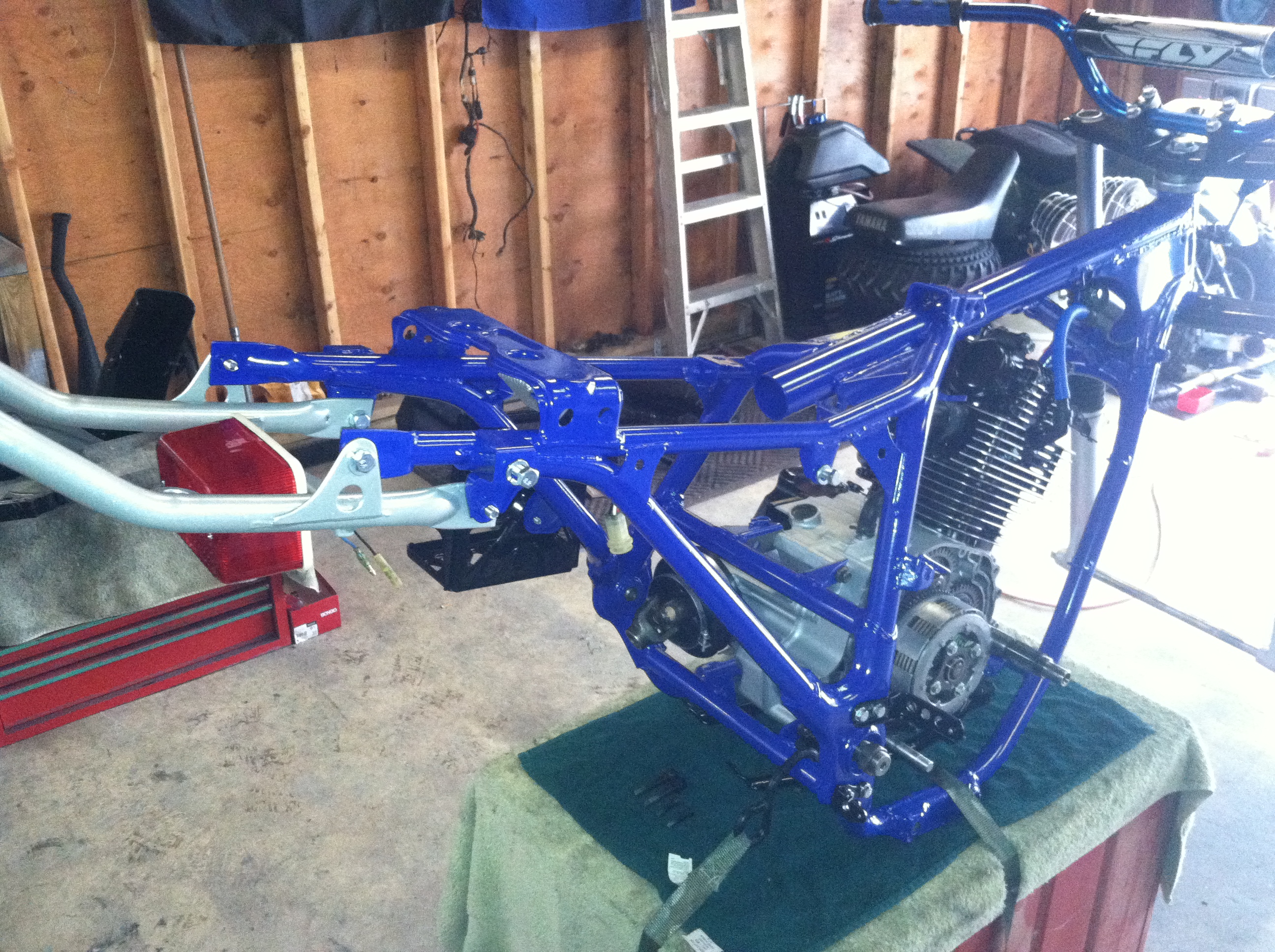

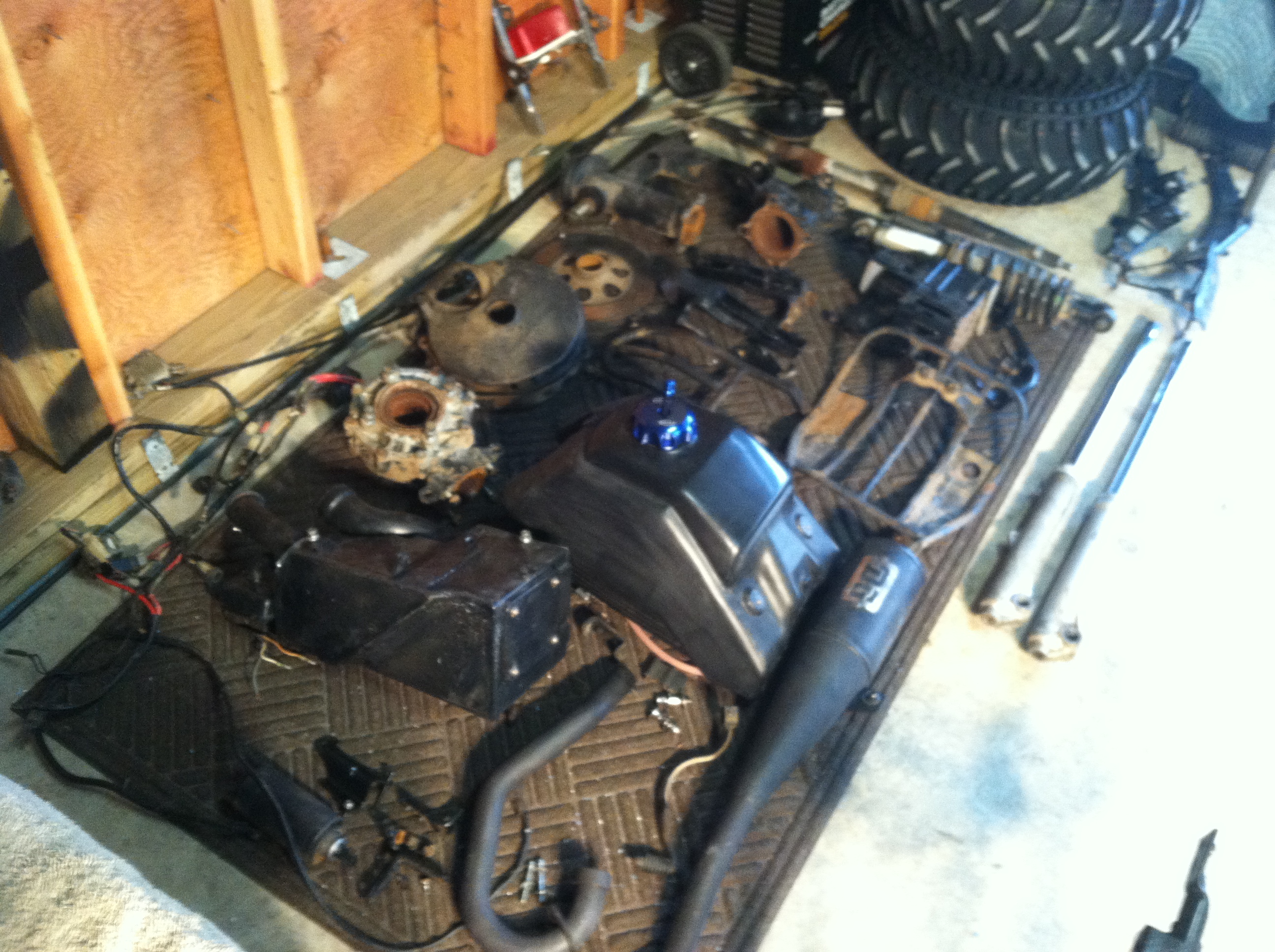

    hey guys, thought I would post some pics of my resto......should be finished this weekend !....complete teardown, TONS of NEW PARTS $$$$, everything cleaned , sandblasted, painted or powdercoated, all NEW...clutches, bushings, bearings, tires & wheels, cables, carb, brakes,....waaaaay too much to list,....designed and made my own graphics (I have a small graphics business).....was trying to achieve the look of a NEW TRIKE as if they were STILL being made, ......heres a few pics of my progress.......the first is the bike as it was when I bought it....just have to finish bolting down plastics, mount headlight, and bolt on clutch cover, then she's ready to fire
