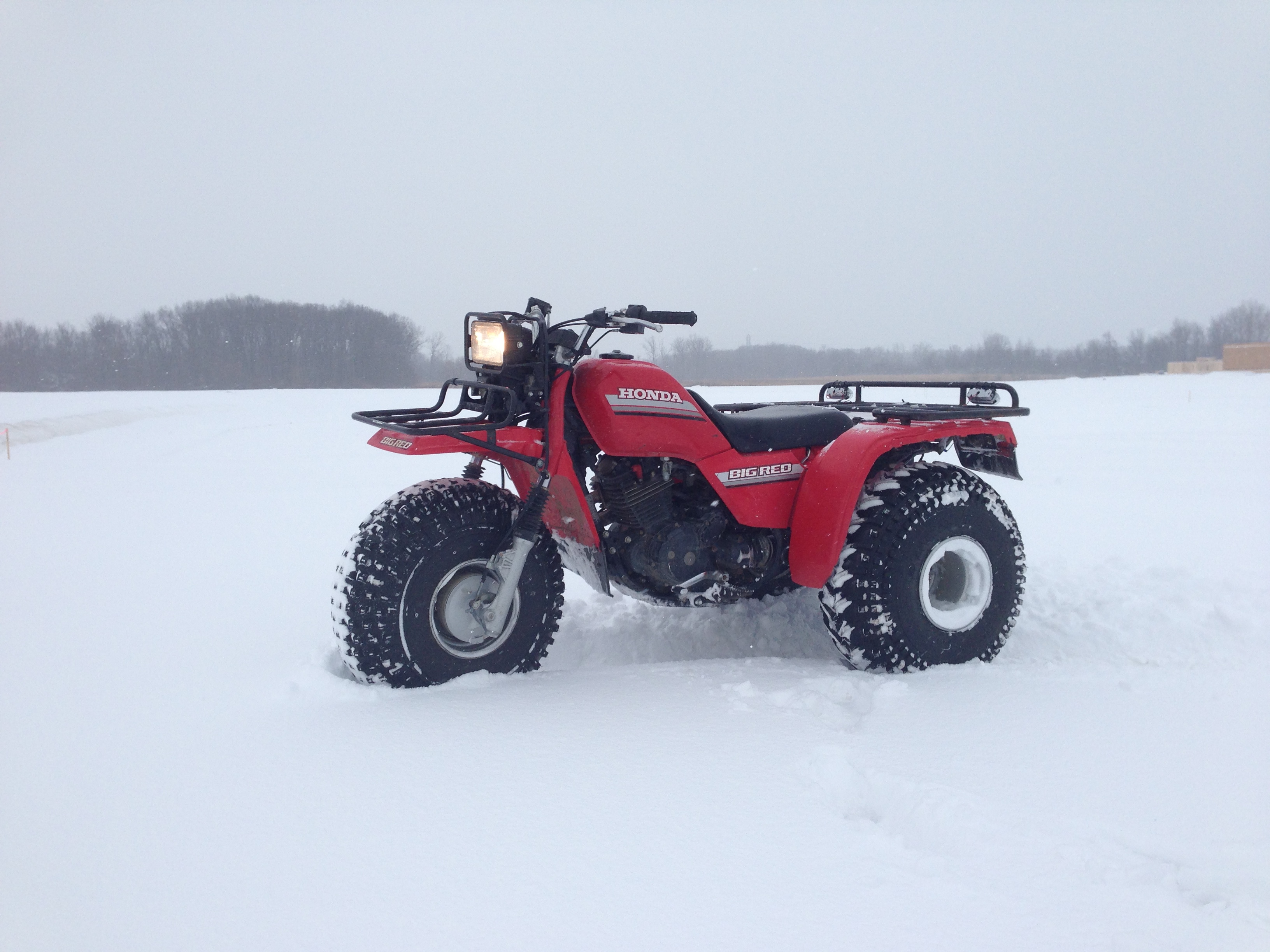

Name:	CWP 250es.JPG
    Quote Originally Posted by sinopz View Post
    Alright, thanks everyone for the replies!
    Also a 250sx engine fits flawlessly. I had an 85 and started getting a knock so went and bought a 250sx and swapped engines in a couple hours. The only difference (one that I like a lot) is the 250sx engine is black. I think it looks tough in the big red. just personal opinion though.
