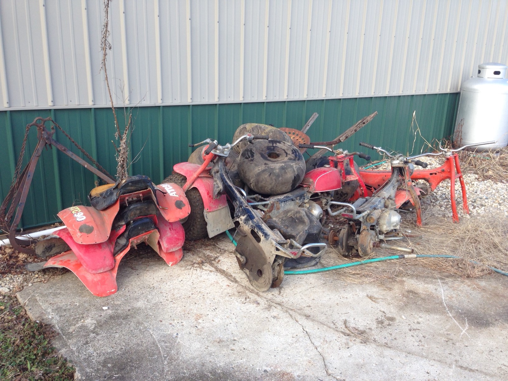

    Quote Originally Posted by ATC90JAY View Post
    Thanks KBonly I will seal it up and let you know if Im riding or still working~
    Hey I sent you a PM. If you need parts or have questions, feel free to contact me. Just picked all this up this weekend and have a couple 90s of my own.

    Quote Originally Posted by afdfirefighter View Post
ID:	183181Click image for larger version.
ID:	183182Click image for larger version.
ID:	183183Click image for larger version.
ID:	183184Click image for larger version.
    Wow what a haul!!! Looks like a lot of good parts in there.
