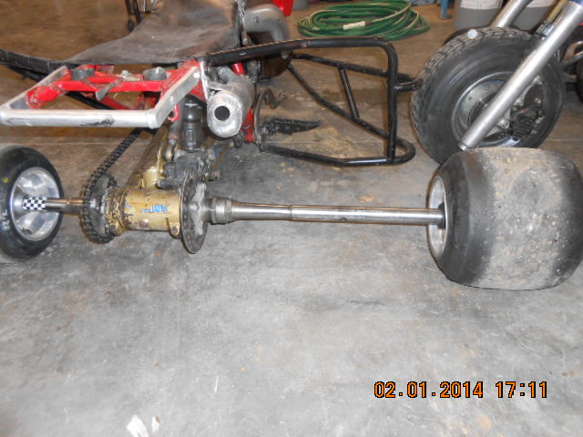

    The surface is sprayed with Coke syrup and when the racers are on it the rubber does stick and comes off so after bit the surface is Rubber So rubber on rubber, we are way hooked up. When on a dry slick track a set up is to move everything to the left. When on a Tacky track one might move everything to the rightClick image for larger version.
Name:	Axle photo's 010.JPG
ID:	185884. The width is about 50 inches , It is the position of the 50 inches that makes the difference between in control or out of control Then for some of us it doesn't matter because we are at the ragged edge and are usually on the side of that edge that is Out of control (OOC)

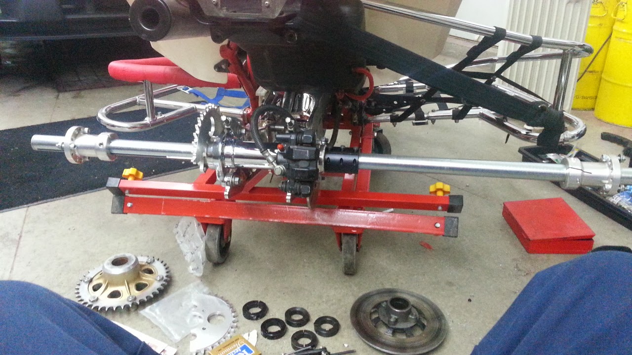

    I built a new axle set up seems to work great here's a picture. I used a 48 inch wide 4130 chrome moly 1\4 wall racing kart axle. Sprocket and sprocket hub from qrc karts. 7.75. Brake disc 4 bolt hub. Csb 206-20 bearings various different shims and had to modify the carrier assembly.Click image for larger version.

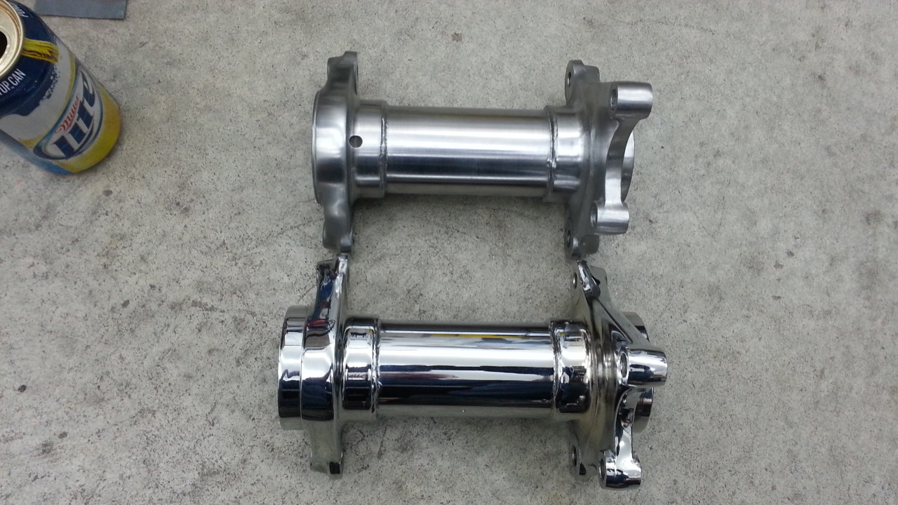

ID:	189713this is what I did to the carrier notice the holes drilled in it.
