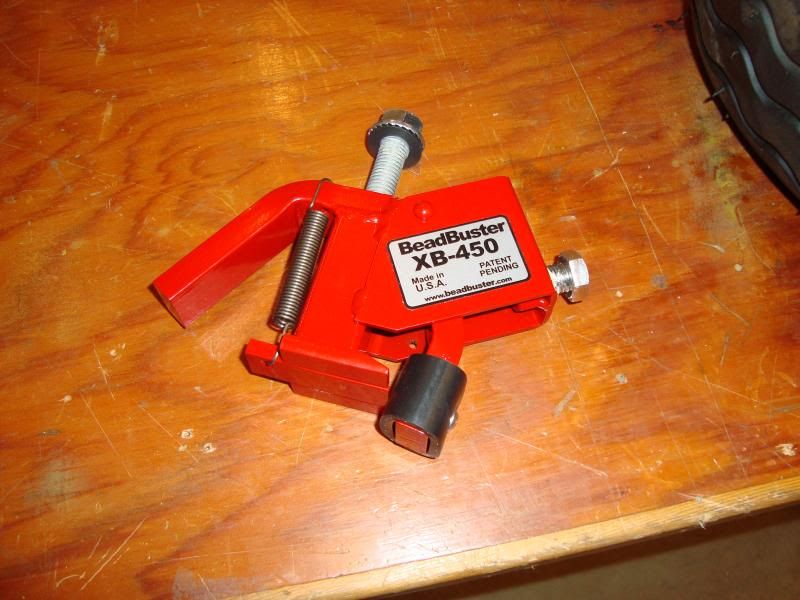

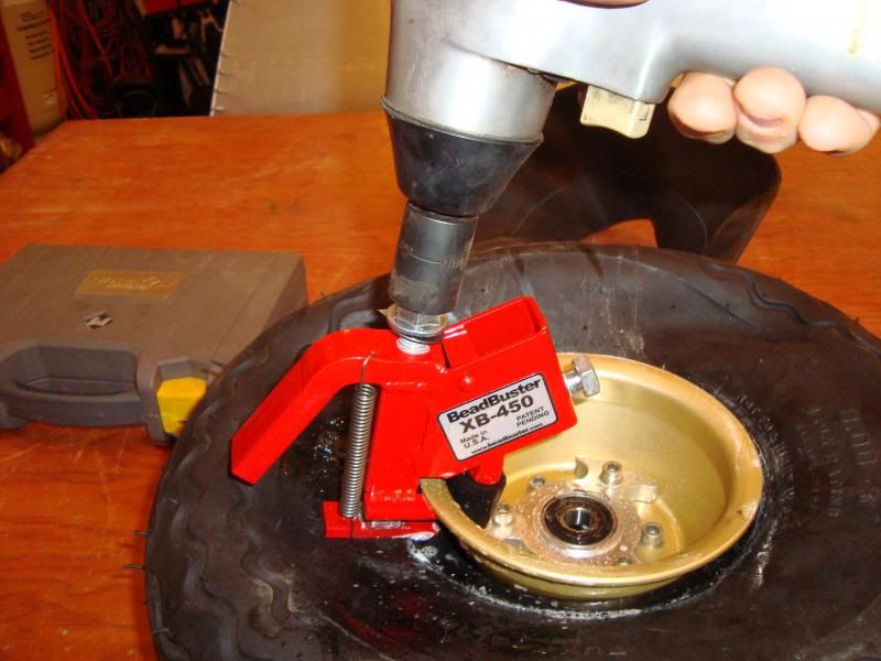

    Got this on e-bay for my airplane tires (also split rims), slick as snot... BEST....INVENTION...EVVVERRRRR!!!!! Works on any size tire as well...

    Quote Originally Posted by Taiser View Post
    OMG... I am going to get one of those for sure!!!! How much did it cost?
