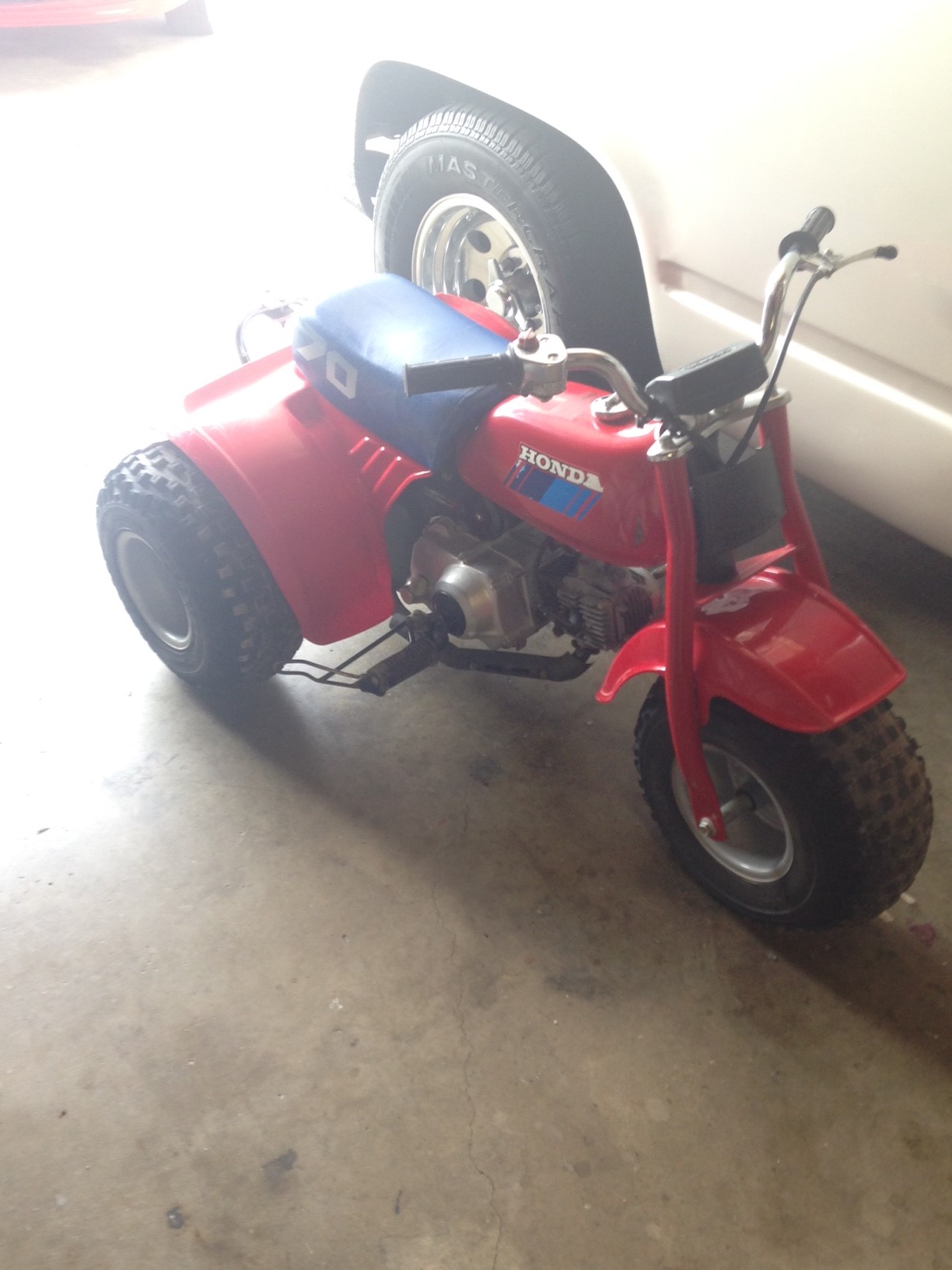

    Thanks for the replies. I did mess with the clutch adj a little and it didn't make difference. Oil is fresh, less than 5 hrs on the oil. Once I get up in 4th gear, it won't jump out. Shifting back down to N is a little bit of a challenge but if I work the shifter down and "help" it by rotating the round shift indicator back to N it will go. I'll tear into it this week. I remember a few years ago I replaced a little arm in there that had a roller tip on it if memory serves, I'm thinking that is the first place I need to check.
    Here is a quick pic of the little girl:

    Very cool. Nice looking little trike.
