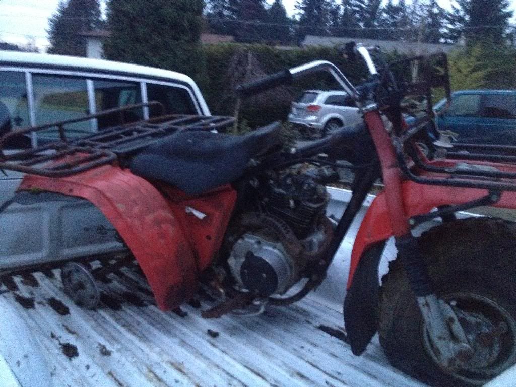

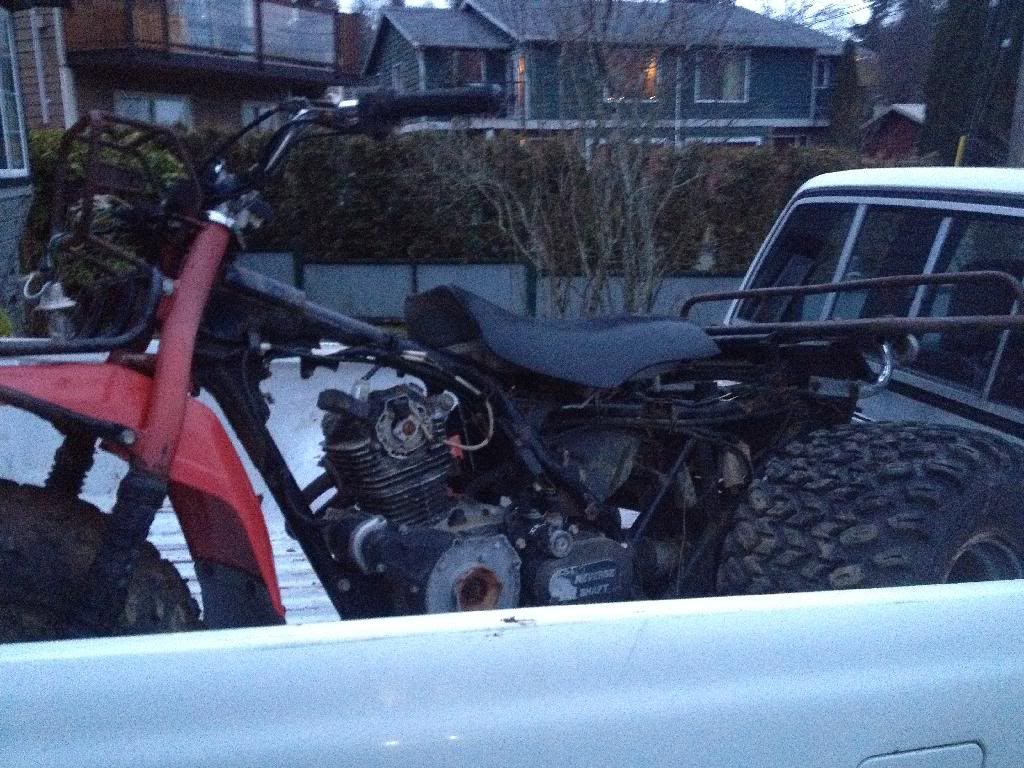

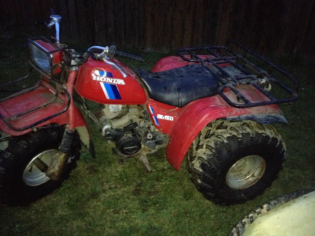

    Well as posted in this thread http://www.3wheelerworld.com/showthr...64142-ATC-185s I picked up a couple new to me trikes. One complete one parts
    And here's the parts one
