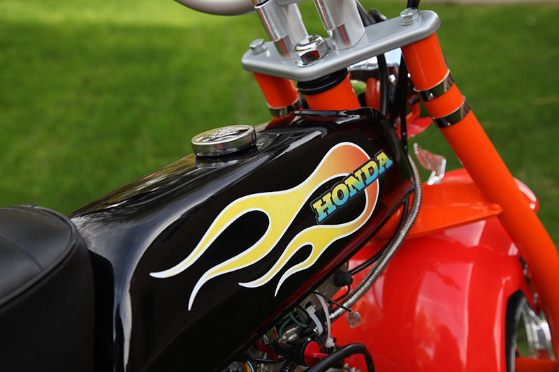

    Yes I have an original tank as I had said. Put a lot of $ into that tank. To my frustration the gas cap doesn't seal as the lip is uneven. Sure wish I noticed that first. Been experimenting with liquid steel. It's getting better, not done yet.
    I went with chrome, one piece rims. Matching the Daytona Orange for the 73 was not exact. This was as close as we got and in the pic. you can see it is not an exact match to the new fenders.
    New exhaust system, risers and fat bars. I was really lucky to find that head light.

    Hear is pretty much the finished product. Still need to re-chrome the grab bar after grinding a bit more. AND the fuel cap problem, which is turning out to be a big problem. The liquid steel isn't going to be the answer. I am going to post some pics of the opening of the tank for anyone's advise on what to try.

    Here are some pics of the opening where I can't get a new fuel cap with new gasket to seal up. Please anyone who has run into this with a successful fix let me know some feedback. Looking at these pics I think I am seeing the top of the tank pressed in which could be the problem or part of the problem??

    My suggestion for the fuel cap issue is to get a new tank, or a newer style cap that has a nipple on it for a short piece of fuel hose with a vent on the end of it.

    MNhondaguy_ what about that cap do you think it will work? I really hate the idea of getting another tank. that year are hard to find, and I have a bit of cash tied up in this one already

    Try this cap... It is the oem replacement from Honda.
